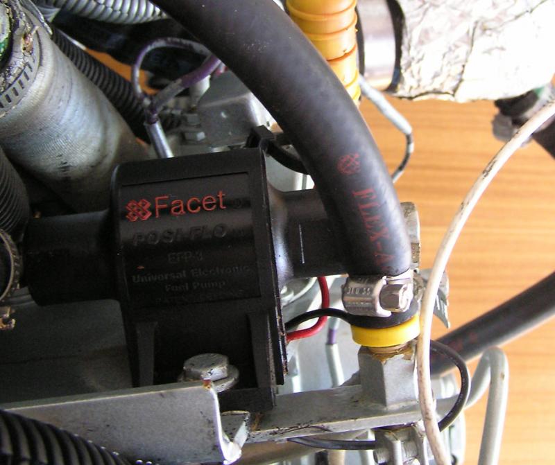

Paulj - were you able to use the stock mounting points/brackets when you installed the facet/purolator pump or did you have to drill new holes? Also, was it any easy hookup for the fuel lines and wires?
I contacted a local marine mechanice and he is 2 weeks out. I might have a go at replacing the pump myself. I did some digging and found an OEM style cube pump from Westerbreke but it was $196...
iSailor
In 2006 I replaced my fuel pump with the one Stu mentions here.
No problems what so ever.......$35 at EFP 3 at Napa parts.
http://c34.org/bbs/index.php?action=printpage;topic=2515.0

I'm going down to the boat this morning and change the engine oil and I will take some detailed pictures........
