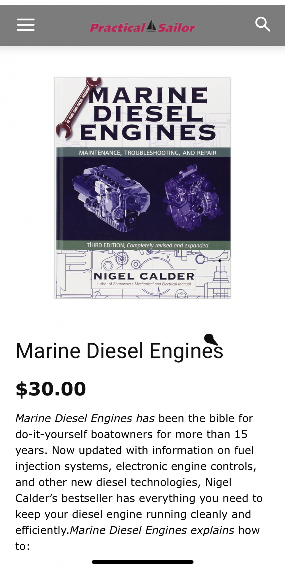

Ran engine for close to an hour and no issues. Was thinking about getting this book to help supplement my diesel knowledge. Anyone know of a better book?

Sure, do you have the owners, operating and maintenance manuals that are specific to your motor?

Yes - I have all of those in a binder that I keep on board. I was wondering if a book like this could put all of the stuff that I need to be focused on in more laymen’s terms.
