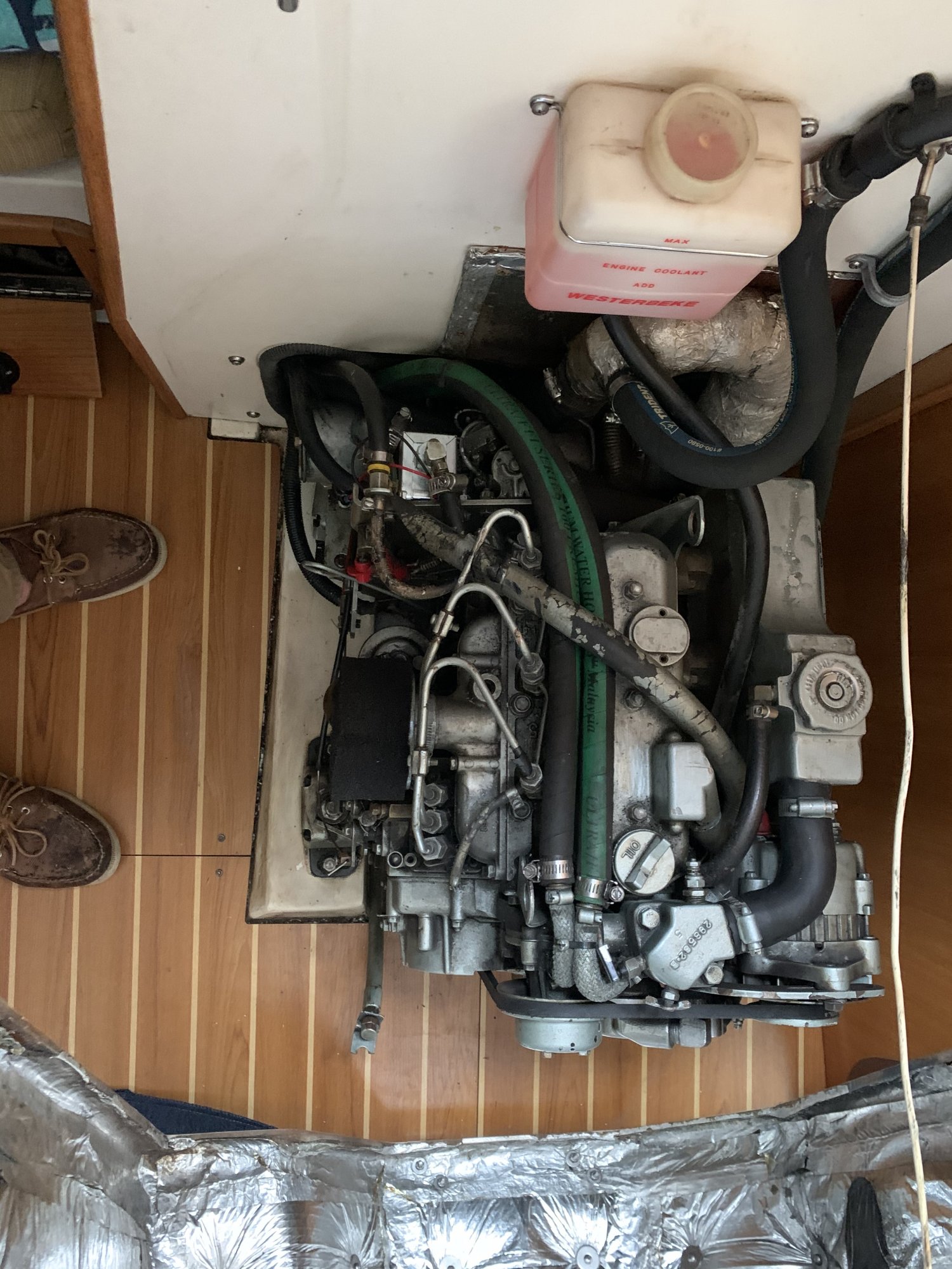

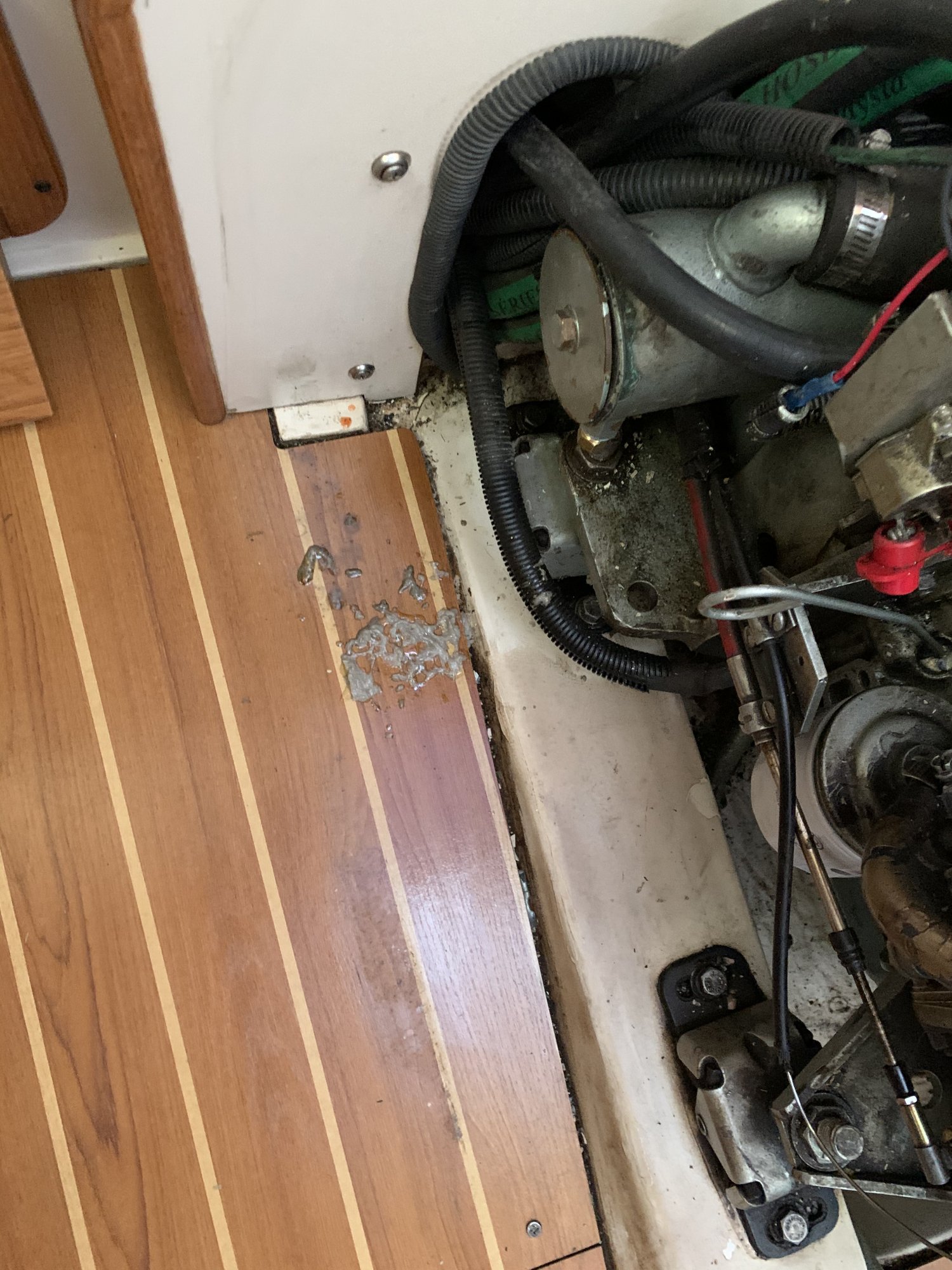

I noticed the discharge in the photo the other day. I had seen something similar a few weeks back after I had my fuel lift pump replaced, but thought it was something left behind by mechanic. (He left an absorbent pad in tray under engine). I just messaged him and he has no idea and says cannot be part of his repair work. The discharge is somewhat gelatinous and has that odd silver color. Greatly appreciate any thoughts.

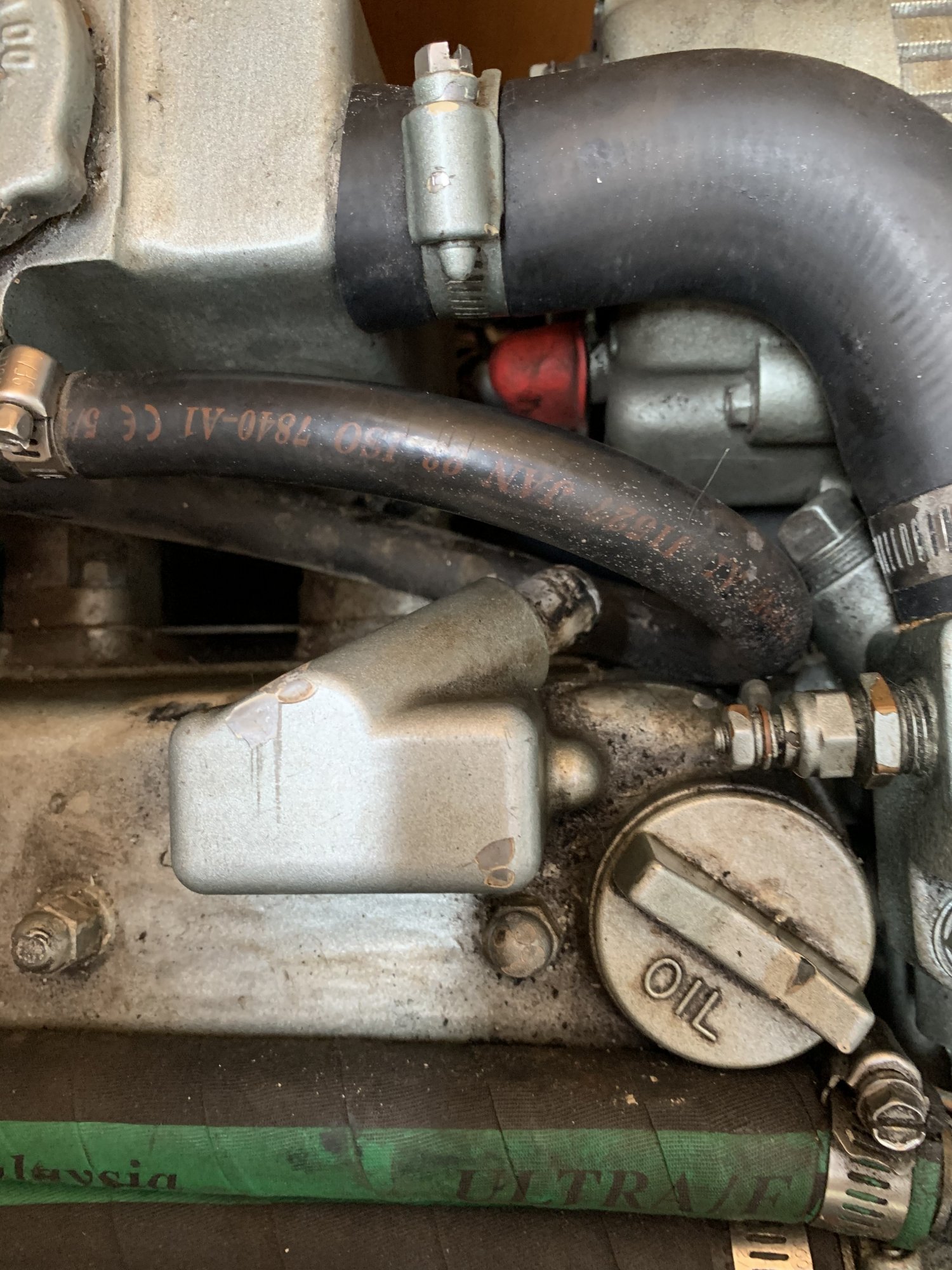

I'm not sure if you checked the underside of the stairs, as JRT and I suggested. In any case, I see a drop of the goo on the cable run or hose next to the blob. This would indicate the goo came from above. The breather hose from the top of the engine runs to the spark arrester (air filter), and might be hanging down, away from the air inlet to the engine. Oil and moisture could collect in the hose, and expel as a blob if not continuously cleared by the engine, especially if the boat sat for a while unused.

Tom J / JRT - the entire engine cover was clean - no goop anywhere. Regarding the breather hose is this the hose that comes off the top of the engine? Mine is not connected on the other end and has a diagonal cut across it. I checked the inside of this hose last night, as I had a small amount of the goop expelled in the same area. The hose was dry and didn’t have any sign of the goop. Any next steps / thoughts are appreciated.

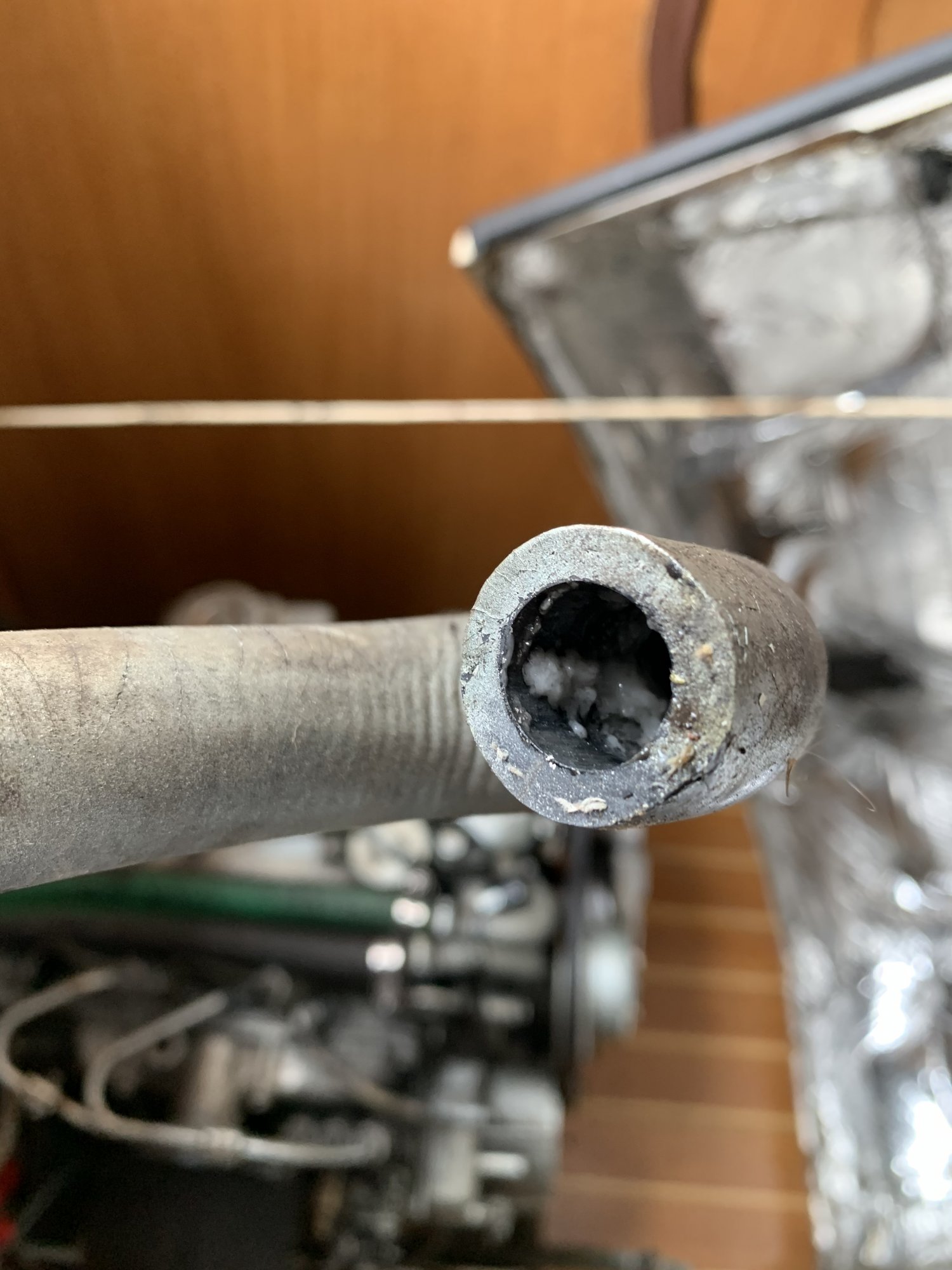

JRT / Tom J - checked the inside of the engine cover / steps and it’s in good shape - nothing that could create the goop. I took of the breather hose and found the goo inside near the outlet. See photo - appreciate any thoughts.
Maybe take the hose off and flush it out, reinstall it and make sure the open end is near the spark arrester (air cleaner). During normal operation of the engine, pressure builds up in the crankcase from blow by and this pressure is released through the breather hose. Vapors from the hot oil are expelled through the hose and sucked into the engine intake to be burned with the fuel/air mixture.
On your engine, it appears this process is not happening, and the oil vapors are mixing with ambient moisture to form a plug that gets expelled when the crankcase pressure builds up. If there is a low spot in the hose between the engine and the open end of the hose, the oil vapors will condense and form a puddle, leading to a plug.
This all assumes that the oil you see on the dipstick is clear, and not milky looking. That would be a whole different can of worms.

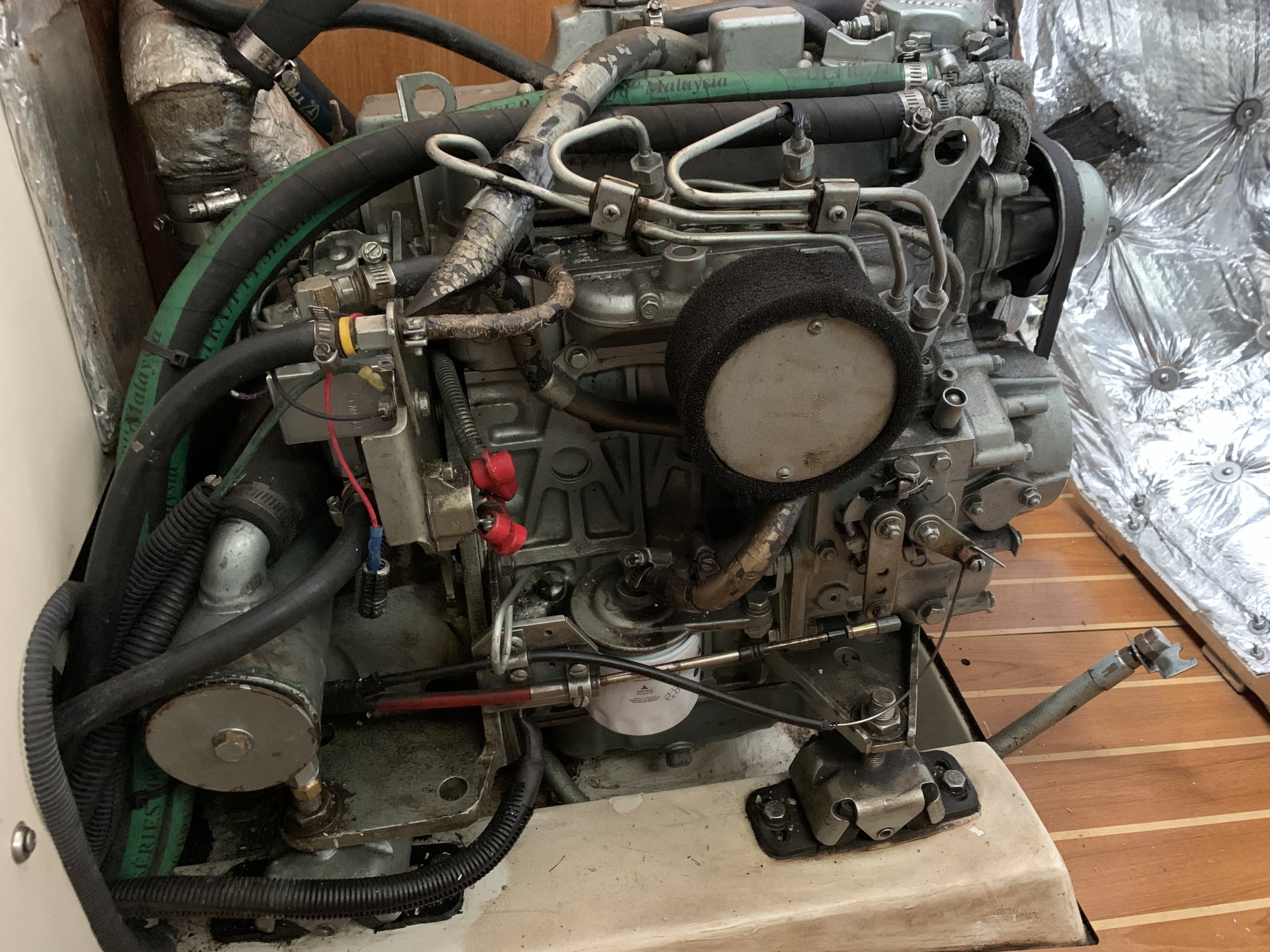

Thanks Tom. I cleaned out the hose earlier today and replaced it in same area. See attached photo - is this the correct location? I’ll be down at the boat tomorrow and will recheck the oil - just changed at start of the season.
I think I see the problem. The open end of the hose is about a foot away from the spark arrester. It should be touching the foam around the spark arrester so that the fumes are sucked into the engine.
