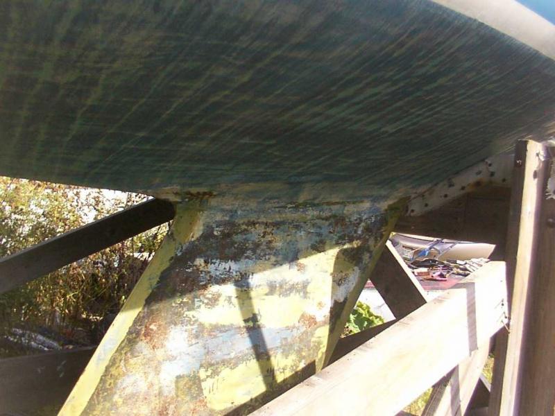

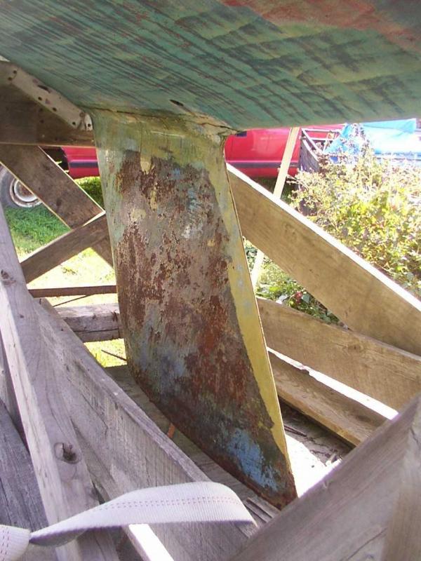

Well, as I say....... I suspected that the YNGLING keel might be different from the other O'DAYs with keels, but it was the best I could come up with, and is pretty much typical for other builders at that time. However, I really don't know enough about the YNGLING to remember how the keel was installed. I think the new ones have the keel molded as part of the hull?? I just looked at some pictures that I have of a 1975 YNGLING (didn't realize O'DAY was still building them that year) and the keel definitely appears to be cast-iron and bolted-on. Problem is that none of the pics show any bolts, maybe they thread into the keel rather than being inserted from below as on hte Javelin and Mariner/Rhodes 19? I think I'd still suggest contacting either the Class Association with htis question, or maybe the current builder. Unfortunately, there are not many YNGLING owners here, you might be one of only 2 (or less).

OH ,and after looking at the pics that I found..... I take back my mention of the O'DAY built boats having a different keel shape from the newer boats, it is the same as far as I can tell.
