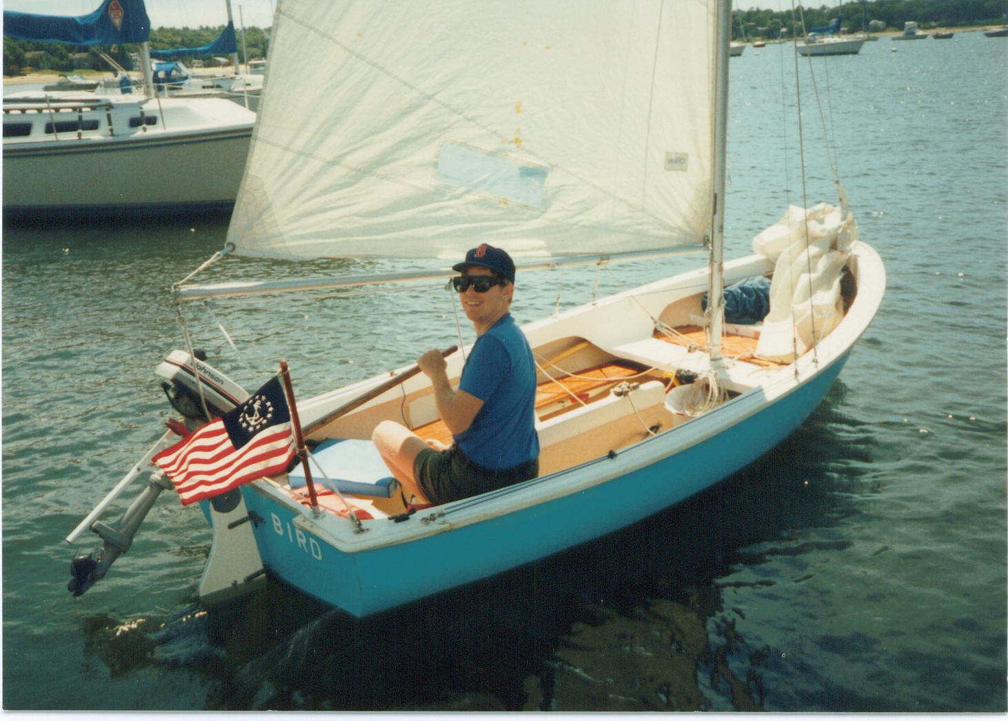

Sorry, forgot to warn you about getting me talking about my little gem! I've added a pic from my second Summer with my Widgeon, this was back in 1989, she was my little "yacht"!
