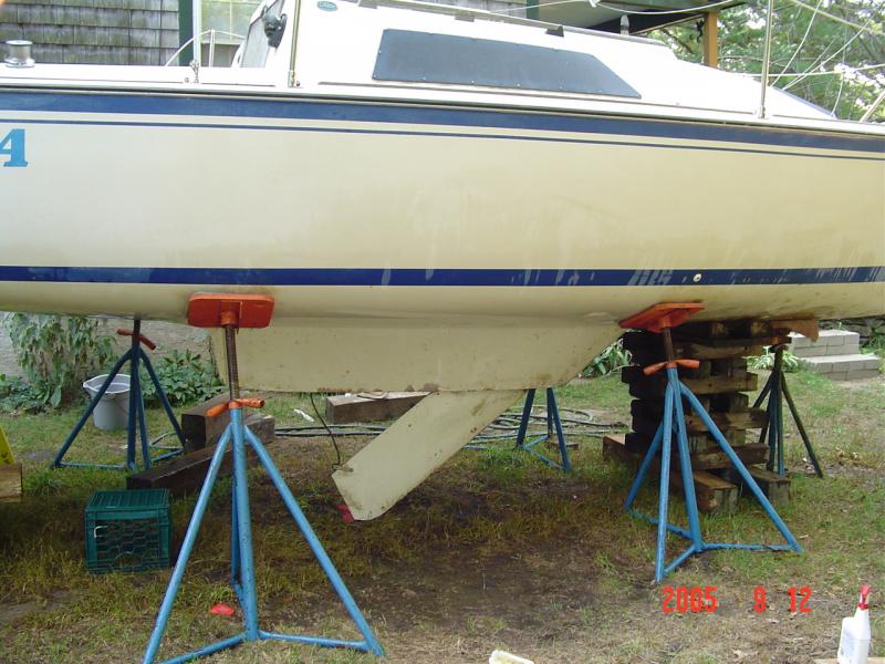

The keel on your O'Day 23 weighs 1250 lbs. You're not going to tip it over that easy. You just won't be able to point up as high and go to weather without the board down. Also, if you're on a run in excess wind and wave conditions, you're boat will have a tendency to yaw more without the centerboard down.

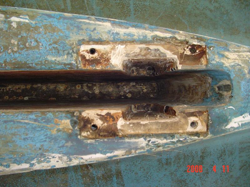

You need to check the under side of your keel to find out what is missing besides the centerboard. There should be two stainless steel plates, four 1/4" Phillips head bolts, two wood screws, and a fiber centerboard pivot pin. Outside of that, you need the centerboard braid pendant line with the shackle. Rudy at D&R Marine carries all this stuff.
http://www.drmarine.com/
Email me at sailtrinkka1986@verizon.net and I'll send you some pictures of this stuff and how it's configured in the keel slot.

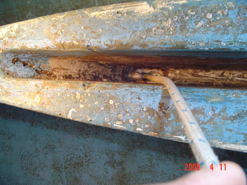

I have a '79 Oday 23' as well. My centerboard is stuck inside the keel cavity. I have been sailing it with the centerboard up, and Yes, she definetly slips to leeward. I keep saying to myself, "Can't wait to get this centerboard fixed!" (I sail on a very narrow lake, and have to tack very often) I have heard that the attachment pins to the line sieze up, and get caught inside. Joe, I think I am going to ask you for pictures of you 222. Probably the repair job for my boat would be easy - the hard part would be getting to it! I am not to crazy about blocking up my boat in my yard, and crawling underneath there. Probably will just pay a boat yard to lift it up and fix it.

That would probably be the safest way to do it. I'm assuming that the later model O'Day 23 is set up similar to my O'Day 222 with the exception of the single sheave for the pendant line to ride through. Your boat doesn't have this as far as I know. The O'Day 26 does though.

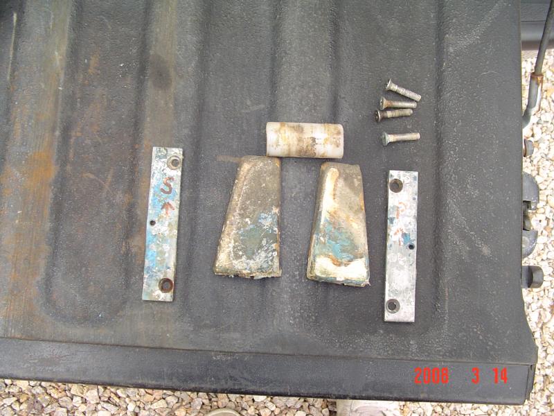

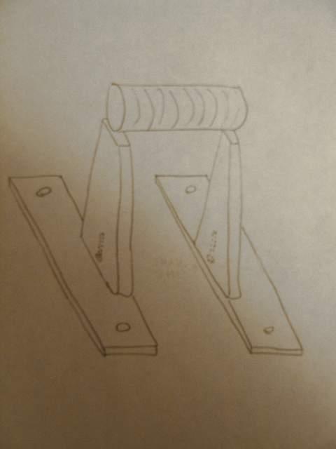

The fifth pic shows the slots where the wedges fit in place. The centerboard pivots on that round fiber pin and the wedges are held in place with a regular polysulfide adhesive caulking. 3-M 4200 would work for this.

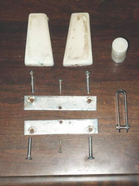

The sixth pic shows a rough sketch of how the wedges support the fiber pin. The plates are bolted to the keel against the wedges a screw holds the wedge in place until the caulking sets up.
They need to be careful when removing the four 1/4" Phillips head bolts. Probably the best tool for removing these bolts is good impact cordless drill with a Phillips bit in the chuck.
There's a bronze plate embedded in the lead on both sides of the slot according to what I've been told by Rudy of D&R Marine. If you should break a bolt you could re drill and tap for threads if you had to. I just took my time and removed the two stubborn bolts that were giving me trouble. I used an impact tool with a hammer, but I think a good cordless Makita with a bit in the chuck is the way to go.
To remove these wedges I used my fish fillet knife to cut the caulking. I heated the blade with a torch and worked it through the caulking. Then I used a putty knife with the blade heated.
If you damage the wedges you could reconstruct them with fiberglass.

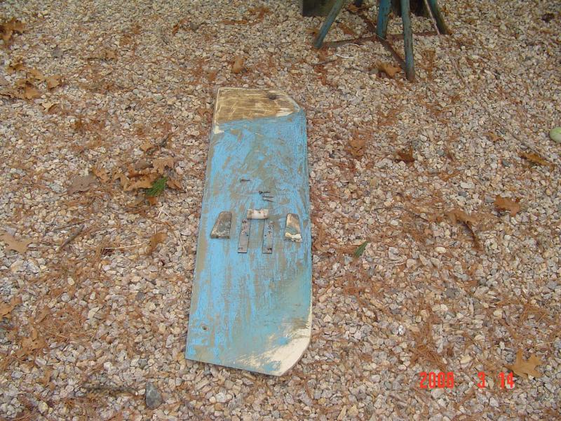

Once the plates and wedges are removed and the slots are cleaned of all caulking, the board and pin will slide right down out of the slot.
The board is probably about 12" wide. The bottom of the keel needs to be about 18" off the ground. Good luck!

Joe, thanks for the pics. Actually, what I was able to do was to get a stiff piece of metal, about 4 feet long and 1/4 inch wide, and stick it down the tube where the line went. It actually made it with a few inches to spare, and wouldn't you know it, I pushed and the keel swung downward! It seems that the board is a bit warped, and when you tighten it, it gets wedged into position. So now I know what to do after I take her off the trialer! When I am at the dock in the summer, I just won't pull the board up all the way!

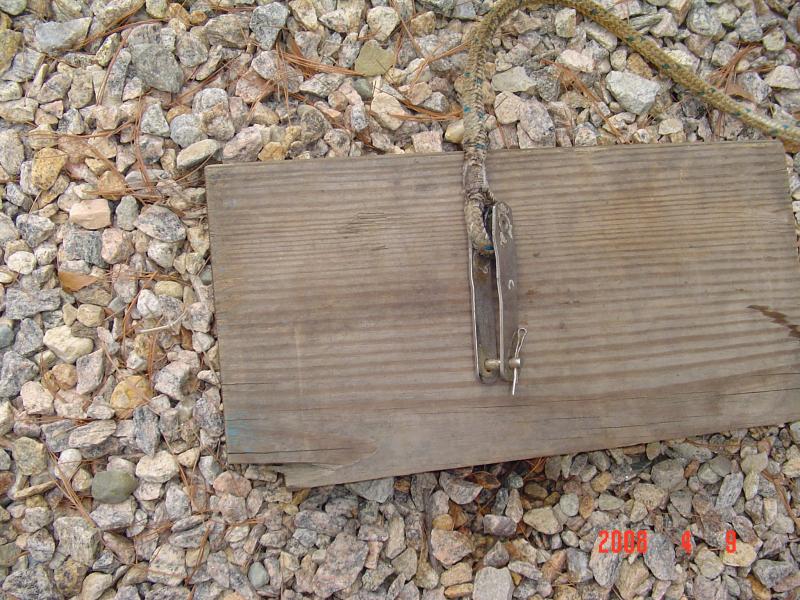

I think that what I would do is get the boat off the trailer and remove the board. You may be able to do something to correct that problem. You could even build a new centerboard out of plywood and fiberglass. A guy in Providence RI had to do this to his 1973 O'Day 23 several years ago. The boat had some serious keel issues and he wound up breaking the board in half trying to get it out. You could always buy a new centerboard. They're big bucks but the boat is worth it. Rudy at D&R Marine has them in stock or can get them. http://www.drmarine.com/
I don't think it comes predrilled for the pin though. You would need to drill the hole yourself.
You may be able to do something with your centerboard though.
