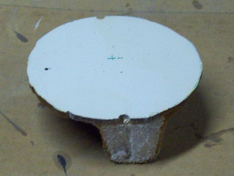

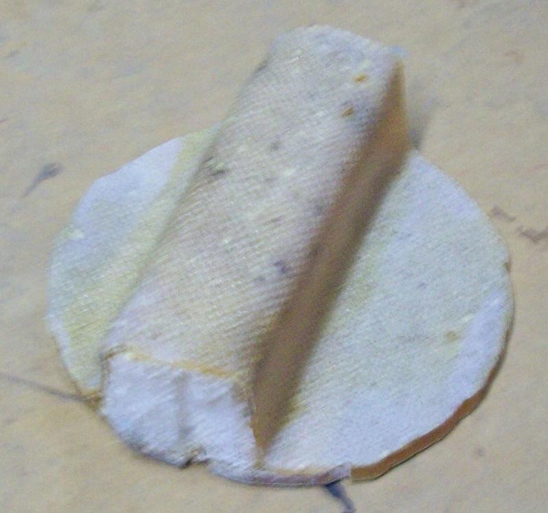

Well, it sounds like O'DAY was still building the cockpit sole in 1984 the same as 1979! I remember that the first Winter after I bought my DS II, I thought the cockpit sole seemed a a little "springy" aft of the CB trunk, so I decided to try to inspect the core for delamination. I cut out a 4" hole to install an inspection port about 6-12" aft of the CB trunk. What I found was that the was no core, just a fiberglass panel about 1/8" thick that was supported by a glassed-in foam "beam" (the fiberglass actually provides the strength, the foam is just to give the glass shape as it cures. WOOPS! What do I do now?? I just cut through the support for the deck!
OK, don't panic! What I did was to cut 2 pieces of marine plywood (about 3/8" thick +/-) to fit around the hole and then secured the deck plate (inspection port) to the cockpit sole using bolts through those plywood pieces. I also bolted through the 2 ends of the fiberglass beam. I wish I had a picture of this, but could try to take a few pics next weekend when I am aboard my boat. I did use a good marine sealant between the deck plate frame and the cockpit sole to avoid leaks. Below are 2 pics of the piece that I cut out, that was 19 years ago, cockpit sole is still as solid as it was before I "severed" that beam..... so don't worry, just splint the gap like I did.

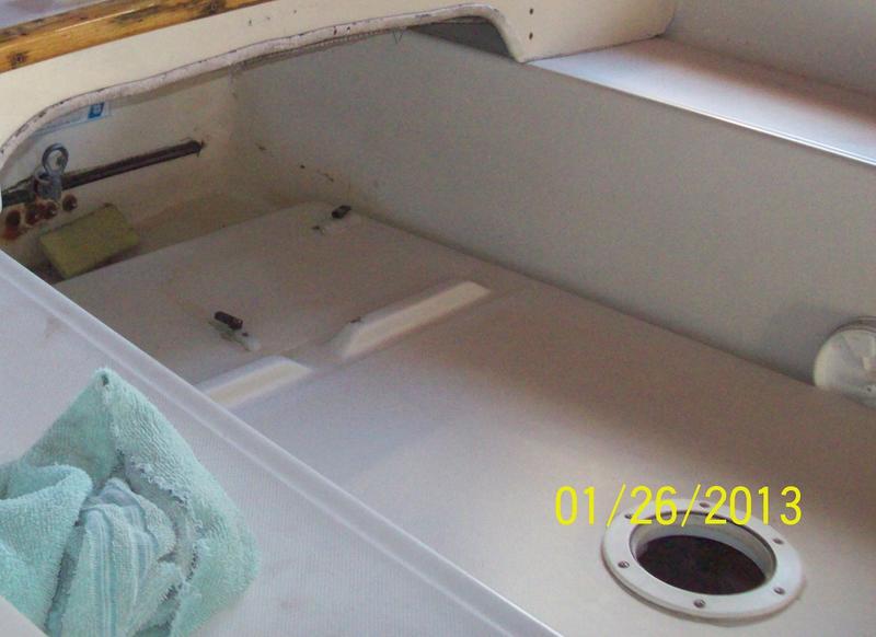

I found a pic showing the location of my cut-out, still searching for a pic of the underside (I have had too much fun sticking my digital camera into nooks and crannies of my boat!) Also note that I added a small deck across the aft end of the cockpit, not to confuse any other DS II owners who look at this photo.

Thanks Sunbird22358. That cutout looks exactly like mine, but I did it farther aft, behind the small border showing on your cockpit sole picture. Glad all is not lost!
