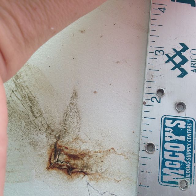

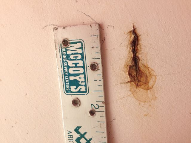

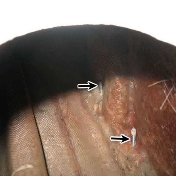

We just purchased an ODay SDII and did not notice until we brought the boat home (inexperienced boat owners!) that it had two small leaking cracks under the hull the size of a little over a foot and 1/2 from the transom. They have been leaking a little even after a few days. I lifted the trailer front so the inclination was greater towards the back of the sailboat.
Could I just patch these cracks with epoxy like Six-10 or MarineTex or should I do a more extensive repair?

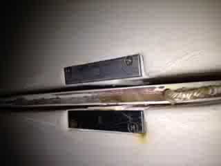

I don´t know if the centerboard trunk is leaking or not since the sailboat is on a trailer and I cannot bring it down, but the screws do look a little rusty!
I am enclosing pictures. Any information or advise is greatly appreciated!!

With regards to your centerboard, it needs to be checked - you cannot validate its integrity otherwise. This means your boat has to come off the trailer. The ds is a small boat so it won't be hard.

The DS II hull has no core, is solid fiberglass.
Without seeing the cracks I really can't fully advise how to repair, but I would grind out the cracks and repair with epoxy resin and fiberglass tape (4" wide +/-). That area of the hull is a bit flexible, at least on my DS II so resin alone may not solve problem.

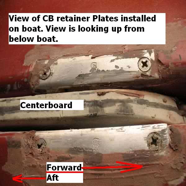

What year is your DS II? When you refer to rusty screws in regards to the CB trunk, I am assuming you refer to the screws holding the 2 metal plates under the boat that retain the wedges that hold the CB pivot pin in on 1980-85 models?

Thanks for the info. it is very useful and I will proceed with your suggestion (after I google how to use the fiberglass tape with the epoxy resin....) It is a 1984 model. And yes, the screws are for the CB metal plates.

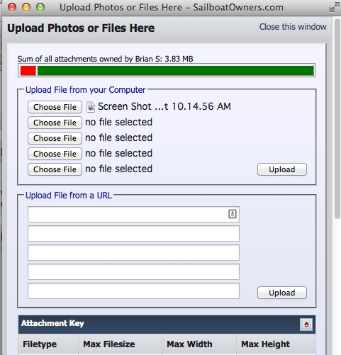

When posting pictures, you have to select the image file in the pop up window, and then you have to click the upload button once the file is selected. Then it will show attached, and you can do funky stuff with image tags and whatnot to make it in-line in your message :D Use the Go Advanced button next to the Post Quick Reply button. Click the Camera icon button to bring up the pop up window.
Then, select your file. It will use your OS's file browser to find the image. Once you have selected the image, you MUST click the upload button, otherwise it won't go to the site's server.
Once they are uploaded, they show a line lower down on that window. You can right click on this link, and copy the link address (or whatever wording your browser uses) and then you can paste into your message using appropriate [ img ] and [ /img ] tags. (Note I added spaces so that it would show.) This is how I get them in-line.

Thank you Brian. I tried uploading 2 pictures, but it shows an error stating:
"The Dimension limits for this filetype are 800 x 800. We were unable to resize your file so you will need to do so manually and upload it again. Your file is currently 2448 x 2448."

It is common for there to be cracks in gelcoat. You would need to widen the cracks in order to fill them. Old school pointy can openers, "church keys" are sometimes used for this purpose. I have filled cracks in gelcoat with white Marine Tex, and found new cracks later. So...
If you have cracks that go through the underlying laminate, such that water is getting into the hull, you really need to grind these cracks out and refill properly with glass and resin. This is because the structural integrity of the glass laminate is compromised. Basically, feather it out, and lay in with multiple layers of glass cloth. There are lots of instructions on the web with best practices...

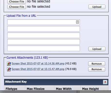

The pictures uploaded. Here's how they look in-line, and I will post code how to do that. Just remove the spaces in the brackets [ ]...

Since they are right in the hull under the waterline, I think I'd grind them back and refill with glass and resin, per approved repair techniques. They are quite small, and it would be a reasonably easy fix. Google "how to fix through hull holes" or search on this site. It's been discussed relatively recently on the Ask All Sailors forum. (and argued about whats the right way :D )

The second picture damage was caused by an impact of some sort, indicated by the circular cracks in the gel coat.
You are going to want to repair those properly and look for additional damage inside

Hello again..... I started grinding the cracks on the hull and more water came out, so after enlarging the cracks I decided to make a viewing hole on the cockpit sole and found lots of water which I vacuumed out.
Question: Did I make the hole on the wrong place that might compromise the integrity of the sailboat? I made the hole in the middle on the farthest aft part of the cockpit sole, on the elevated sole. What I ended cutting out looks like a fiberglassed foam shaped like a backbone.
If this is the wrong place for the viewing port or should I finish it, and if it is on the wrong place can it be fixed? how?
