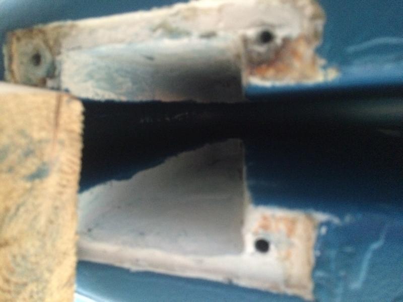

Here is a photo I took yesterday. The only caulking looks old and the left side doesn't look like it has been scrapped clean. The wedges look relatively clean too.
Not sure if they are doing it right and have not asked them specifically but it is what I see.

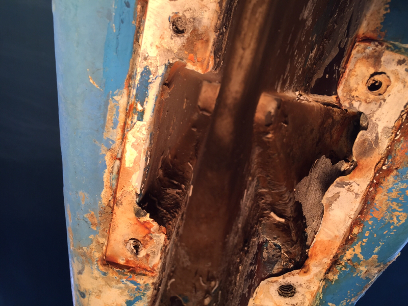

Whoa! Those need some work. Mine probably need more work too but I am finishing this project soon. Check out this photo of the wedges area after I epoxied them this month. I just got off the phone with Rudy at D&R Marine and he said to adhere the wedges on the flat face with 3M 4200. Do not glue the pin! I appreciate your correspondence Ward and hope you have a good sailing season. Max
