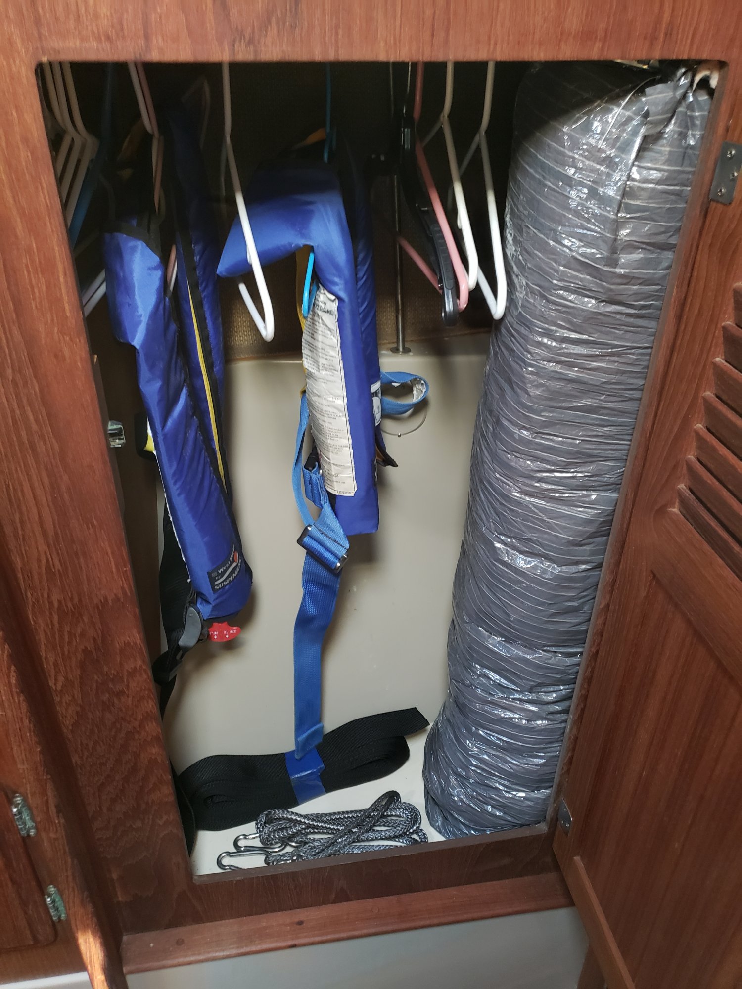

I have a 16,000 btu king unit under the starboard seating. It does alright but i need to rework the ducting. There is enough room.
Heave2
Jul 6, 2019
4
O'day O'day 39 Key Largo
The ducting isn't great, but this is how the former owner did it. It runs to the wet locker and then tees off to a vent in the salon and one in the vberth.

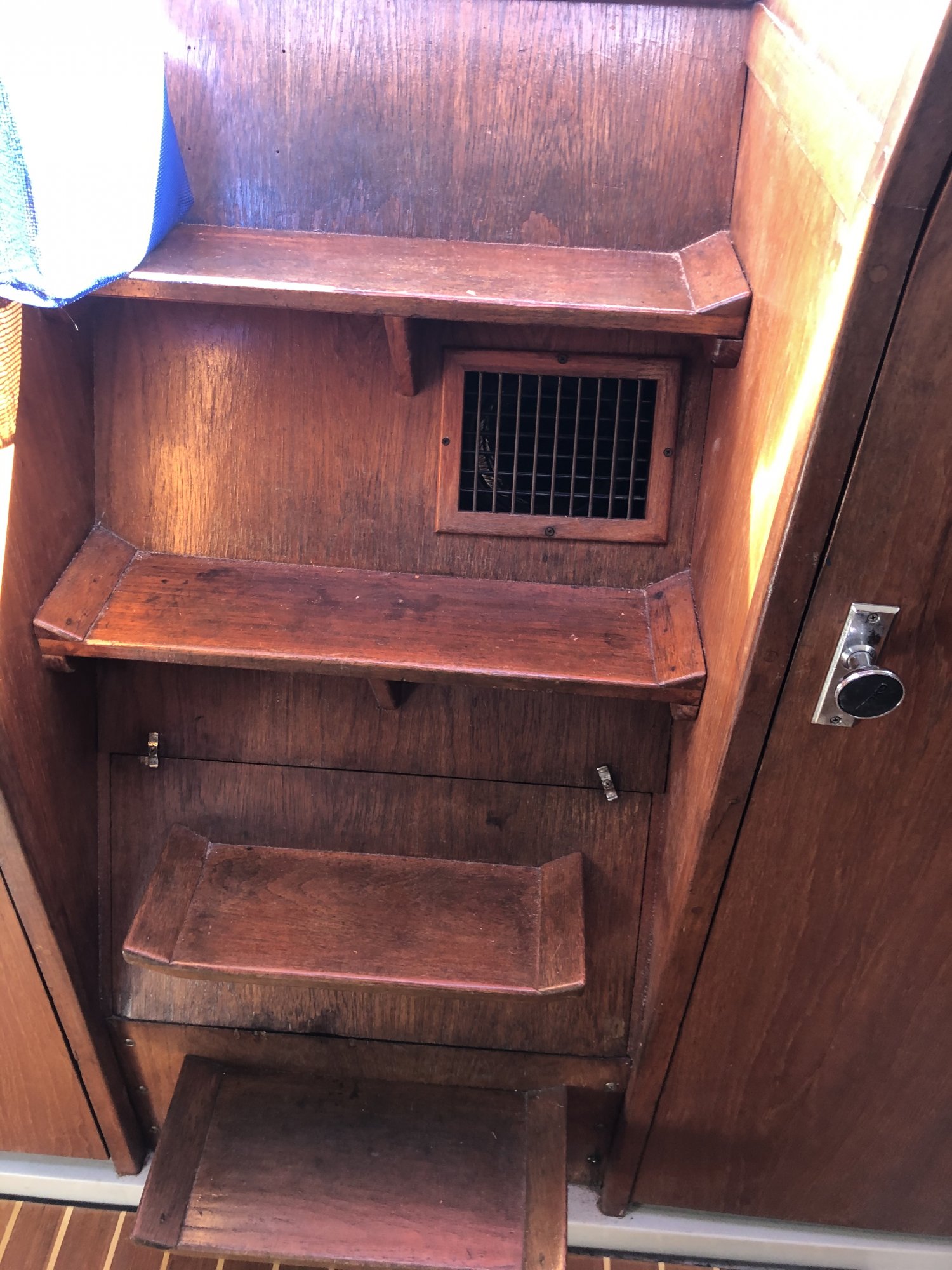

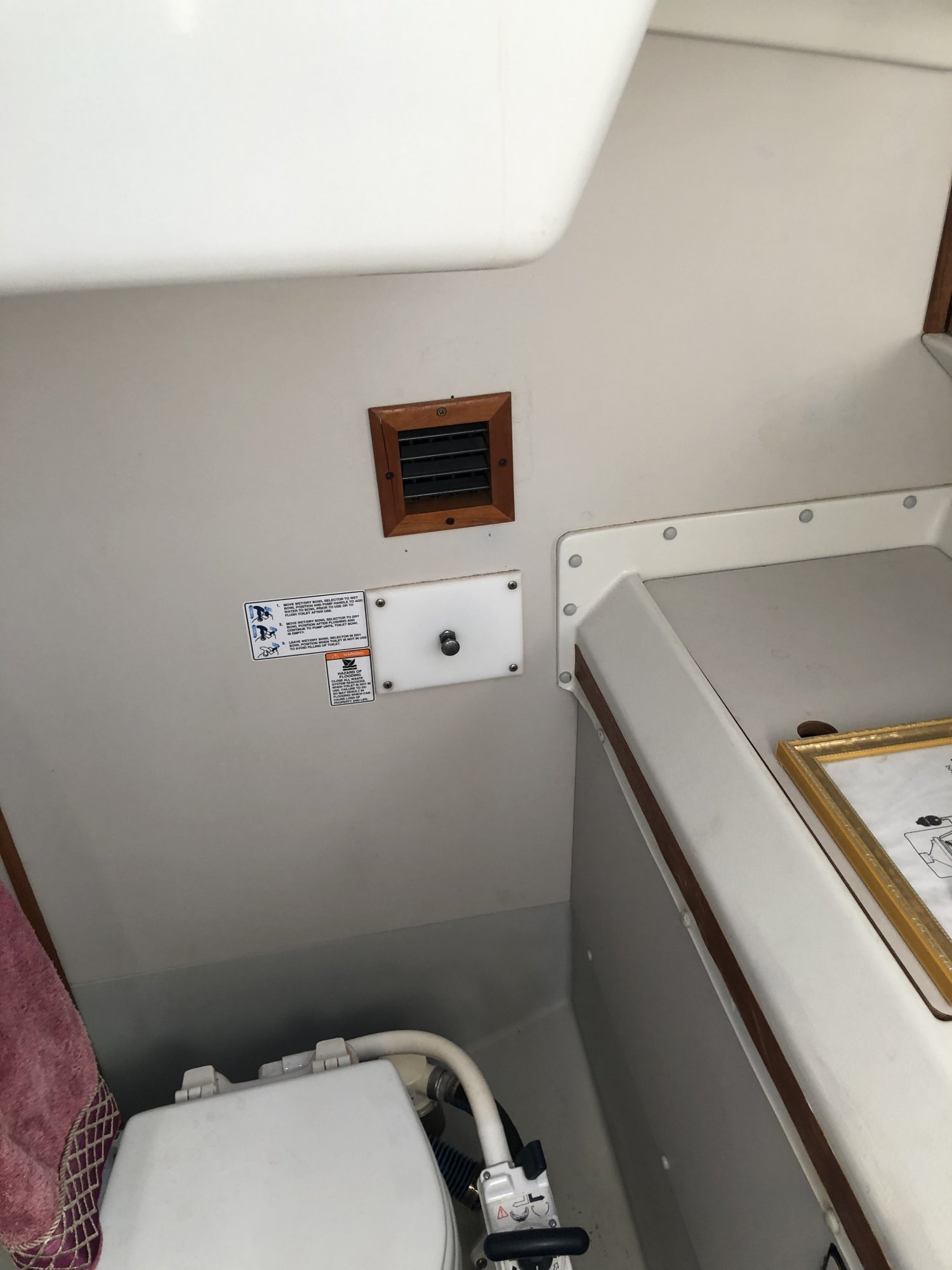

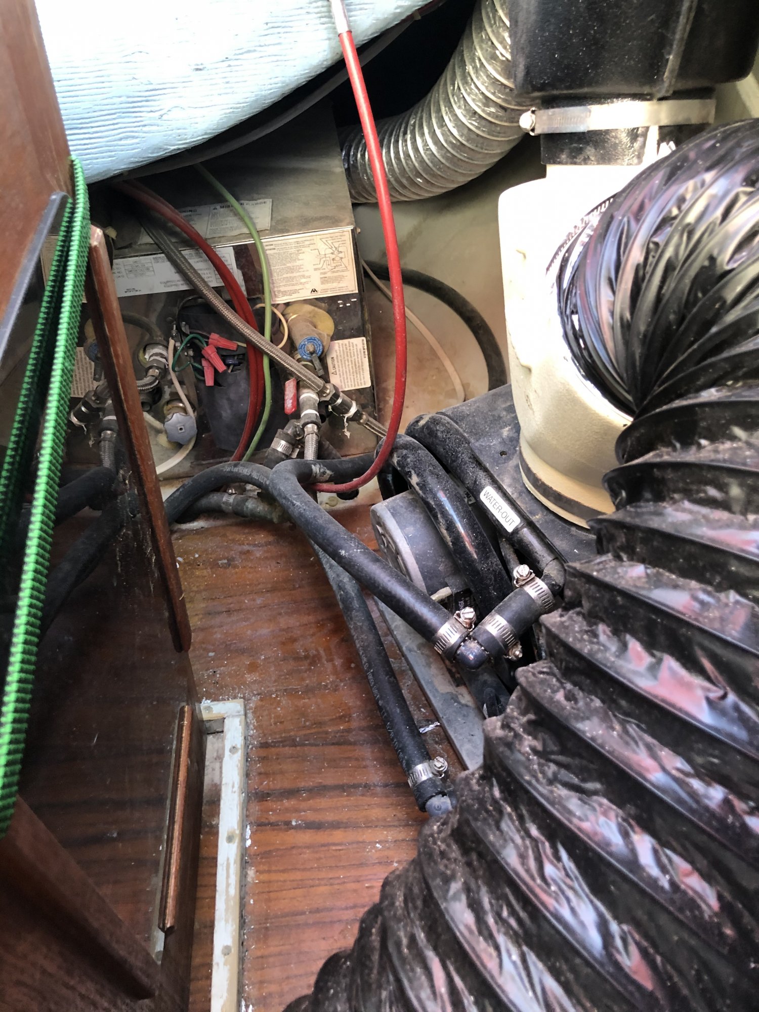

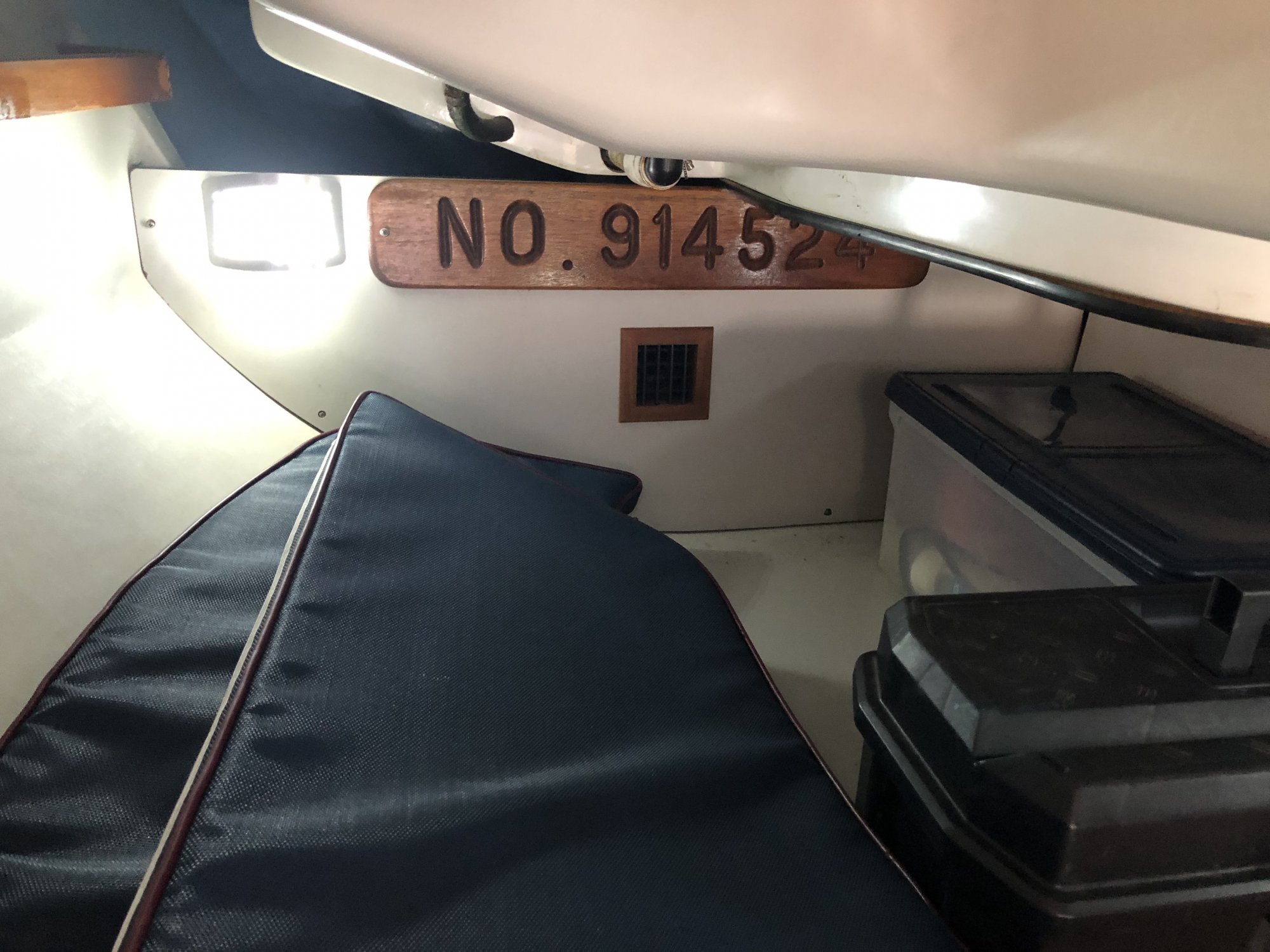

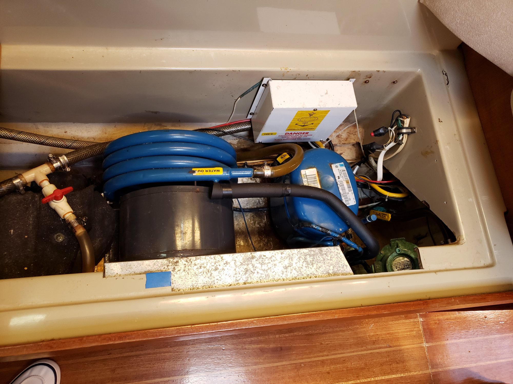

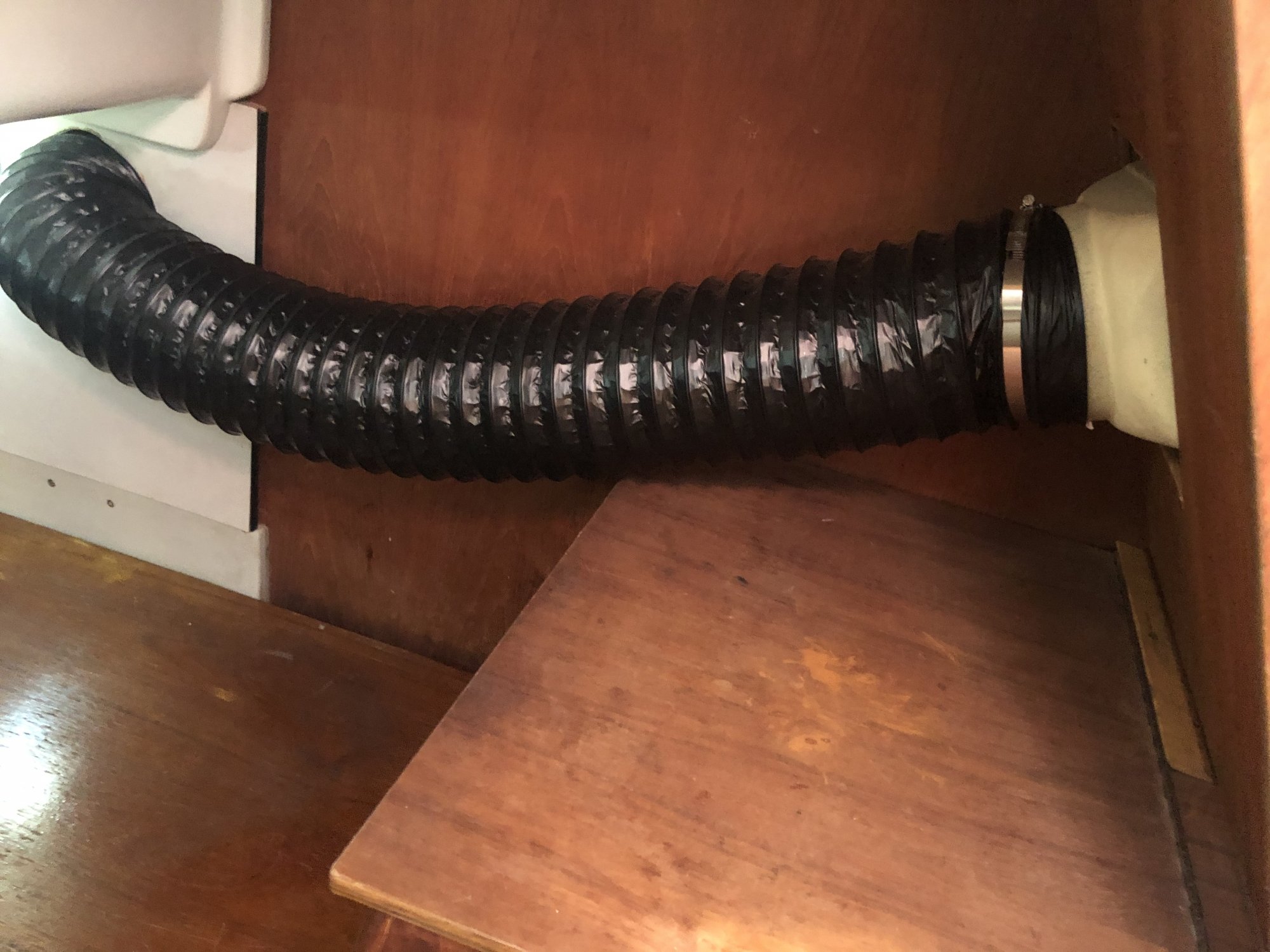

Hi Mikster. Here are some photos showing the AC/Heating unit in the cockpit locker, the three vents into saloon, head and quarterberth, and the duct to the saloon vent:
93890685-4701-4AB6-93C9-5CADD6748223.jpegED3B13AE-61FF-4F70-8FB9-076EA40D2F1C.jpegBBA6AC47-7CEF-4E54-A267-C86E687658ED.jpegB66E6068-6DB5-474B-9B6C-56C8B25D1BCB.jpeg
I hope this helps.
