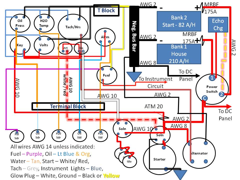

thanks, this is huge. My existing engine panel is looking peaked & at times previous, I had thought about potentially replacing it. May well be more reasons than previously thought t tear into this. Many thanks!
May 30, 2006
352
Oday 34 Chesapeake Bay
Just saw this diagram. Reminds me that I need to install a solenoid in my glow plug circuit.
Thanks
Jan 28, 2017
26
O'Day 34 Suttons Bay
Jan 27, 2008
3,086
ODay 35 Beaufort, NC
The second plug should be just behind the panel. You might have to pull the panel to access it.
Jan 28, 2017
26
Yep. That’s where I found it. So, would an automotive relay work for the starter/glow plug upgrade, or does it need to be the (more expensive) marine solenoid?
Jan 27, 2008
3,086
Why won't it work? Think of it this way, the automotive relay does not know where it is, it just receives a voltage and actuates. Engine compartments on cars are a horrible environment, road salt, dirt, sand, bugs, mice chewing on wires, constantly wet from going through puddles and rain storms, people driving on the beach in their 4 wheel drives. The marine unit is probably the same thing with a new sticker on it that says "marine." A boat engine compartment is typically a better environment except for the dripping stuffing box and it is hot.
Aug 17, 2010
327
Oday 35 Barrington
You can use an automotive starter solenoid as a glow plug solenoid. The only concern is that you need one that can handle the amperage.
