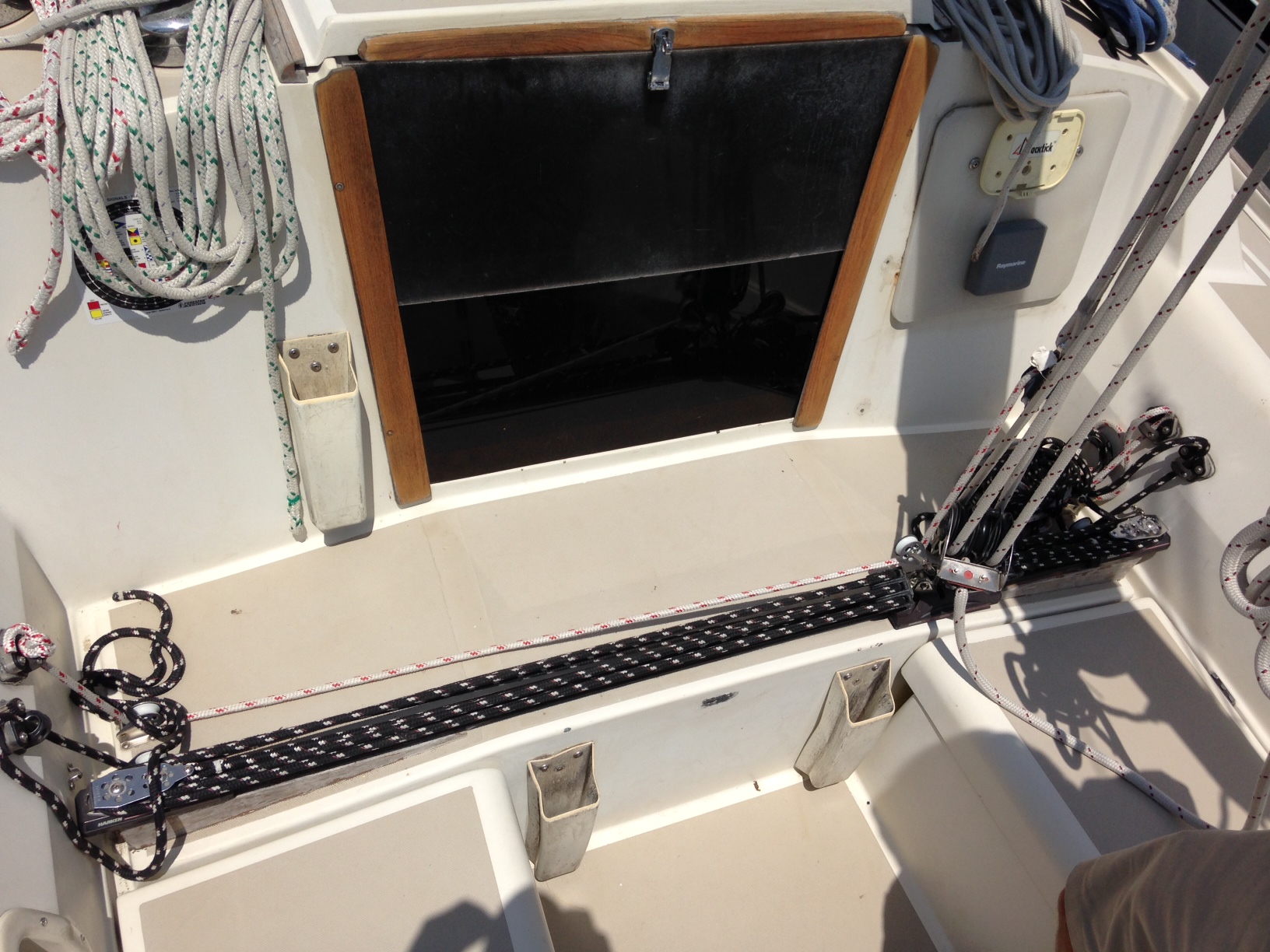

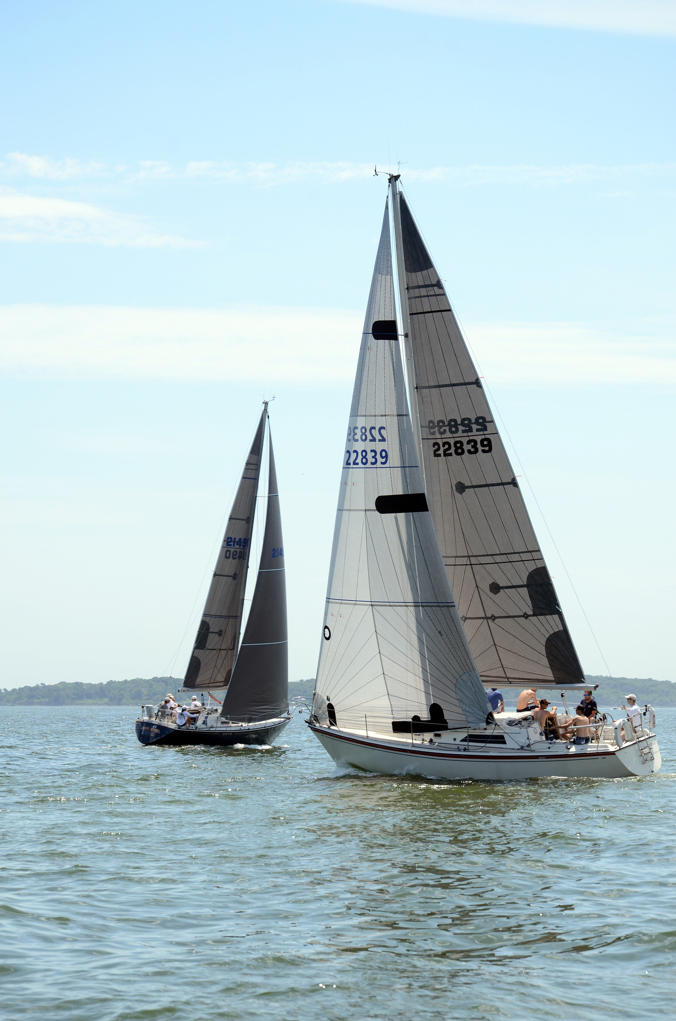

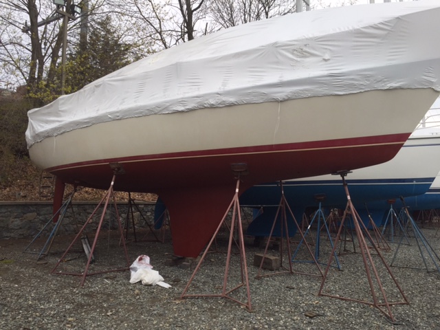

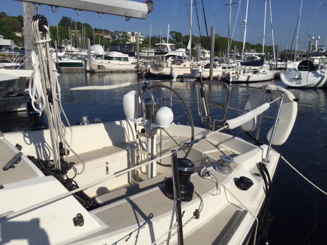

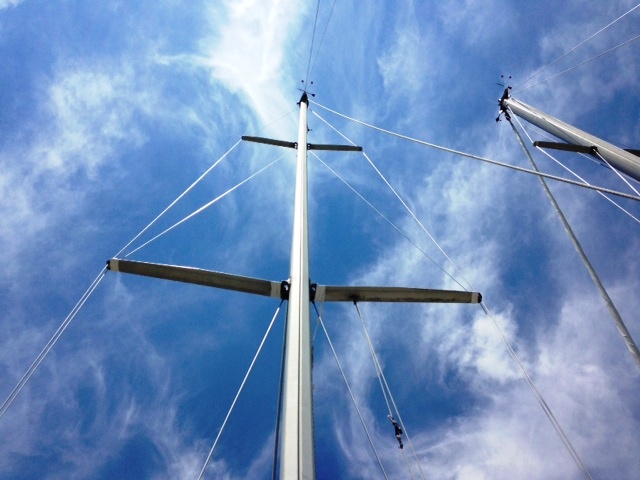

Sorry for not keeping track of this thread. I uploaded a few pictures of Hornet to show the rig, sail plan and keel. The rudder was replace with a new design from Foss Foam, the new design improved the airfoil due to the orig rudder being wet.
Keel/Rudder
Cockpit
Main traveler located in cockpit
Rig (Double Spreader, Rod Rigging, Inline Single NavTec termination tie rod into cabin pan)
Under Sail

Interesting. There was a double spreader rigged 34 in Racine about a dozen years ago. It had been on the hard for several years and had internal water damage. Someone bought it and I never heard what happened to it.

Hello Rob,
My name is Scott and I just purchased the Oday 34 that was for sale in Manistee, Mi No Regrets. This boat has the tall double spreader rig like yours and the 6 2 keel any idea how many were made this way. Also I see in your pic going upwind your head sail leech is past the upper spreader and it looks like a 150 or so genoa how is that? On mine I have a 130 and when I sheet in is is inside the top spreader so to me it looks as if i put a 155 I would not be able to sheet in as tight as I can with the 130. Also it seems to me a 155 may be to much sail once the wind builds to say 12-15 do you reef early? I have a lot of questions maybe we could converse on the phone
Scott

Hi Scott,
I found the listing on your boat, its interesting since it certainly is the tall rig but without some keel modifications and in line spreaders. Hornet also lacks a headliner and has a larger boom, I take about a 21 second rating hit over a factory boat and is balsa cored hull and eck. This is a 150% in the picture, recently went to a 142% head sail and still have plenty of power. We can hold this sail until about 18 knts, need to reef this point or drop to the 3 with no reef. Depending on conditions we will de-power with main reef or head sail. With the 142% we are hitting the top spreader and like to be about 2" off upwind. Happy to help answer additional questions, congrats on the boat once you get it dialed in the boat will impress you.

A couple of comments, first congrats on your purchase. Nice looking sails, too! I'm curious to know what a new 'improved design' rudder cost you? Your probably not getting hits on the backstay question because most of us don't have one. I spoke to my rigger who actively races and he opined it wouldn't do much for our typical rig.

Nice looking trim!

Hi, not exactly sure but recall it being around 2k shipped and crated from Foss Foam CA. Very nice product, made from Vinylester and has held well over the past 4 years. For the back stay question this thread is a few years old, you figure out how to answer your own questions.
