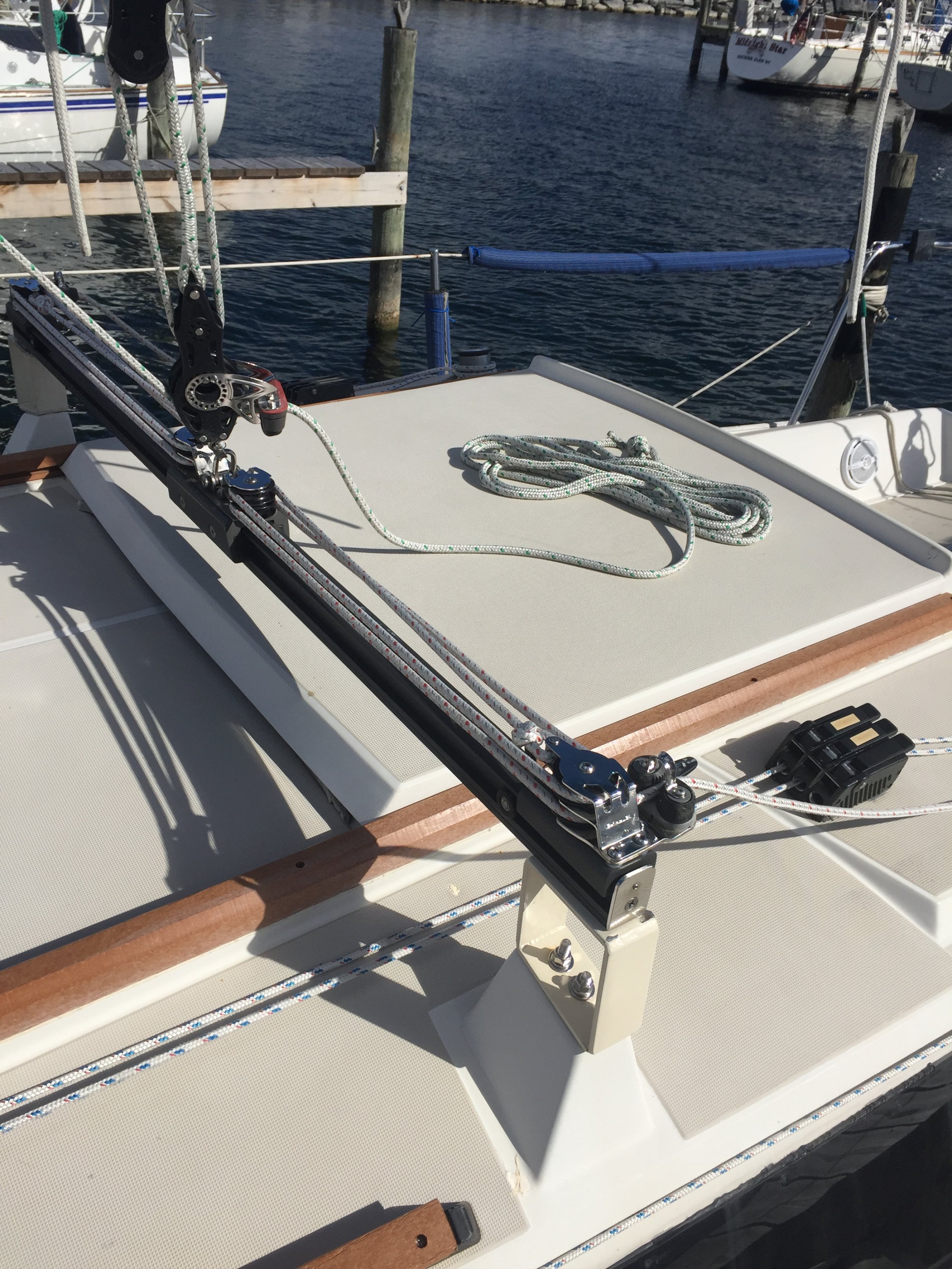

Alistair, as others have mentioned, a call to Harken would be a good idea - they are really great to work with and will help you spec exactly what you need. They do bend track there, and I would think it would be easy enough to template your curve and send it to them. On our Oday 34 I replaced the curved track with a straight Harken track, the only downside is I cannot remove the storm hood (should I ever need to) without removing the traveler.

I replaced the traveler on my 272 with a Garhauer MT2, I think. Straight track, control lines. I built stainless steel risers. Absolutely love it!
