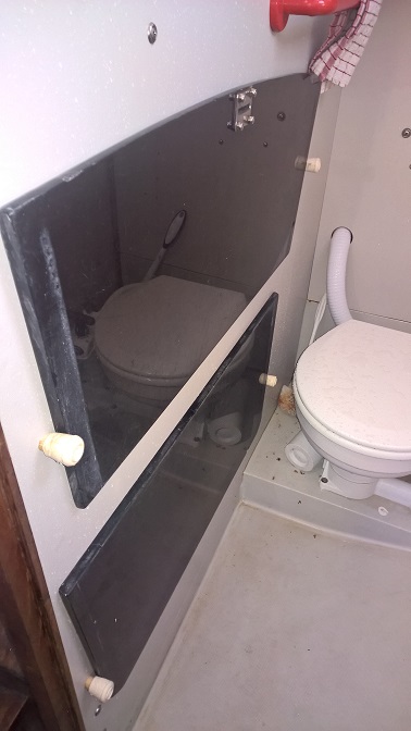

My toilet hose ran down from the head thru the deck and bent back up to the Anti-Siphon atop the Y valve. I was a ***** to remove but I replaced it by a shorter smooth path thru the head's aft bulkhead, directly to the Y valve.
You can see the new direct path here in my washboard photo.
While you are plumbing. You might want to reroute the tank vents.
Mine ran from forward and aft of the tank (starboard) ACROSS the hull under and up to join together at a "T" and vent thru the hull on PORT. Which works great unless your boat heels.
For the NEW vent lines I over-sized the connectors to the tank to 1/2 inch and ran the forward one thru the closet in the quarter berth and with high loop out the hull well above the waterline. The Aft vent now runs to the centerline and AFT going UP to a large loop and venting out also well above the waterline.
Then I replaced the manual maserator pump (which was leaking) with a 12 volt.
