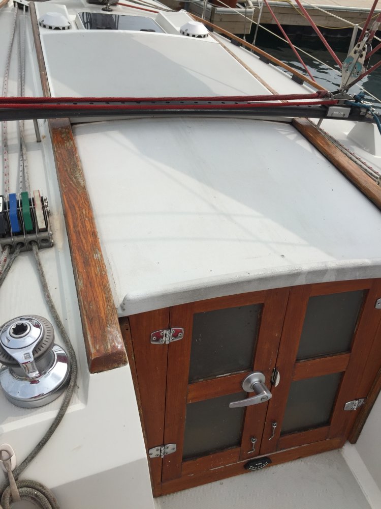

A previous owner had replaced the slider on my O’Day 322 with a fiberglass or expoxy-covered hatch.
I really like it. If you look carefully, you can see it in this photo.
It has some arch to it, so rain runs off. It is robust enough for me to stand on.

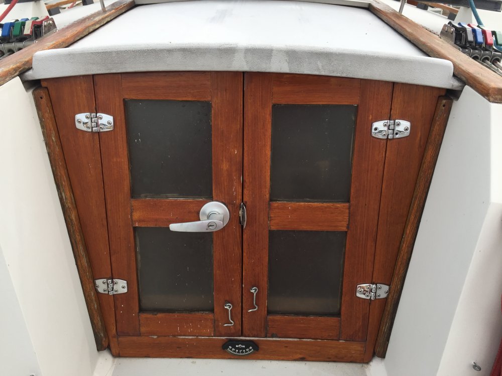

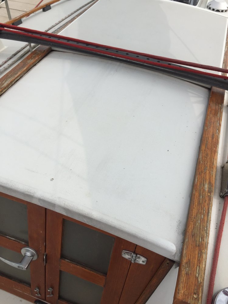

@Mickstr,
Here are a few photos of the replacement hatch slider on my O’Day 322.
I also have the washboards, which can replace the doors, but I like the doors better.
I didn't do the replacement, so don’t have a lot of information.

Thanks Greg. Just for grins I'm going to get prices from local acrylic companies, as I do like the light that affords. But, if it's too costly, I may do what your PO did.
