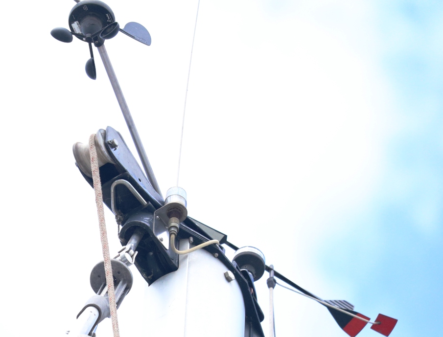

@AndreNJ11, do you have a photo of you spin halyard setup (block on the bail)?
Mine is set up with appears to be an anchor roller...has to be a PO mod.
Hi Tally Ho,
I have not done a spinnaker, so I have not addressed it. Yes, yours does seem to be an anchor roller.
Just putting a spin halyard on the bail block would seem to leave the spinnaker halyard on the outside of the mast all the way down (a real wind-slapping noise hazard). If I ever did it i guess I would try to cut in a mast exit on the front of the mast a few feet down, to take the spin halyard inside. It would have to be a double sheave mast exit. The one farther down the mast on the front (which is a single sheave) , I presume is for the spin pole topping lift.

Ok. Thanks. And yes, the single sheave down low on the mast is for the spin pole topping lift,
I used my spinnaker yesterday, and the halyard works fine (on the roller), so I guess I will leave it that way for now. If I take the mast down at some point, will consider options then.
