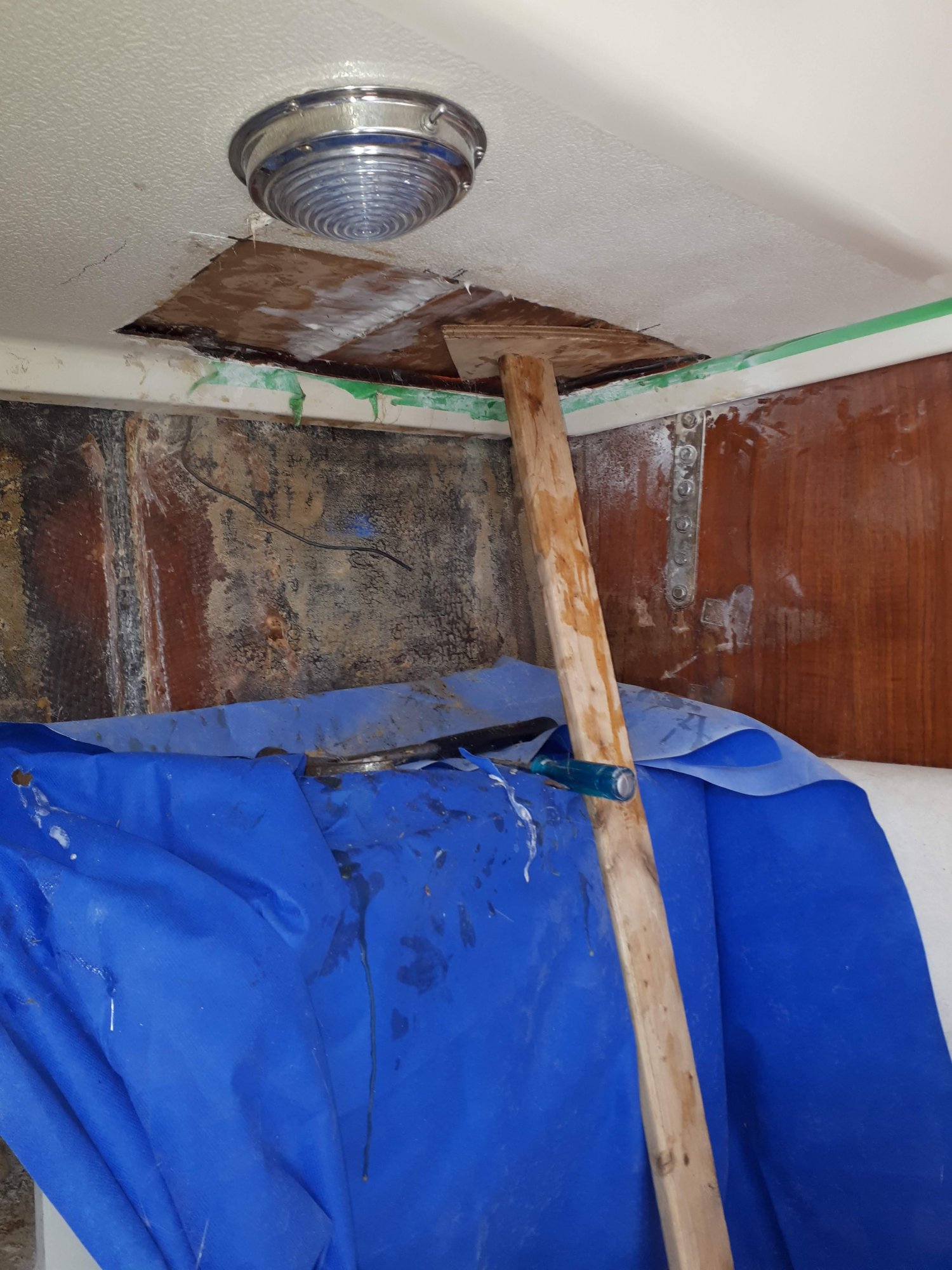

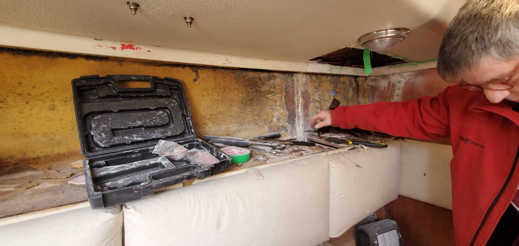

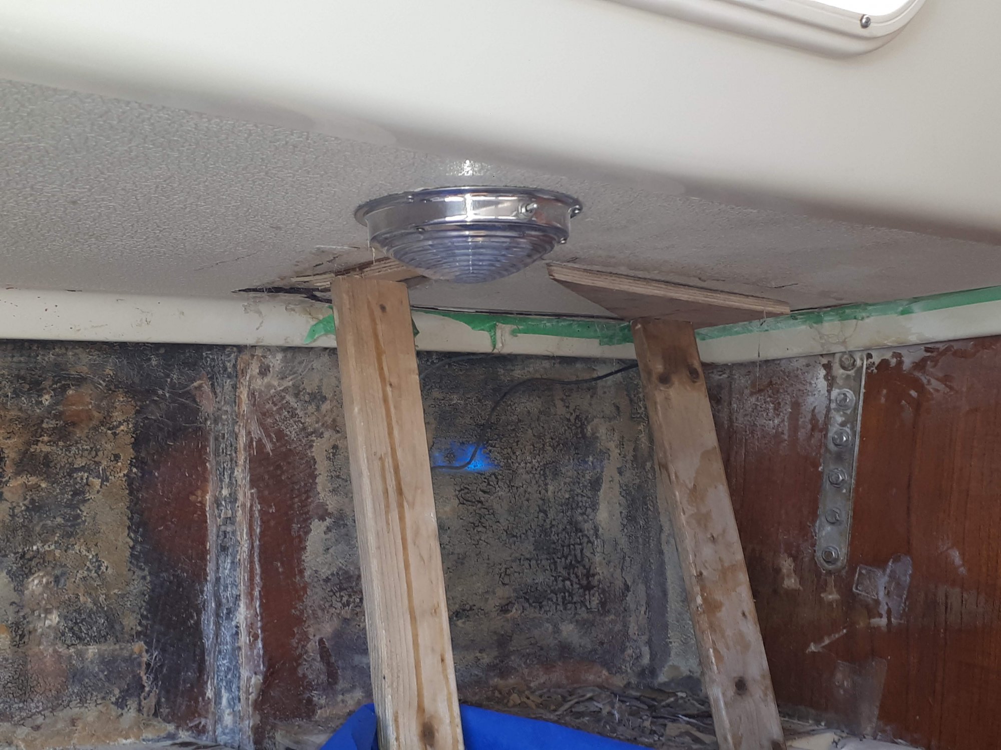

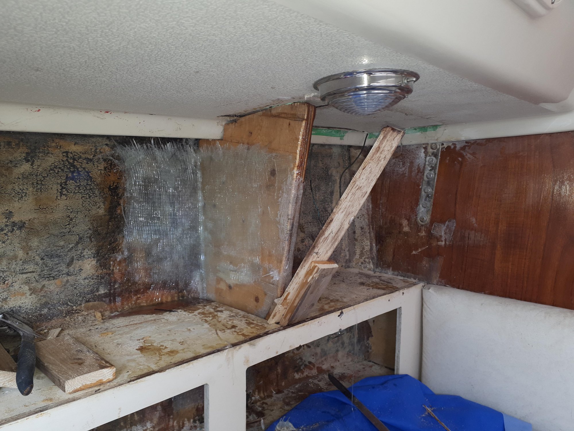

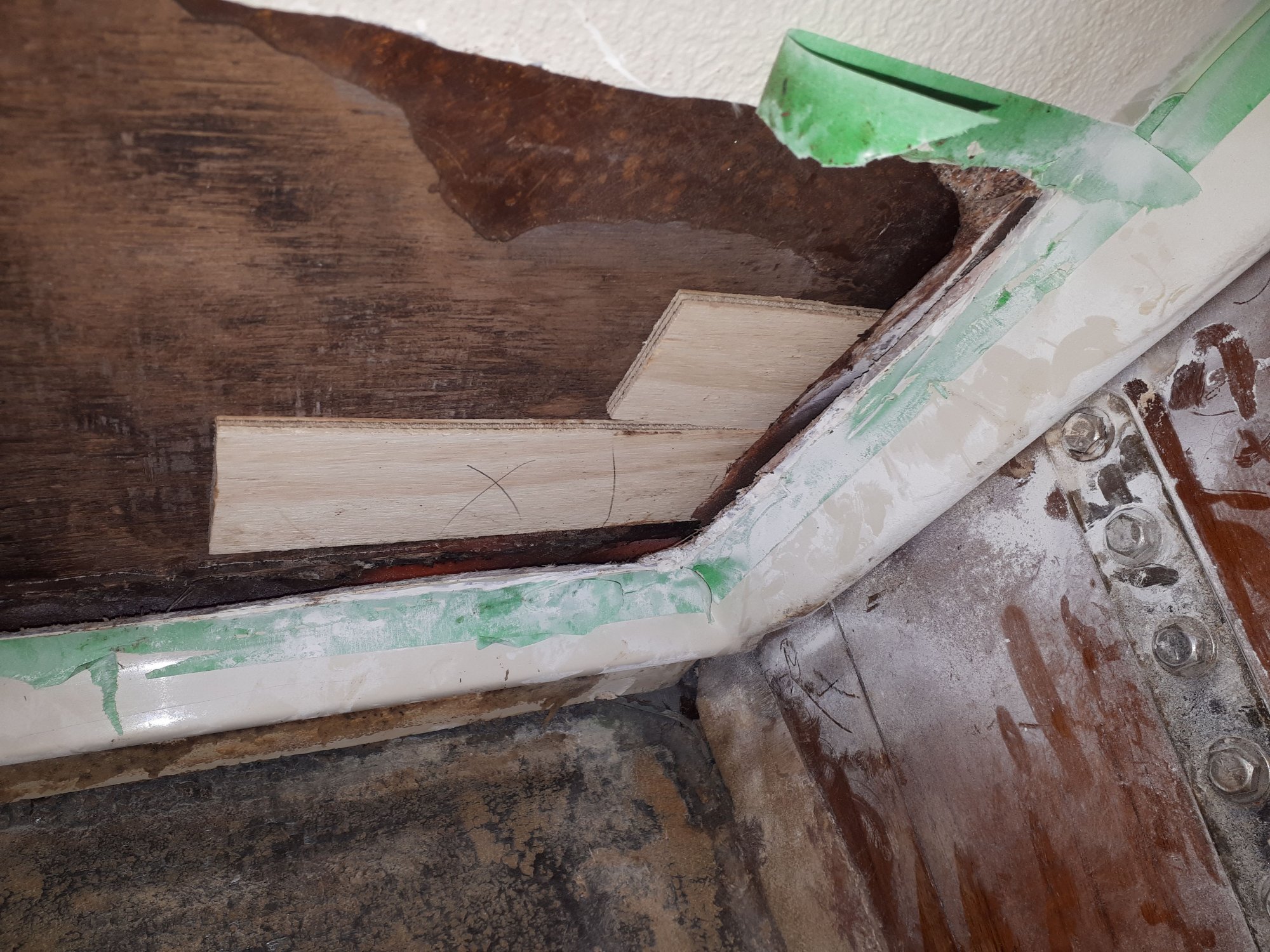

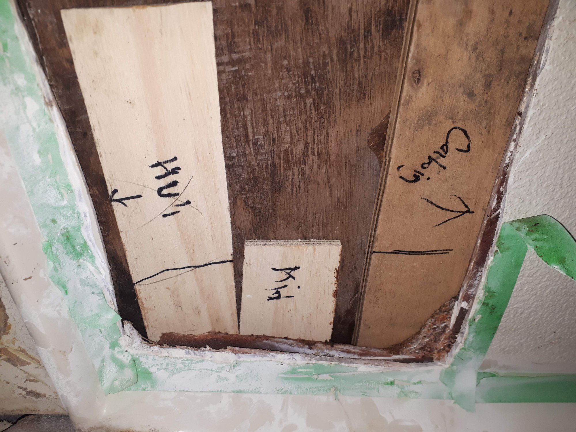

Dry fitting deck fix, after
1. cutting away headliner / ceiling
2. dragging out old soft wood core
(Subsequently epoxied and put back in place.)
