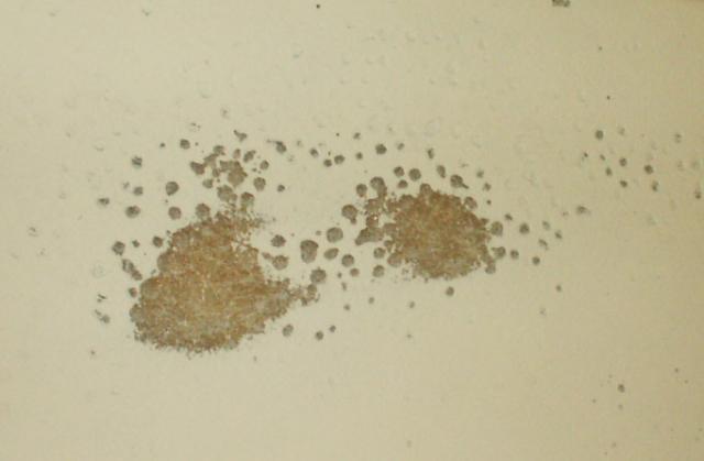

I've just thoroughly looked at my rudder without antifouling. I saw very unfortunate picture :( Gelcoat is out of condition - innumerable quantity of osmotic bubble destruction. Rudder body has laminated with sprayed fibre and it's out of condition too (it has a lot of local surface delaminations). I just hope that I will not see the same picture on hull of my boat when I peel a lot of antifouling coats from it!

The blisters are normal to a rudder that has been loaded with water, so after you open it up and do the repair you can coat the whole rudder with epoxy and make it better than new

Hi all! I've got some time to go on my repair. I have to say that the guys from "Fossfoam" didn't make their work well! Gelcoat on the rudder is very thin and has a lot of small bubbles. But they don't look as osmotic. It's some strange defect of gelcoat (insufficient mixing may be).

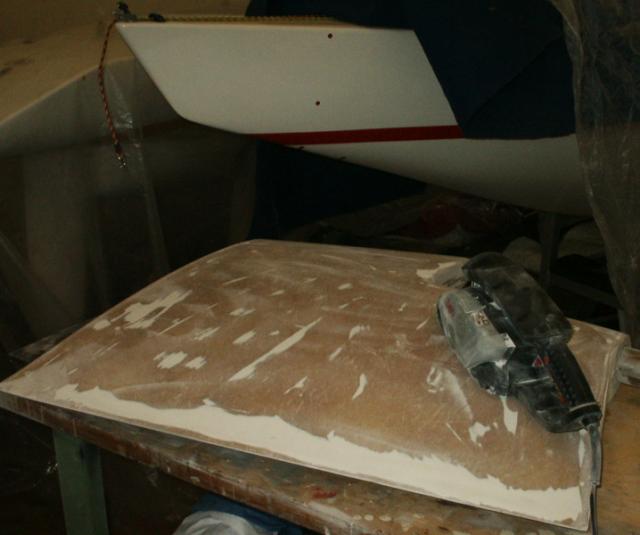

I've cut out the bottom of the rudder and was very surprised when I found a spacious cavity pocket with wet sand inside. Knocking exposed many another cavity pockets in other parts of rudder.

I couldn't divide a rudder in two separate parts. Was found that the trailing edge of rudder is really strong (unfortunately only one edge :) ). I made a decision to fix my rudder as is. I sawed two wide channel across leading edge tightened parts of rudder by the screw-clamps and glued two glass-fiber bands in flush with surface. Tomorrow I'm going to overcover the leading edge wholly with wide piece of glass-fiber.

Because of poor quality of gelcoat I made a decision to remove it all.
I wouldn't be too concerned about gelcoat on the rudder. As long as there is no mold release wax on it, and the area is later sealed. You're going to paint the blade with a bottom paint later on, anyway. I guarantee you that the hull on your O'Day 32 was built a lot better than that rudder blade. Good luck with that project, Konstantin!

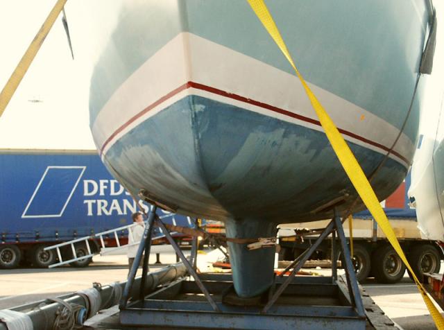

I very much hope for it! Hull has a lot of old antifouling coats. I'm going to remove it in April and inspect hull thoroughly.

Hulls on O'Day boats are prone to small blisters in gelcoat in southern USA. The technique in local area in treating them is to sandblast hull to open all blisters. Wash and let hul dry out for several month. It helps to occassionally wash hull to remove any leaching residue from blisters. Also wash with acetone to remove acids leaching from underlying FRP.
After hull dried (usually several months depending on temperatures) wash with acetone prior to repairing. All holes are filled with long fiber paste and refilled as nessary to get fair hull. Lots of sanding involved. After hull fair, the hull is treated with a sealing epoxy. Then an epoxy primer followed by your bottom paint.
Lots of work. You will get good arm workout. Also wear respirator.

Hi Ed! Yes you're right. If I can't find visible osmotic blisters I'm going to preventively apply 5 coats of Gelshield 200.
