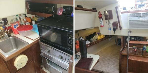

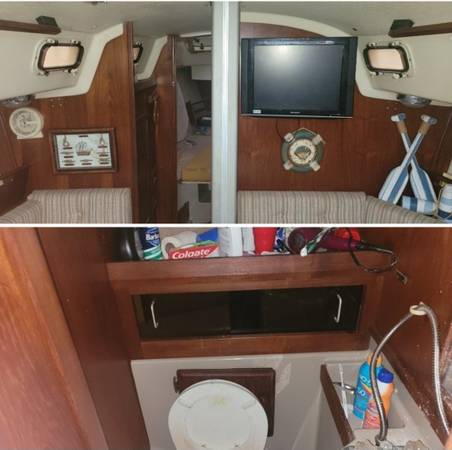

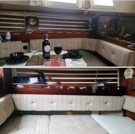

Hey Robert...here are a couple of photos that were with the Craigslist ad. At this point it is more curiosity as the seller has not responded to my questions or request to see the boat. Perhaps they are out of contact and I'll hear back sometime. Based on what I can see, I am almost certain it has to be a 30. A 30 is fine, but it does raise questions as to why he lists it as a 32...

I'd ask more questions, or (my reference only) pictures of the outside.
The interior that you showed is more pre-1980 30's, with the sink not being visible from the cockpit. (Tucked under the companionway) Post-1980 the sink was visible from outside or "next to the bench seating."
I had a theory that the post'er actually misspelled "O'Day 30" from what is really an "O'Day 302" - now I'm not so sure.

FWIW those photos look nearly identical to the interior of my 1985 O'Day 31

The only other clue I see is the wooden slats above the settees. I think in mid-85 they changed that to enclosed storage boxes. 85 was also the first year they made the 31 instead of the 30. Not sure if any early 31’s were made with the old style slats.
"Not sure if any early 31’s were made with the old style slats."
That is the one major difference between the photos and my 31. I have the enclosed storage boxes.
