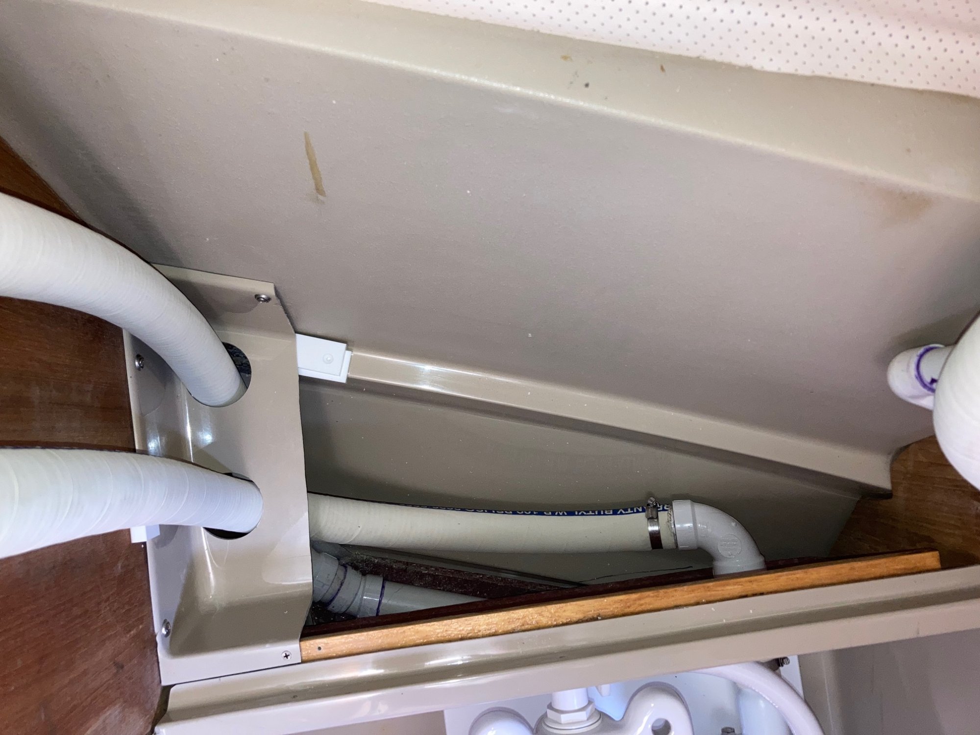

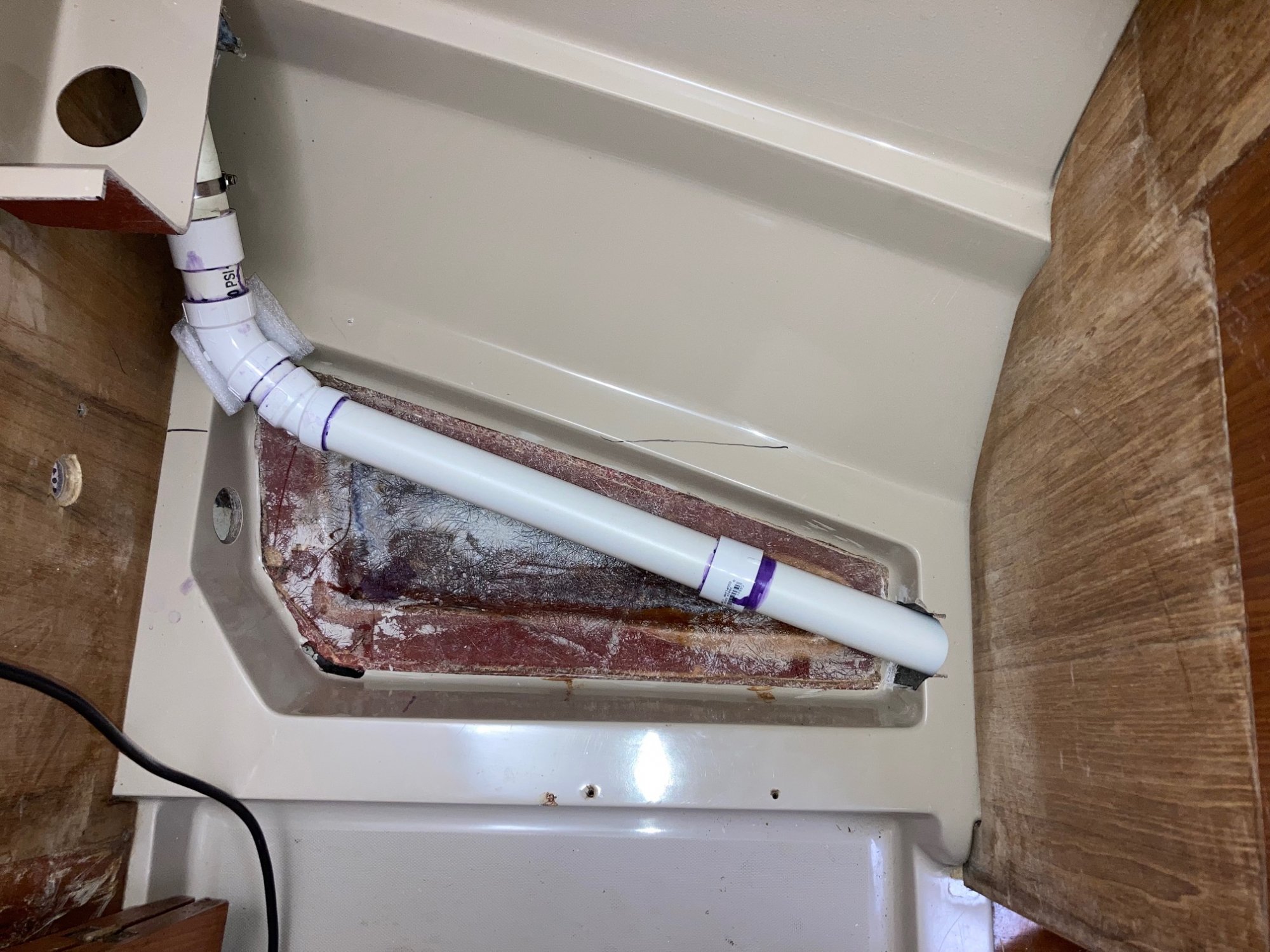

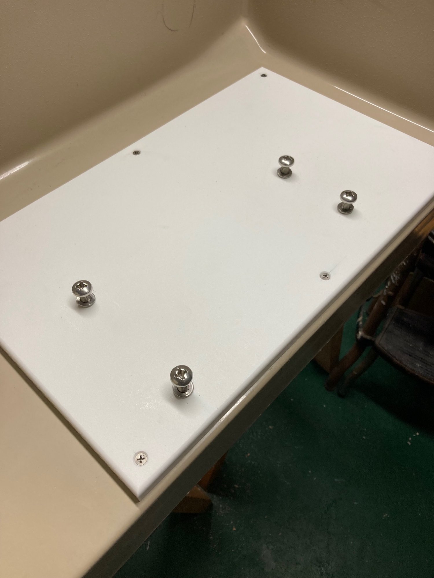

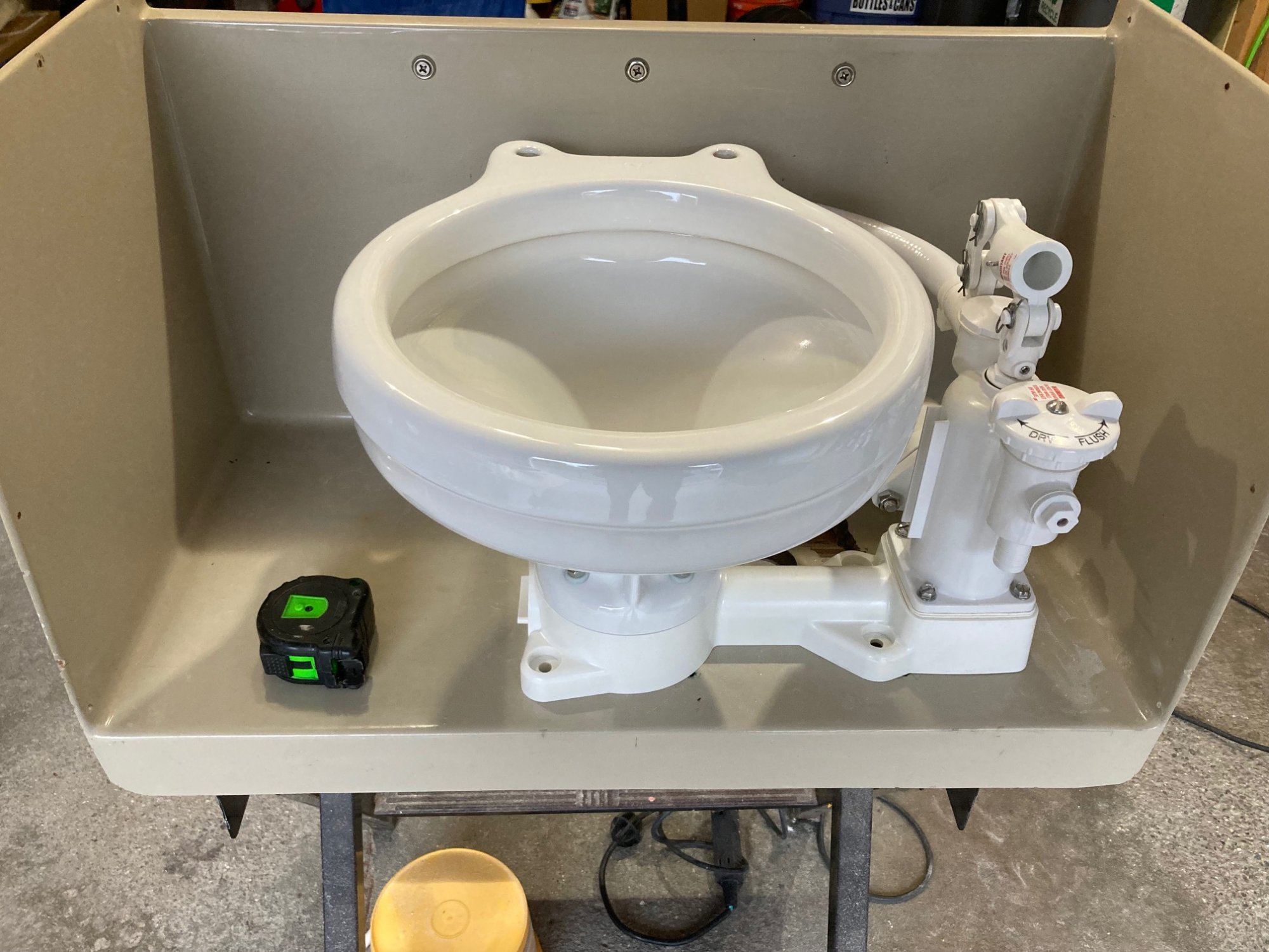

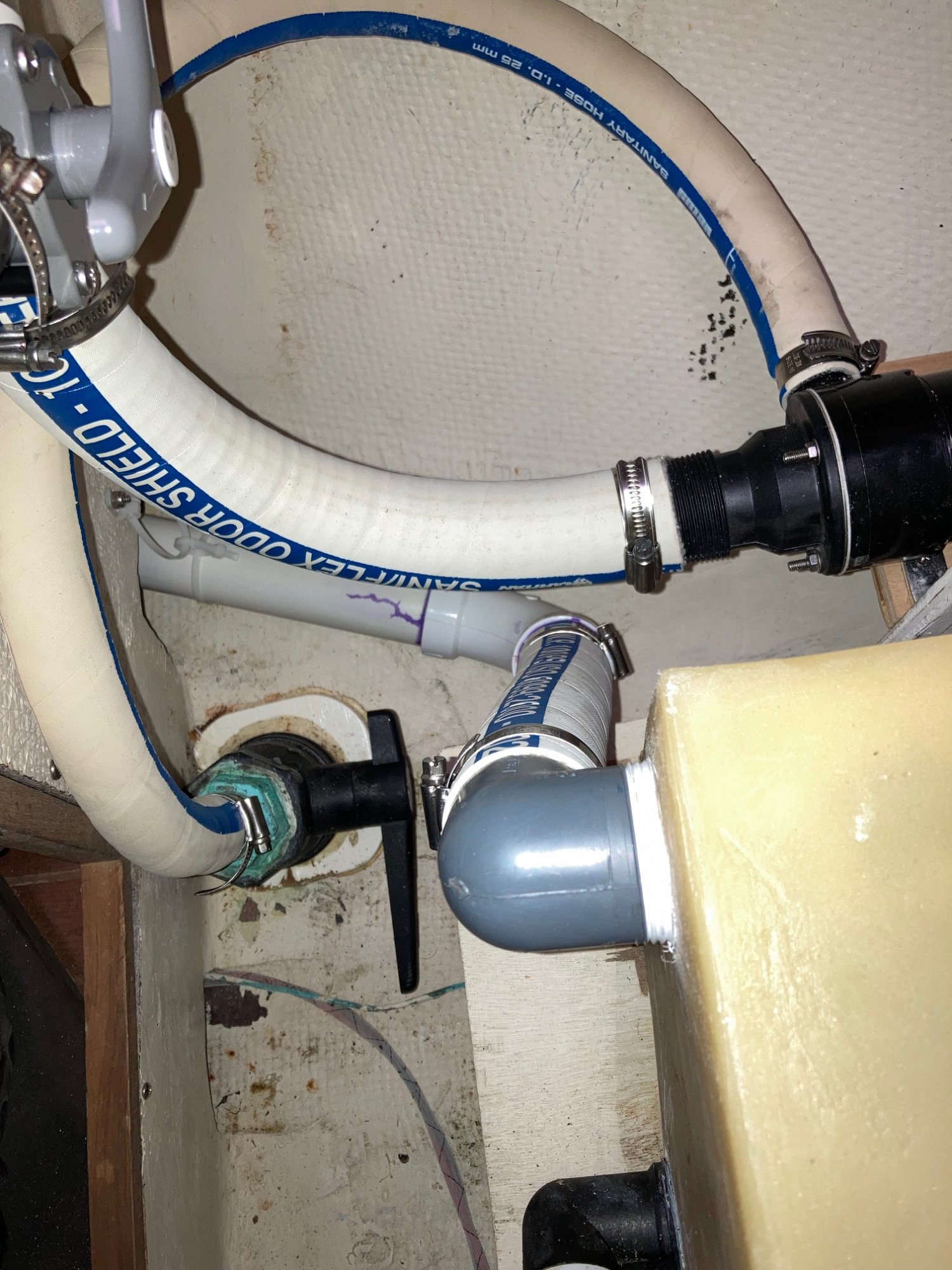

So, having redone everything downstream of the holding tank (and vastly improved the tank venting), it is now time to tackle the really tough part of my head rehab project. This past spring, I reinstalled the hanging locker face & shelf so that it is much easier to remove and had it out in about 10 minutes. I then disconnected and plugged the 1.5" hoses to/from the siphon break and the tank inlet and removed the Groco HF head.

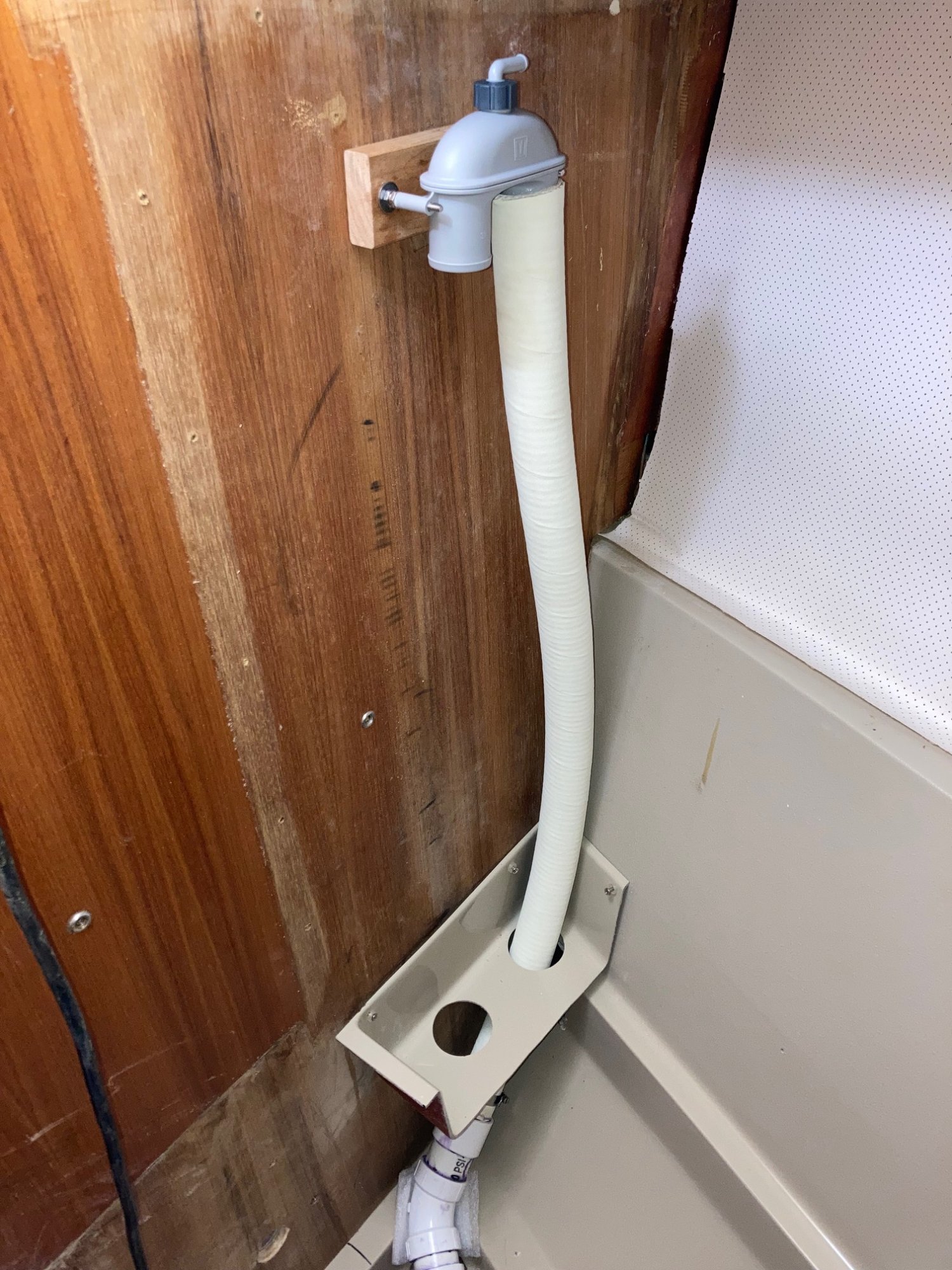

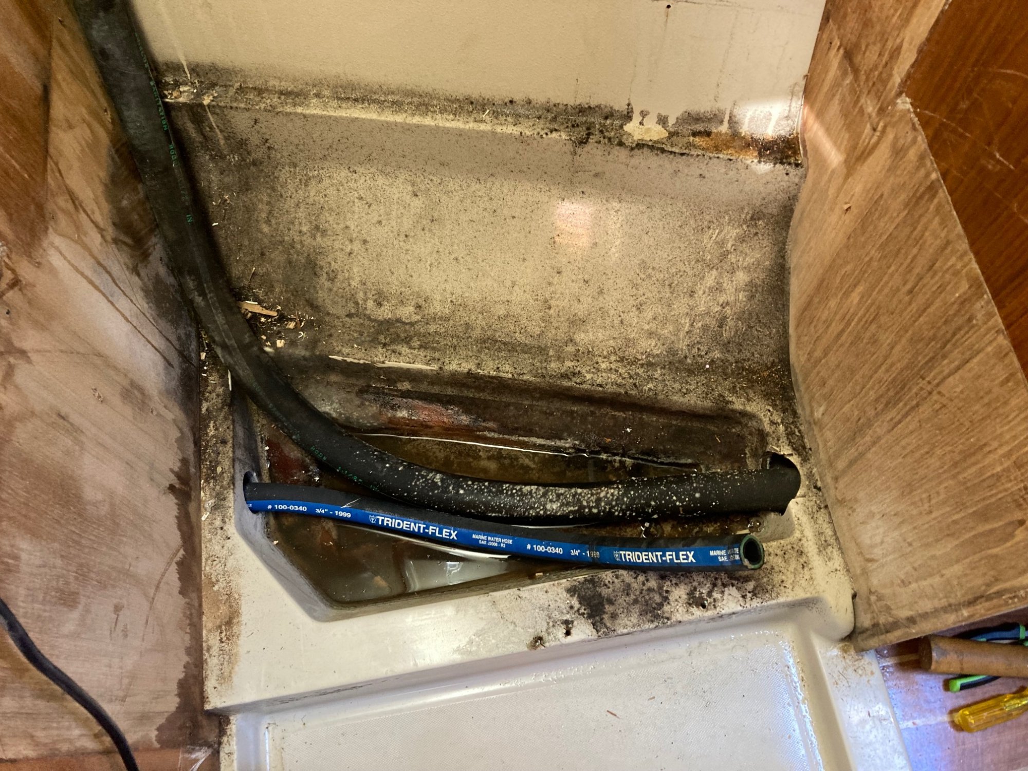

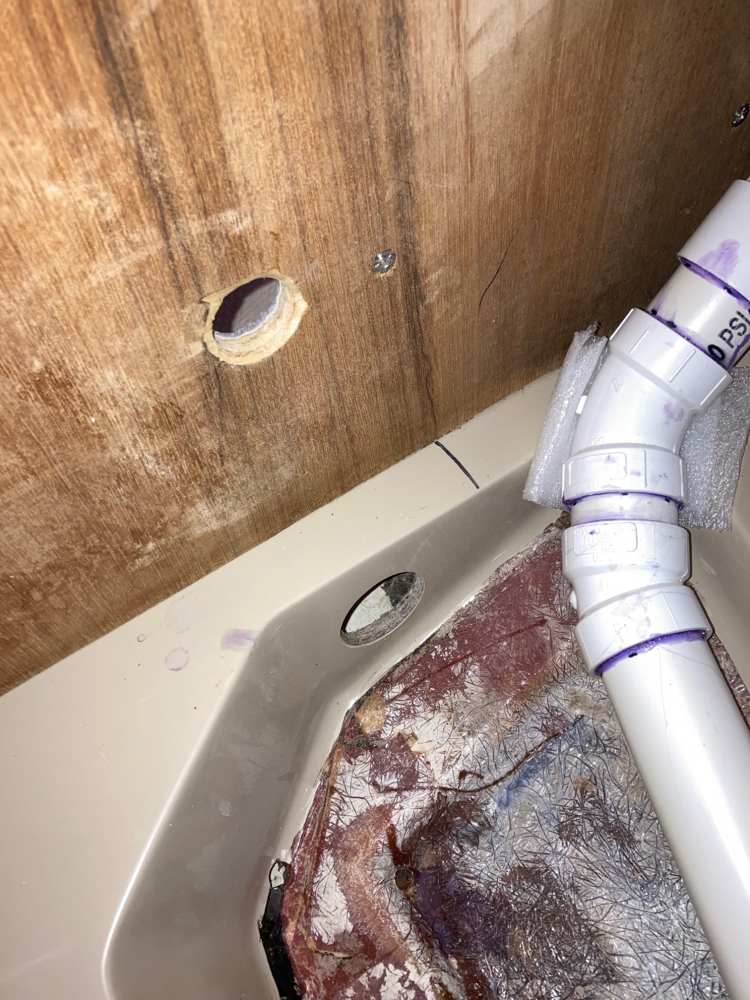

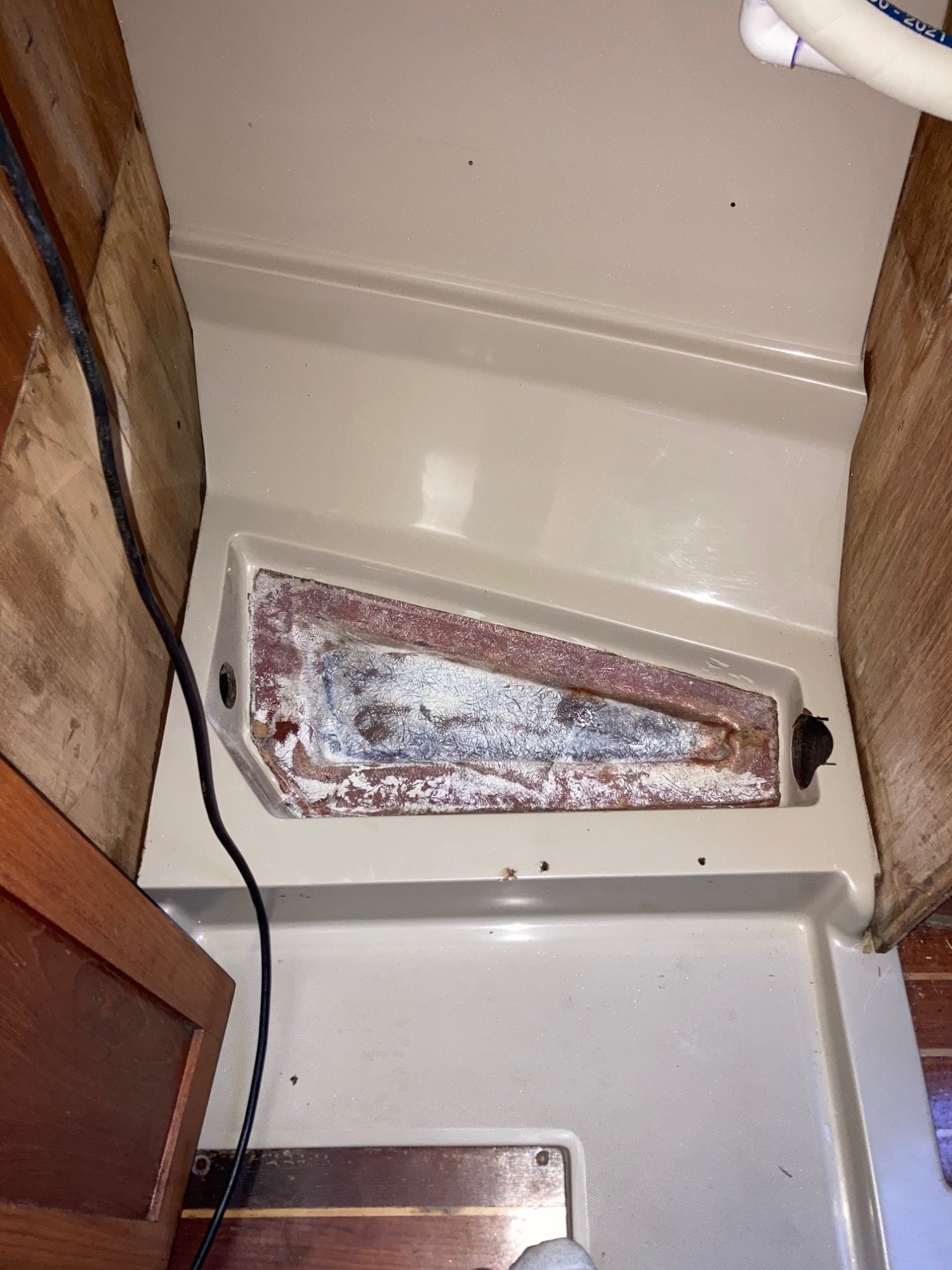

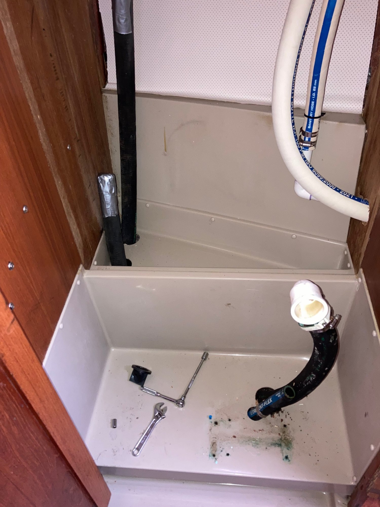

I then tried to see how easily the hoses moved back and forth between the locker and the forepeak, and the locker and where the head is mounted. The head connection hose moved somewhat as you can see from the attached image, but it was not easy. The other one, not at all. This makes me wonder if these hoses have ever been changed at all. I do know the head is not the original because of the second set of mounting holes. What is most concerning is that when I look down the hole where the hoses come up to the head, I could see a reflection indicating standing water. Not good. Hopefully there are a few clogged limber holes and if not, I have to figure out something.

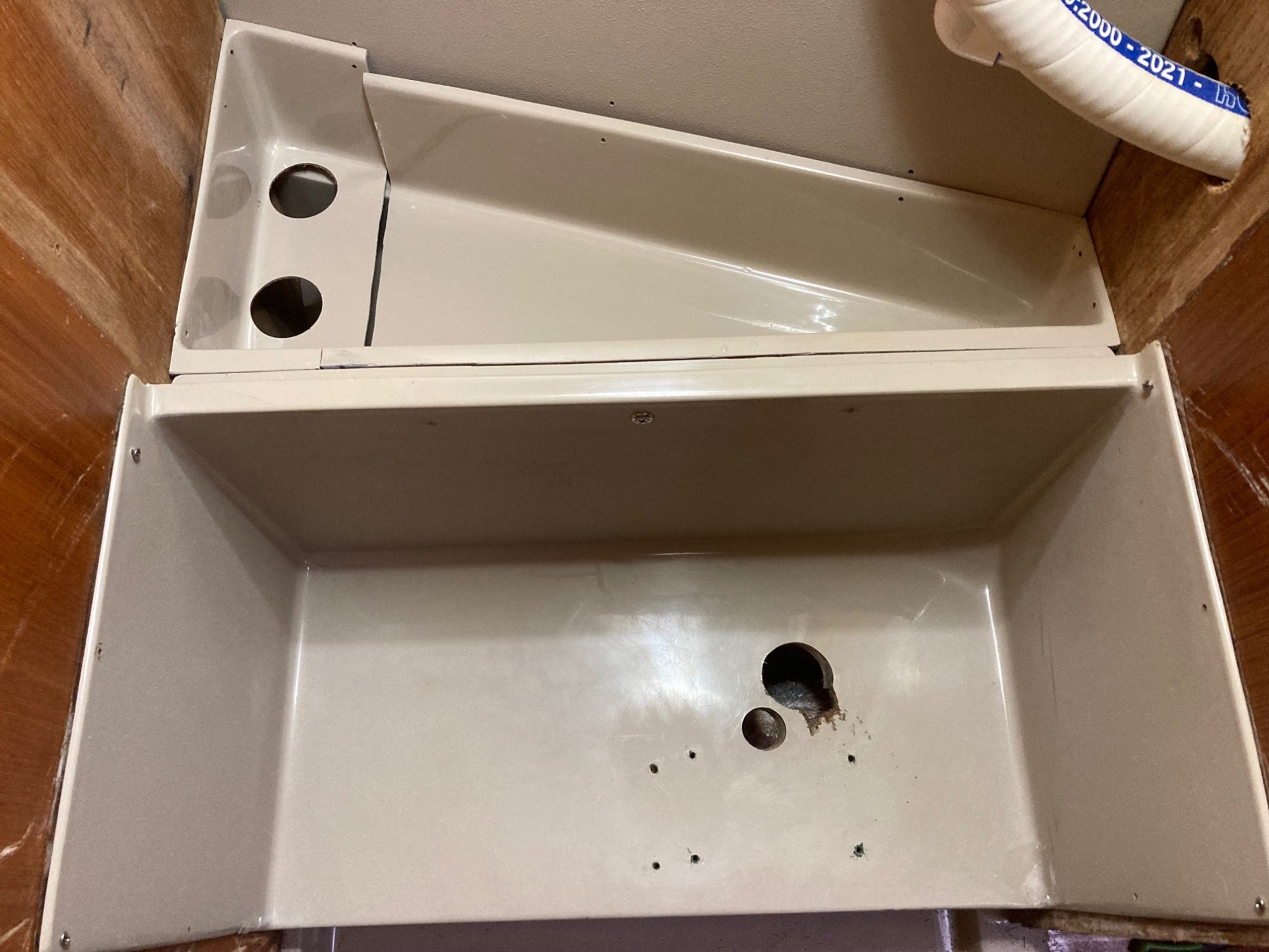

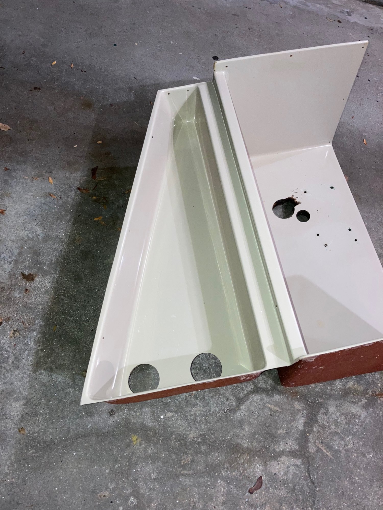

Bottom line, has anyone ever removed this pan before? If not, then I will document exactly what is under there.
