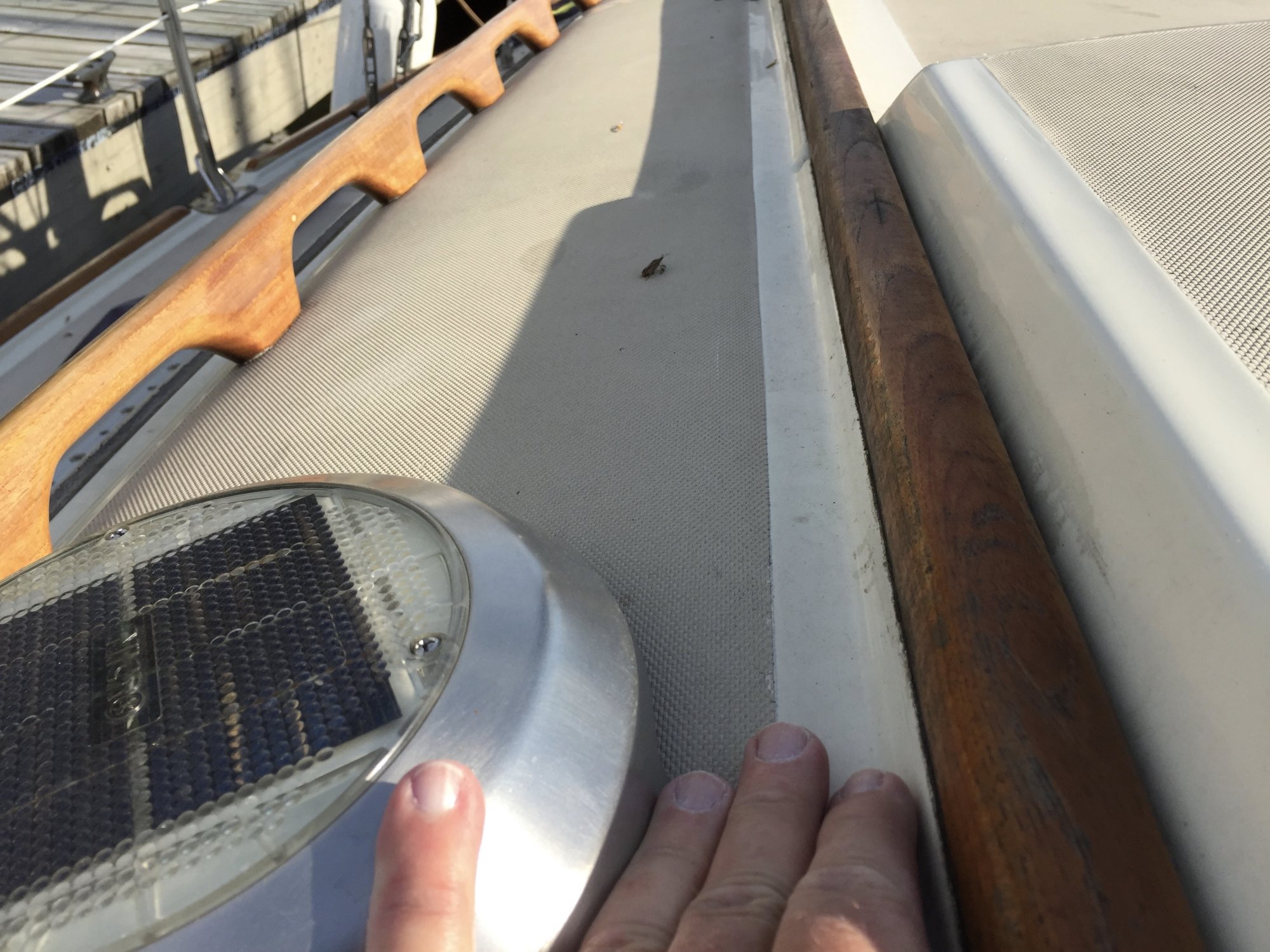

Do you have black bakelite squares that sit on the deck with rectangular wood handrail on top of that? my boat 34 was built in 83 and that’s how mine are mounted.
Aug 28, 2015
190
Oday 28 St Joseph, MI
No, my rails sit directly on the deck and are bolted through the rail “feet”, through the cabin top and through a similar but shorter rail inside the cabin. Pan head 1/4x20 machine screws go through it all into a nylock nut. Nut and bolt head are buried in the plug holes which are then plugged. I like the idea of yours, looks like about 1” square or so. That would be easier to drill up through from inside the cabin. Is that original?

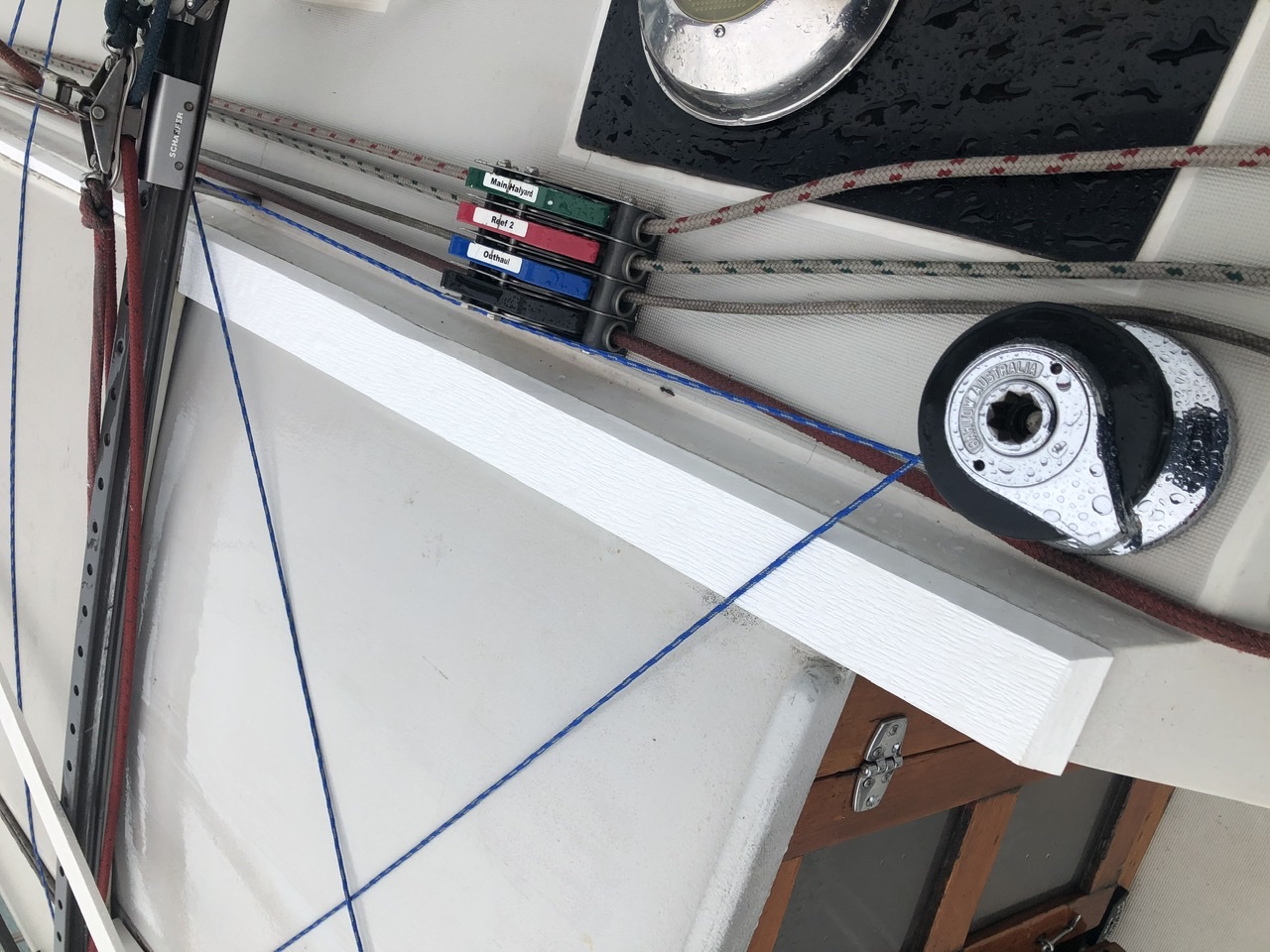

I hate to admit it, but I removed the teak hand rails and teak trim that held down the slider, and replaced them with PVC “wood”.... no more sanding and varnishing in my future!

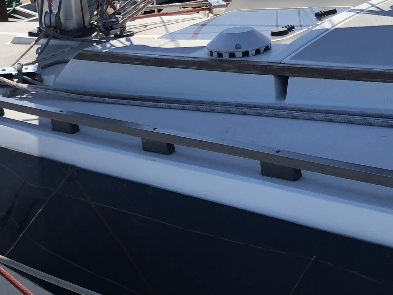

Stainless steel is also an option, like this - 34 Handrails.
