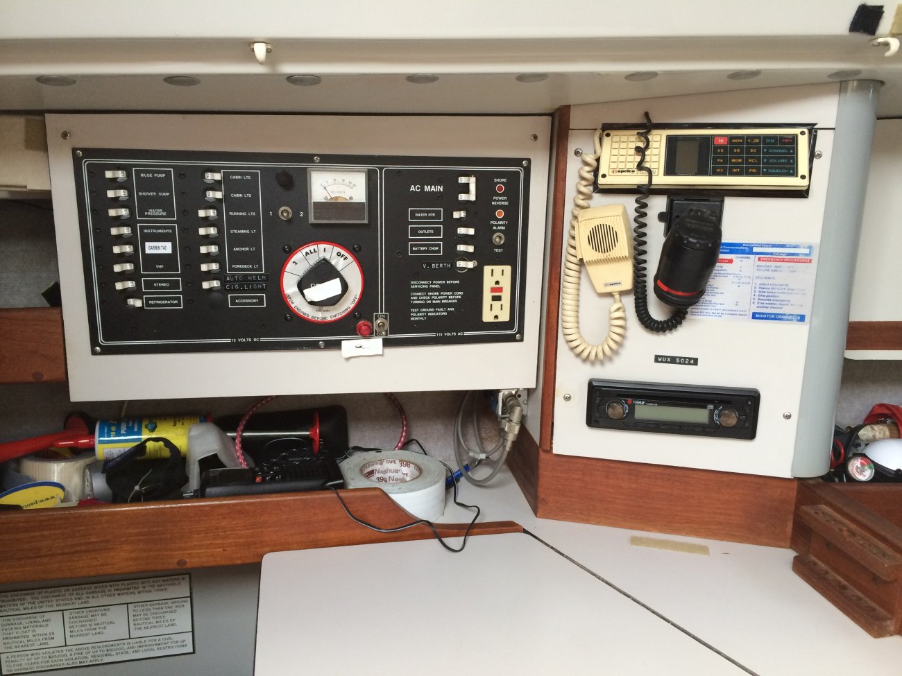

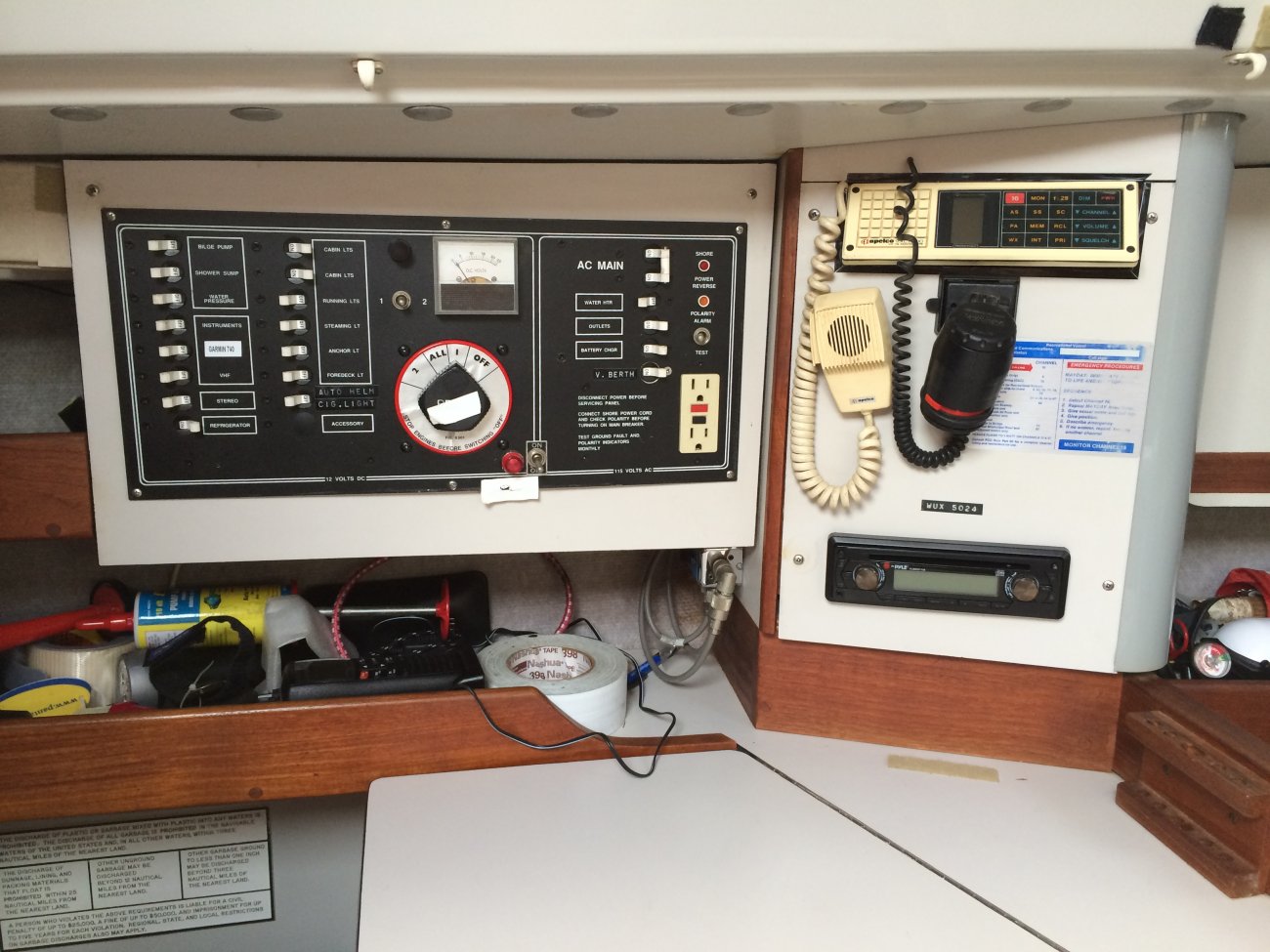

I have a 1988 O’Day 322. Not sure how similar they were built...
My battery charger is located on the bulkhead in the port lazzarette. I have a breaker on the AC part of my electric panel that turns the battery charger on and off. You can see it on the right side of the electrical panel.
My charger is hooked up to charge both batteries, regardless of how the 1-2-Both-Off switch is set.
