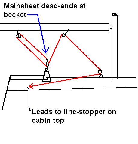

Catalina 22 Seattle
We have a nice selection of Garhauer, Harken, Schaefer and Lewmar blocks, a typical 4:1 purchase would be fine for that boat, that would be a fiddle block, and fiddle block with becket and cam cleat. The vang you could go down one size, and 3:1 purchase, so a single block with becket, and a fiddle/cam:

1,956
Oday Day Sailer Wareham, MA
Here is the original rigging setup for the 272, I don't know the part#s though. D& R Marine is a good source for the parts and Rudy Nickerson (owner and parts expert) will know the part numbers for all. He was Parts Dept Manager at O'DAY from 1973-89. (508) 644-3001 www.drmarine.com Main Sheet is 37' or 3/8" Double-Brain Polyester (OEM line was New England Ropes XLS-Blue) He sells Gauhauer and Schaefer
