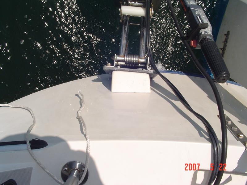

I think that it's doable. The reason I say this is because I helped a friend of mine deliver his 1986 O'Day 272 up from Cape Cod to the Bristol RI area years ago and this boat had an outboard that pushed it quite well. I think it was a Yamaha 15 HP I'm not sure.

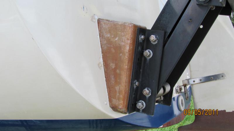

You'll probably need to install some kind of a backing board with metal plates inside the transom. You'll also need a block of some kind to mount on the outside transom. These are difficult to find and I'm not sure if D&R Marine carries them, but it's worth checking out. http://www.drmarine.com/ If worse comes to worse, you can probably construct one out of Fiberglass or even wood.

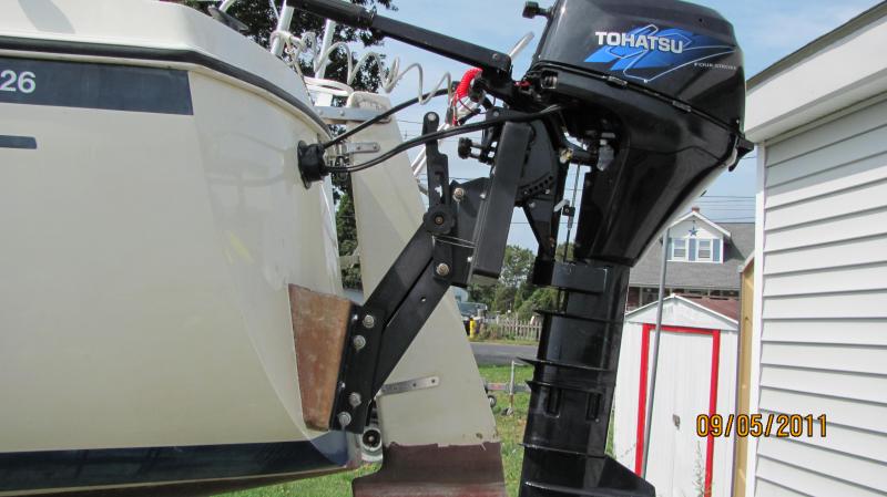

My friend Ray built one out of wood for his 86 O'Day 26.
Of course, it goes without saying that you'll need a heavy duty outboard bracket.
It might not be a bad idea to check the thickness of the transom somehow. If you don't think it's thick enough to take the weight and thrust of a four stroke outboard, you can always beef up the inside.

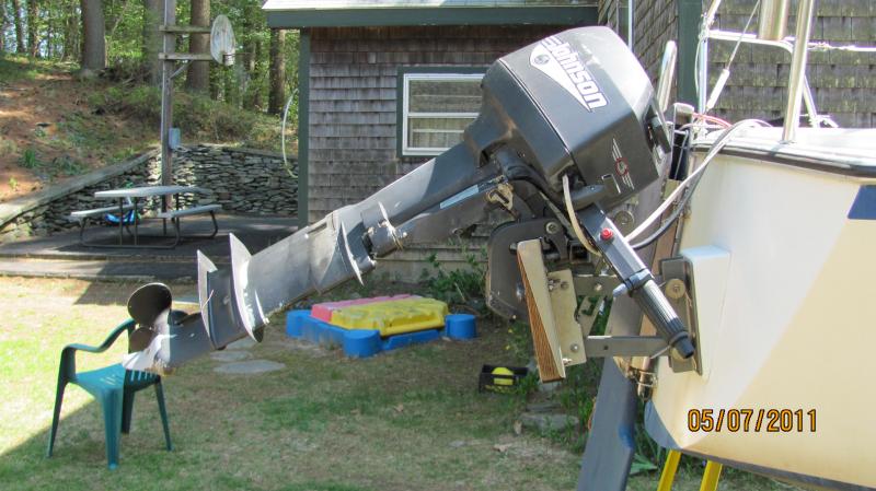

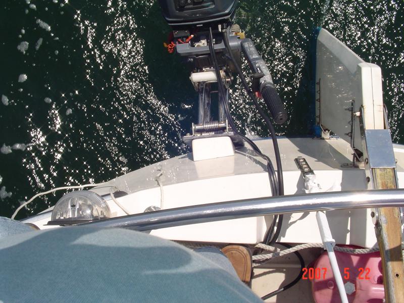

I have some pics of the engine block on my friend Mike's O'Day 272 and I also have some pics of Ray's O'Day 26 with the wood engine block.
Ray used two solid pine blocks to make his engine block. There's some stuff out there right now that's even better than wood. I've been using Trex on my boat and I'm in the process of building a mast plug extrusion with Trex and PVC Foam board.
Someone on this forum was constructing these blocks. I don't know if the guy is still making them. Perhaps he or someone else will chime in for you.

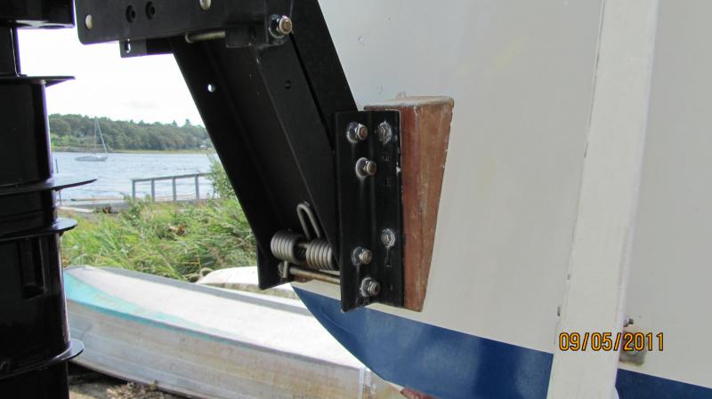

Joe, i understand the block / wedge used on the transom is to offset the slope of the transom for the outbard mounting bracket. But why does it go past 90 deg?(tends to face down toward the water) is this to provide additional clearance for tilting motor and not hitting transom? Just curious cause i'm contemplating doing this with my 28.
Jan 24, 2005
4,881
Oday 222 Dighton, Ma.
That's a good question. I really don't know. Of course, this isn't a factory block. Ray built this one out of wood and he fiberglassed it.
It would seem a little more logical if the bracket surface of the block was a little straighter up and down in relation to the waterline, or more of a 90 degree angle to it. I'm pretty sure that Ray used two blocks side by side on his boat to mount that engine bracket. My block seems to be pointing down a little on my boat too.

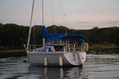

Joe, I think that may be the "nature of the beast", the aft berth was probably designed based on the boat sitting on her lines, however like someone said about the O'DAY 23 (or was it 26?), the boat seems designed to sit on her lines with the usual crew in the cockpit. When everyone turns in for the night..... the crew weight moves forward. This is common on all boats, I can remember seeing a boat one morning as we were leaving the harbor, she was definitely "down by the bow" which I didn't have much trouble assuming that to be due to the ocupants still being asleep in the v-berth.
Long story short, If you look at the picture of an outboard 272 in the sales brochure (see below), the stern is floating high (higher than "normal" due to the fact that O'DAY shows her with a fairly lightweight, 56# outboard, and if there is a fuel tank aboard, it is most likely only a 3 gal. since that was standard for the 8 hp in 1984).
The 272 that moors in our cove in Wareham has the Diesel option (she is a 272, not LE) and quite frankly.... I just realized that she sits the same way on the mooring, slightly up in the stern. I should have thought of this yesterday when I posted my balance estimate, but sometimes my memory gets fuzzy on details like that. I wish that I had a picture of my Neighbor's 272 now...... but you'll have to trust me on this one (I'll try to get a pic this summer if she is in the water.)
Your problem (and it is a serious design "OOPS!") with the reverse angle of the aft berth is due to the basic design of the 272 and has no real relation to the inboard vs outboard choice. Someone should have "sentanced" John Deknatel to spending a night in that berth as punishment<GRIN!> for his error.
I posted a pic of a 272 with an inboard to try to show the same floating angle, but all I could find were pics of the 272LE, and the 36# weight of the pedestal steering system would make a difference.
