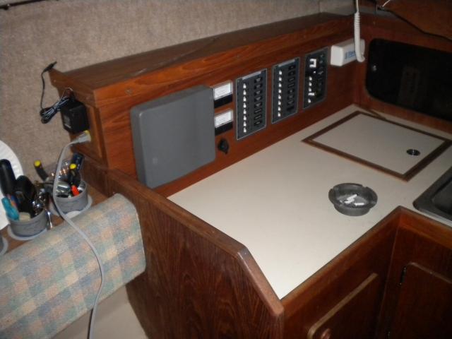

Check out my self installed custom electrical panel located behind the icebox on the port side. I used all Blue Sea Systems products for the installation.

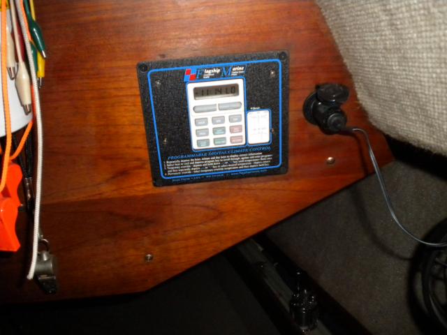

This 272 never had a stove installed from new. However, The AC Panel has a circuit breaker for a microwave oven. The microwave oven will fit on a folding, drop down shelf on the port side of cabin, on a shelf directly in front of the midship storage cabinet. The AC wiring to a grounded duplex outlet is already installed. The photo attached is of the origonal location of the DC power panel now replaced with the new digital thermostat control for the air conditioner/heater unit

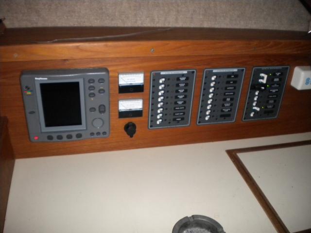

I am very impressed....the installation is beautiful. It makes your boat look cool, but what could you possibly hook up to all those switches? Is this the latest style in Waukegan, IL? It looks like a computer keyboard.

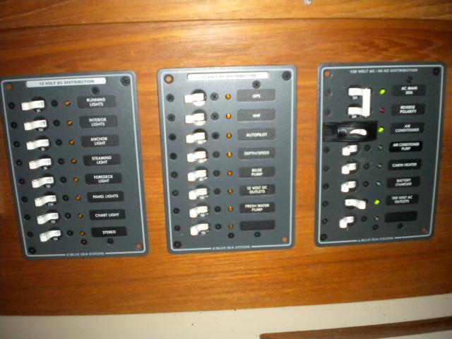

Thanks Bob. I found many things not protected by circuit breakers. I used some 1 Amp breakers for delicate electronics such as the Raymarine auto pilot, Depth sounder, speed indicator, etc. All of the other breakers were sized to be 30% to 50% higher than the actual load current. It is silly to have all 15 Amp breakers. That's the best way to fry delicate instruments.

I didn't feel it nesessary to attach the panel to the hull. I used a 3/4" piece of marine plywood, mounted it by #10 - 1-3/4" long sheet metal screws thru the storage shelf (the unit with the plexiglass sliding doors). On the other end I built a side panel that followed the curve of the inside of the hull and then used a couple of teak mounting blocks and #10 - 1-1/2" long screws. The top of the electrical panel was made out of 1/2" marine plywood. I built the top panel also following the curve of the hull. After many, many hours of fitting the panel parts to the top of the counter I cut out the holes for the Blue Sea Systems AC/DC panels, VHF radio, Analog gauges, and Raytheon 530C GPS. Then after the final fit was perfect I covered the outer plywood surfaces with 1/16" teak veneer. The top shelf was covered with Wilson Art Formica teak veneer. This process took me approx. 200 hours. I have removed the electrical panel a few times by removing all mounting screws and tipping the panel forward and laying the panel on top of the ice box/counter top. Would I do it again? YES! I found this installation much easier than than my Air conditioner installation.

That is a superior job bria. I like the Blue Sea breakers acting as the switch with the LED indicators. I might just steal some of your ideas as fuses are best relegated to antiquity.
