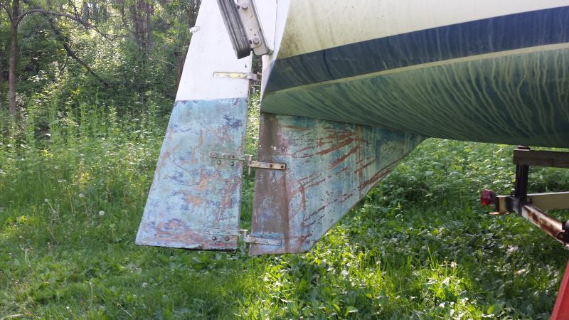

My question is this.... They removed the center board and added a skeg in front of the rudder. All of the modifications look factory but I am thinking about going back to the original rudder setup without the centerboard. I would leave it as is but I found some water intrusion on the bottom of the skeg when prepping for new bottom paint so I can either remove it and figure out how I want to fill the three mounting holes or I can sail it as is and repair the skeg if/when needed.
Has anyone ever seen a setup like this before? Do you think that the Skeg would help when sailing upwind without the centerboard down? (not that I am concerned with that)

I see no reason for the skeg. The skeg will also restrict your ability to use your outboard to steer into very shallow areas with your rudder removed. The original rudder is all you need. I know. I have the same boat. On the other hand, in deeper water it will probably do no harm except to add some drag. More important is to add back the centerboard which is very necessary to do windward work (tacking) The centerboard is also a built in depth finder and when it drags on the bottom, depth is 6'. Then you can raise the centerboard, remove the rudder (it weights about 50 lbs) and crawl into about 2' of water. But you do need the centerboard to go to windward efficiently QUOTE=UPSNOWNINJA;1135981]I have a new to me O'Day 25 and the original owner has made some modifications. They used it as a Great Lakes cruiser and changed the interior to be more comfortable, ie, Pressurized hot and cold water, upgraded shore power with more 110v outlets, and on and on.

Your rudder has been bobbed. One problem with the oday 25 is that with the board up the rudder draws more than the keel and the boat will ground on the rudder before the keel. Ruddercraft sells kickup rudders that are direct replacements for the original. A kickup rudder will get around the grounding problem the PO avoided. If a kickup rudder is installed it is a good idea to install a prop guard to prevent the rudder engaging the outboard prop. This is what I did on my oday 25.

The skeg was probably installed to protect the rudder from a hard grounding.
The original length rudder extends below the shoal keel 3 or 4" so it is exposed and the skeg may protect it.
I do agree with chickadee that the rudder has been cut shorter.
As far as the CB, maybe he lost it, broke it or something like that. If he glassed in the CB trunk that could be a lot of work to open it up again. If it is still open, cost would be close to $1200 for new CB and hardware and that does not include the pendant tubes.
Actually, if he did all that work to improve interior comfort and it is an older model he may have done away with the CB so he could do away with post and crank that was in the cabin to raise the CB.
My day sails are rarely destination oriented so it is more common for me to leave the CB up than to lower it for greater pointing ability.
I would think having less rudder in the water would affect handling more than not having have a CB. I would go with a replacement rudder and remove the skeg.
IF the rudder was full length, then I would try it as is.

In fact, I think that the rudder is home made or from another boat. Take a look at the O'day 25 manual at this link. http://sbo.sailboatowners.com/downloads/Oday_25_17324134.pdf
The photo shows the rudder. Note how it is notched to extend under the transom, the bottom is angled and the leading and trailing edge above the notch are not parallel, the trailing edge
I understand that they changed something on the O'day 26 so the rudder did not extend below the keel but I am not sure that the change was.
I do know the 26 rudder is of the same design as the 25, just not sure of the length.

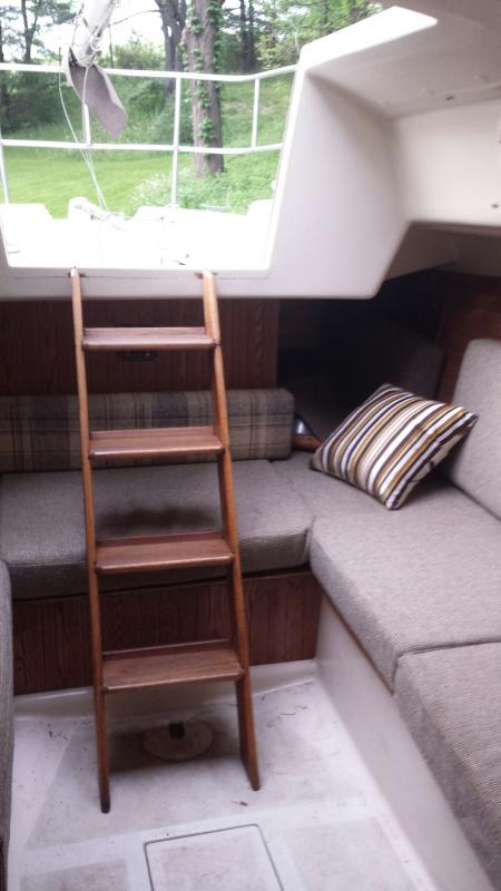

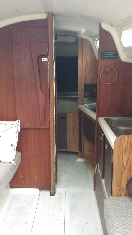

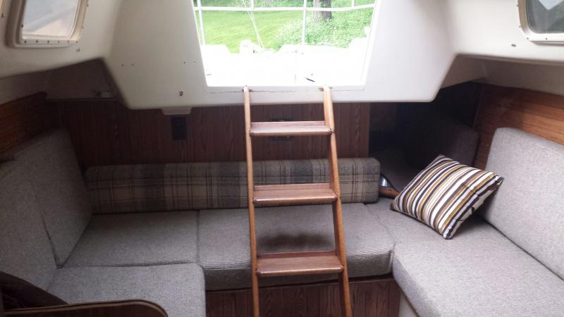

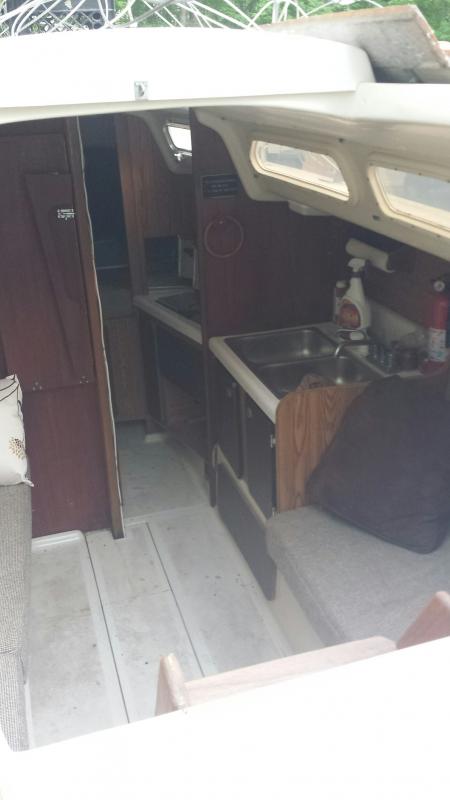

I am having issues attaching photos of the new configuration from my tablet and will have to try again tomorrow. Basically the original galley has been converted to a U shape seating area that can be converted into a giant bed if needed. The sink in the head has been changed to a alcohol burner with a microwave below. The dual sink aft of the bulkhead is a 12 volt pressurized and I have a 120v water heater underneath. I haven't had a chance to try everything out on the water yet but I like the layout.

Nice setup. Like the ladder. Sounds like you are getting close!

Looks like the main salon is more open than the original design. I like it. I also like the wood along the sides of the main cabin which replaces the carpeting. I may try that at some point. I'm curious, where did the panel get moved to? Anyhow, I would post pictures of that modified cabin and also the skeg on the owner modifications page of this site.
As far as the skeg is concerned, it does serve a purpose so you may want to consider fixing the leak and keeping it. I don't think it will help much with upwind pointing though. The CB goes down another 3' 9" to give a 6 ft draft. If pointing is not a huge deal, you could always hang onto it, or post it for sale on the SailboatOwners website. Someone will eventually need one of these and you can always invest (that's the terminology I always use with the admiral) the money you get for it in some new sailing toy. One thing I would check is for water intrusion on the lower pintles of rudder since they are below the waterline.

The 25 was not designed to have that skeg so you were correct to remove it. Adding that much fin area so far aft would adversely affect the balance of the boat and increase "Lee Helm", especially without the lowered centerboard. I would think it would have made the boat harder to turn as well. If you added a mizzen to the boat to make her a yawl or ketch...... the skeg might help, but with the standard sloop rig on the 25, the skeg would seem to move the center of lateral resistance (center of the area of "keel" that prevents leeway) too far aft of the center of effort (basically the center fore & aft of the sail plan) to balance correctly. Of course... if you never used the jib.... that balance might not be too bad? Or if the mast was raked aft excessively....?
