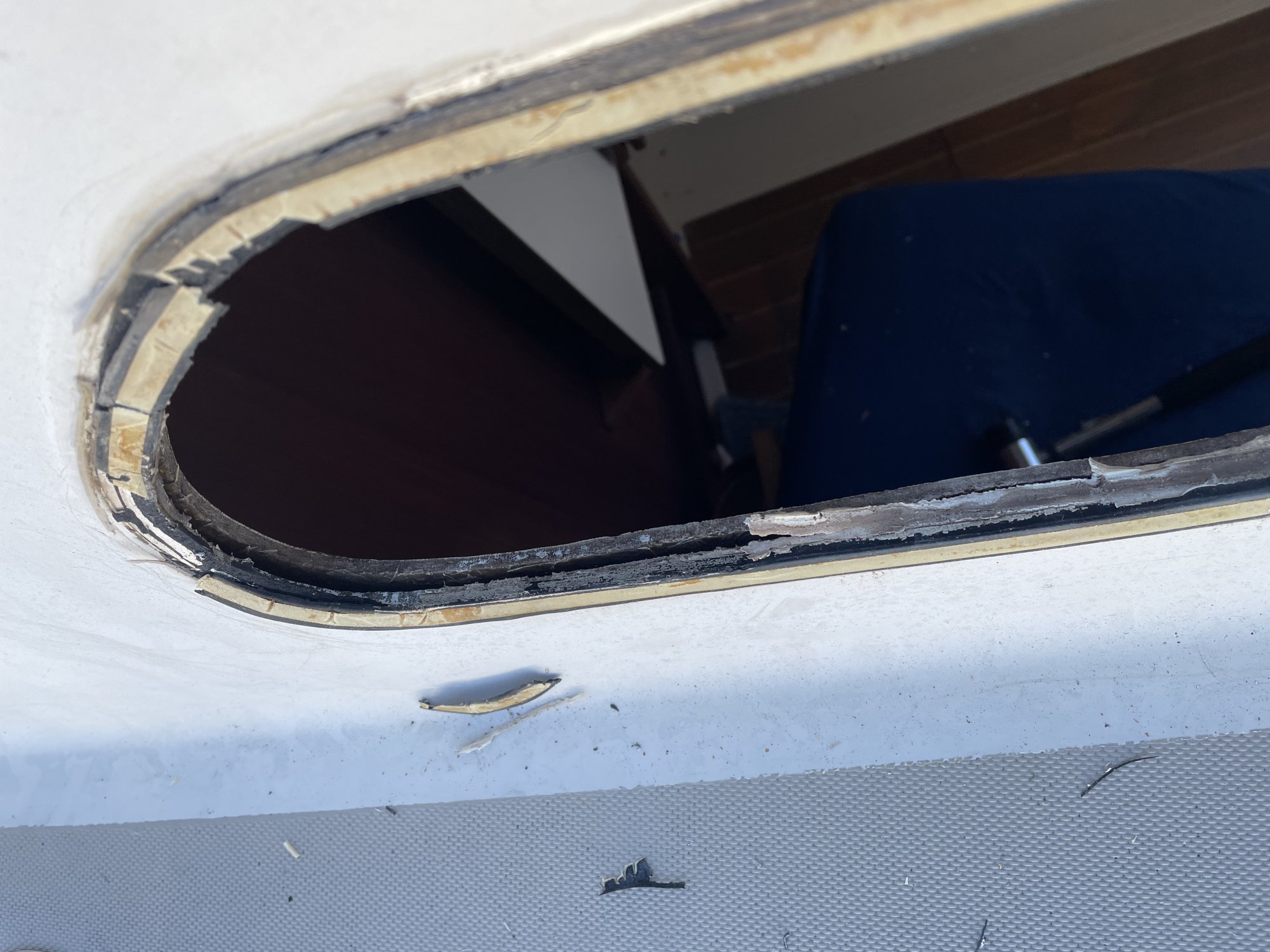

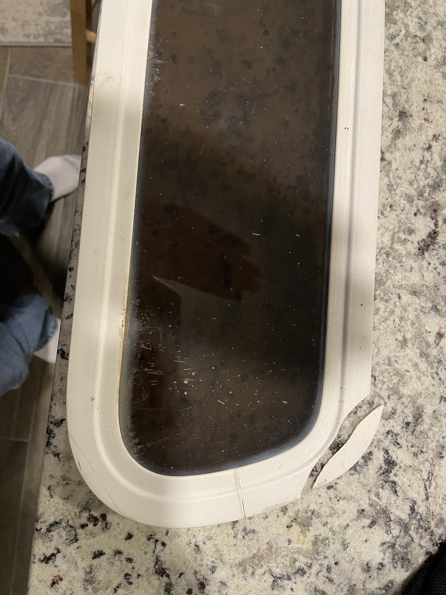

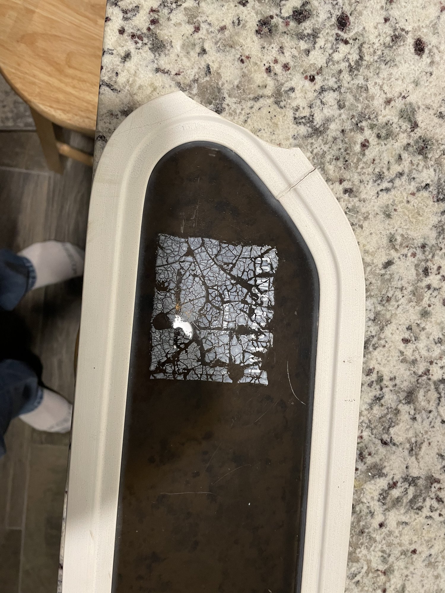

So attached is the old frame with the one broken piece missing, and a view looking in the window seal with both pieces of fiberglass. Initially, I was going to superglue the broken piece back on and the reinstall the port light, but when I dropped it and got the second break I’m not sure.
If I were to go acrylic, I’d have todo something with the current windows that are hidden by the frames.

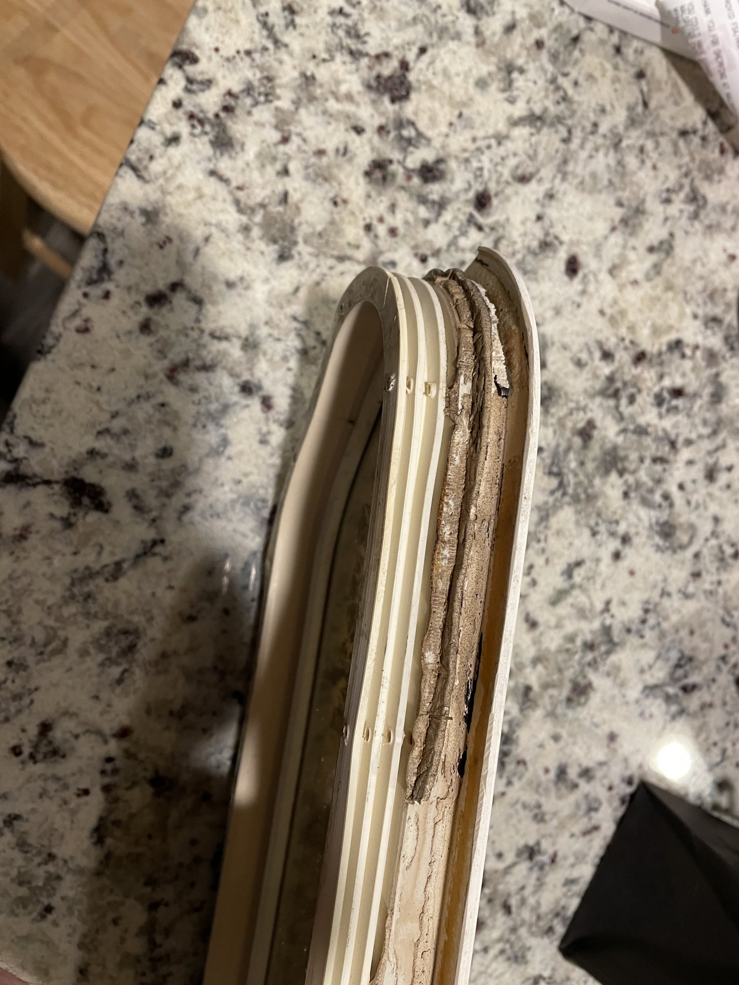

the last picture shows remnants of some sealer that was there. It didn’t look like it was entirely around the frame, but between the lower “sill” of the window cutout.
the last picture shows remnants of some sealer that was there. It didn’t look like it was entirely around the frame, but between the lower “sill” of the window cutout.View attachment 200589View attachment 200590View attachment 200591View attachment 200592
