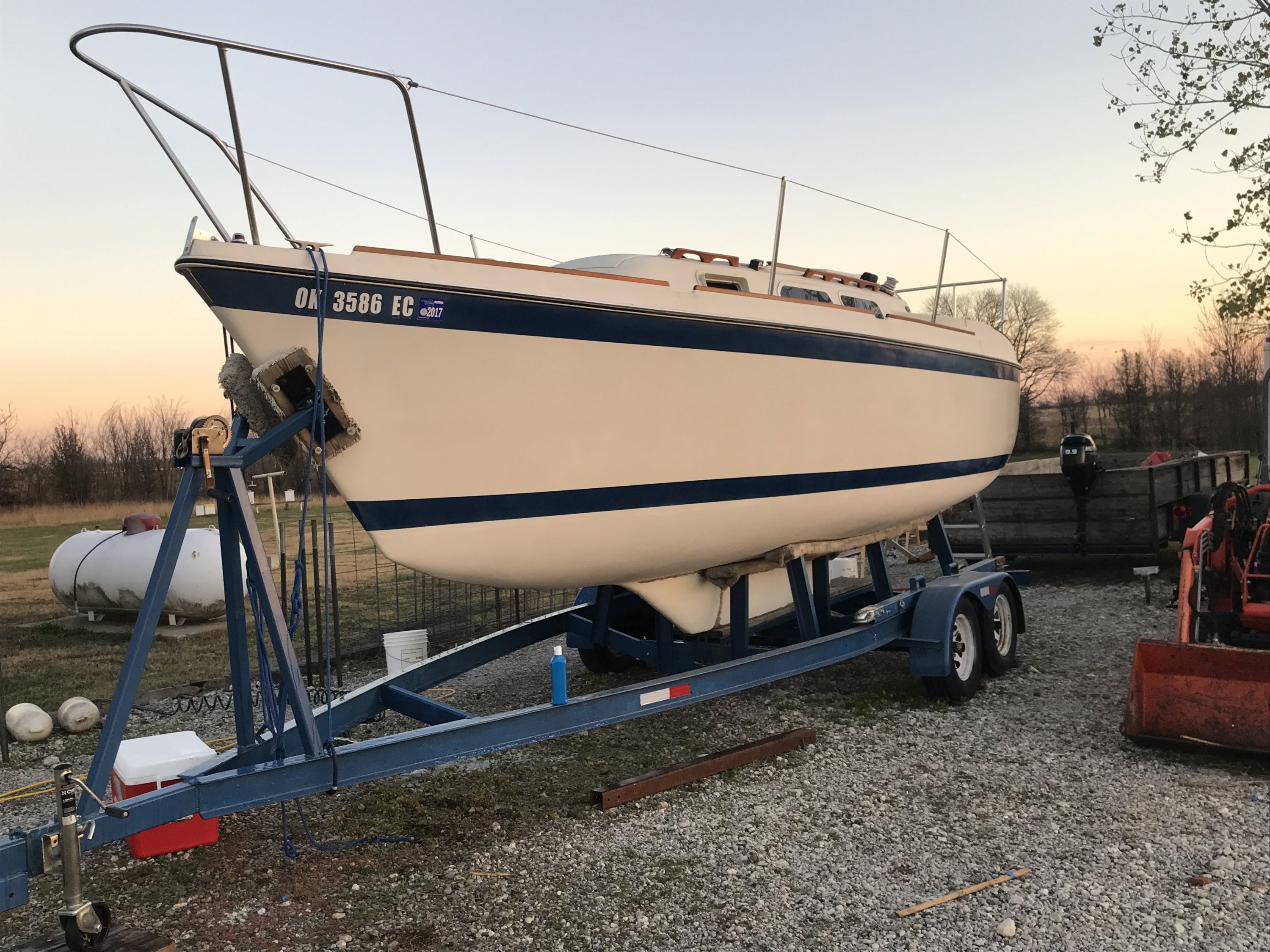

I'm working on the new boat. She's a 1928 Oday 25:

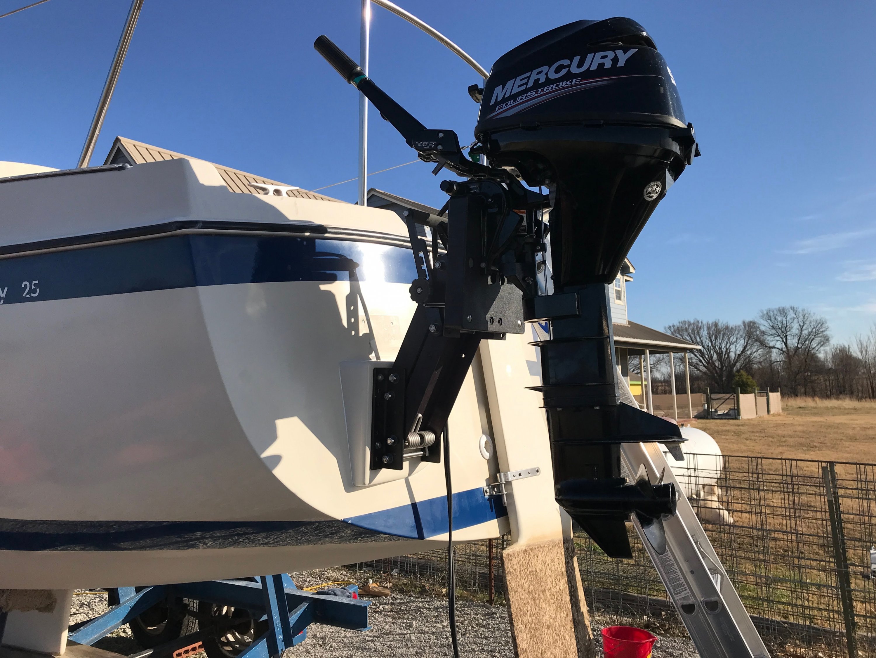

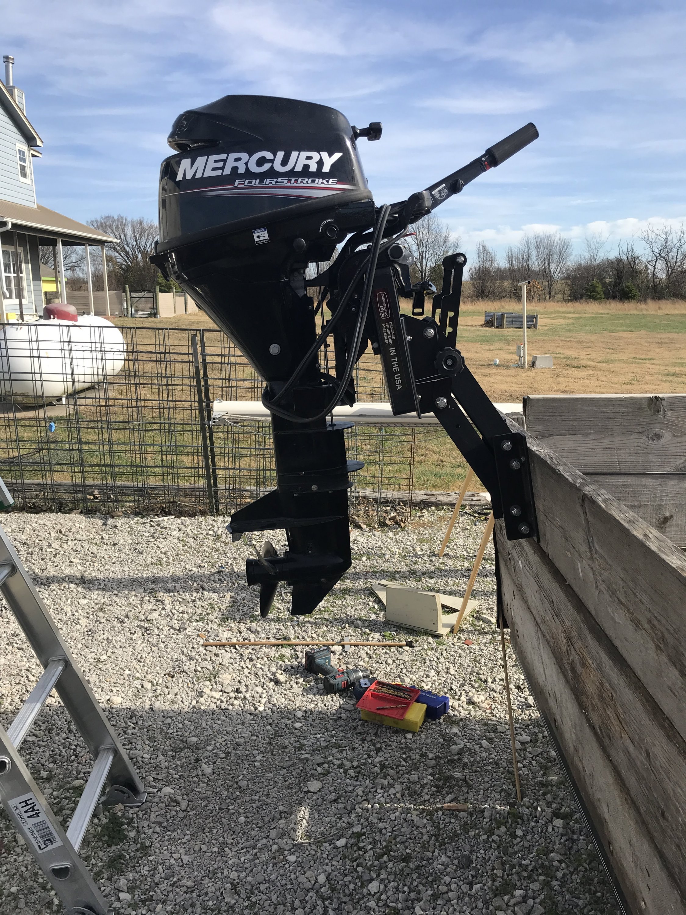

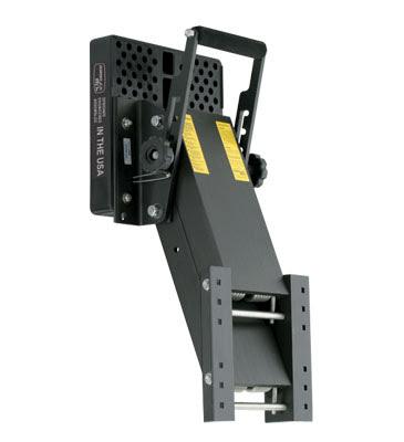

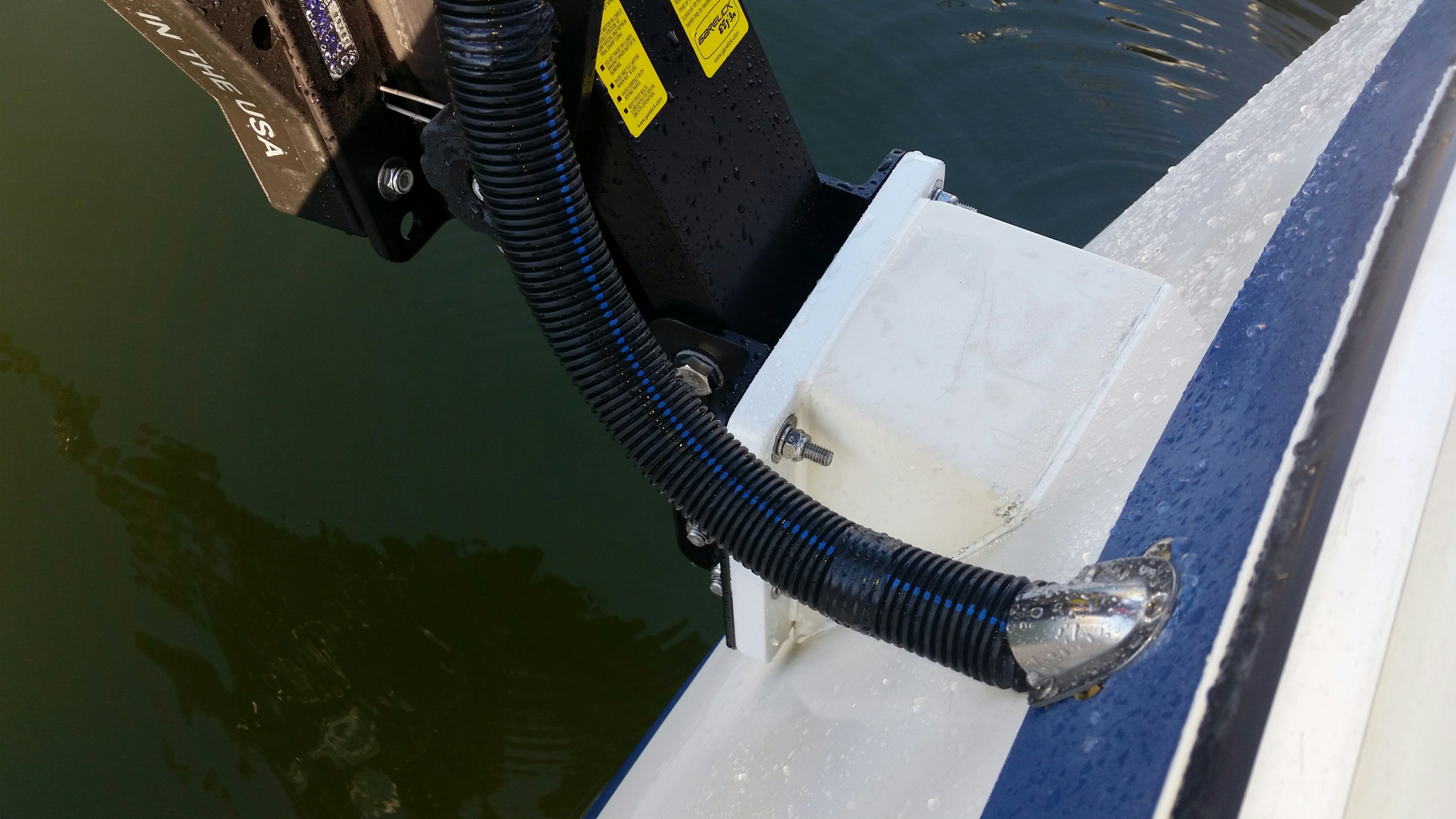

The previous owner of my 1982 25 was kind enough to replace her outboard with a brand new 9.9hp mercury. Unfortunately the new motors weight exceeds the capacity of her original Garelick mount. I purchased a new mount (model 71091) to better stabilize the outboard and support it’s weight.
Photo [Outboard mounted on new Easy Lift, bolted to rear of flatbed]
Photo [Garelick 71091]

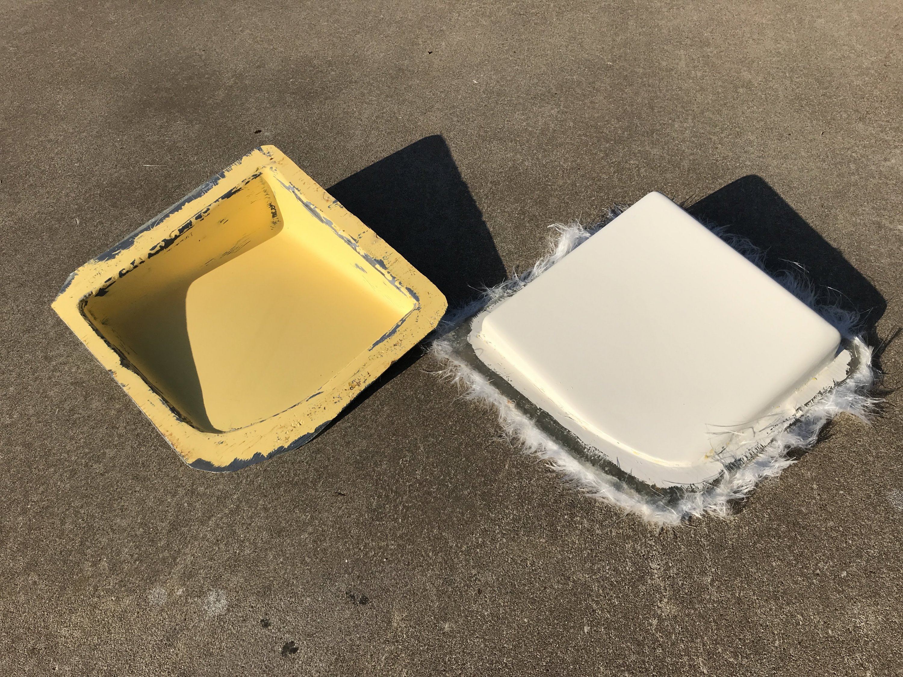

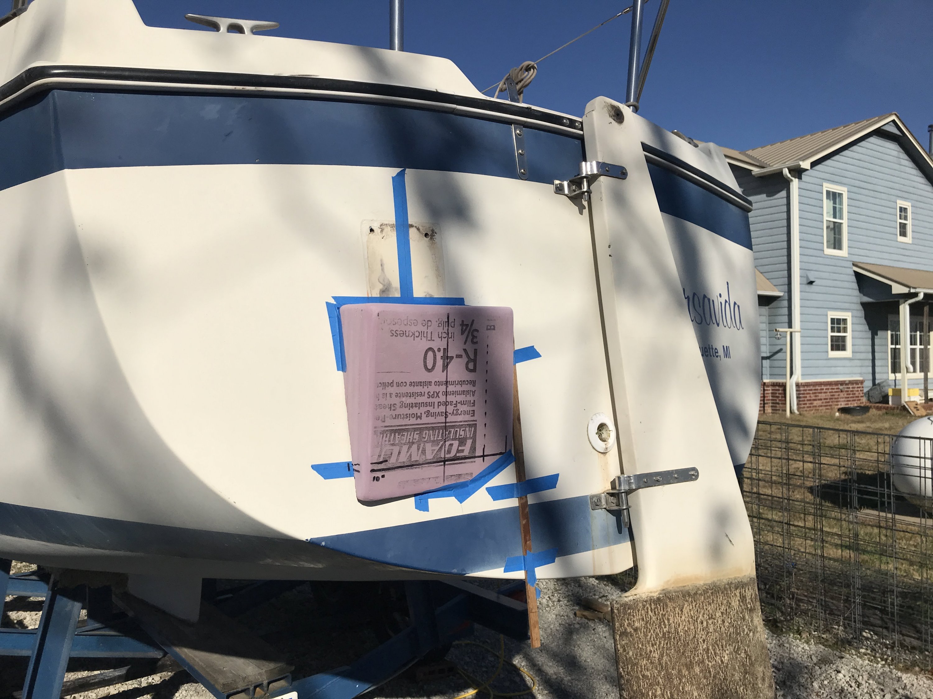

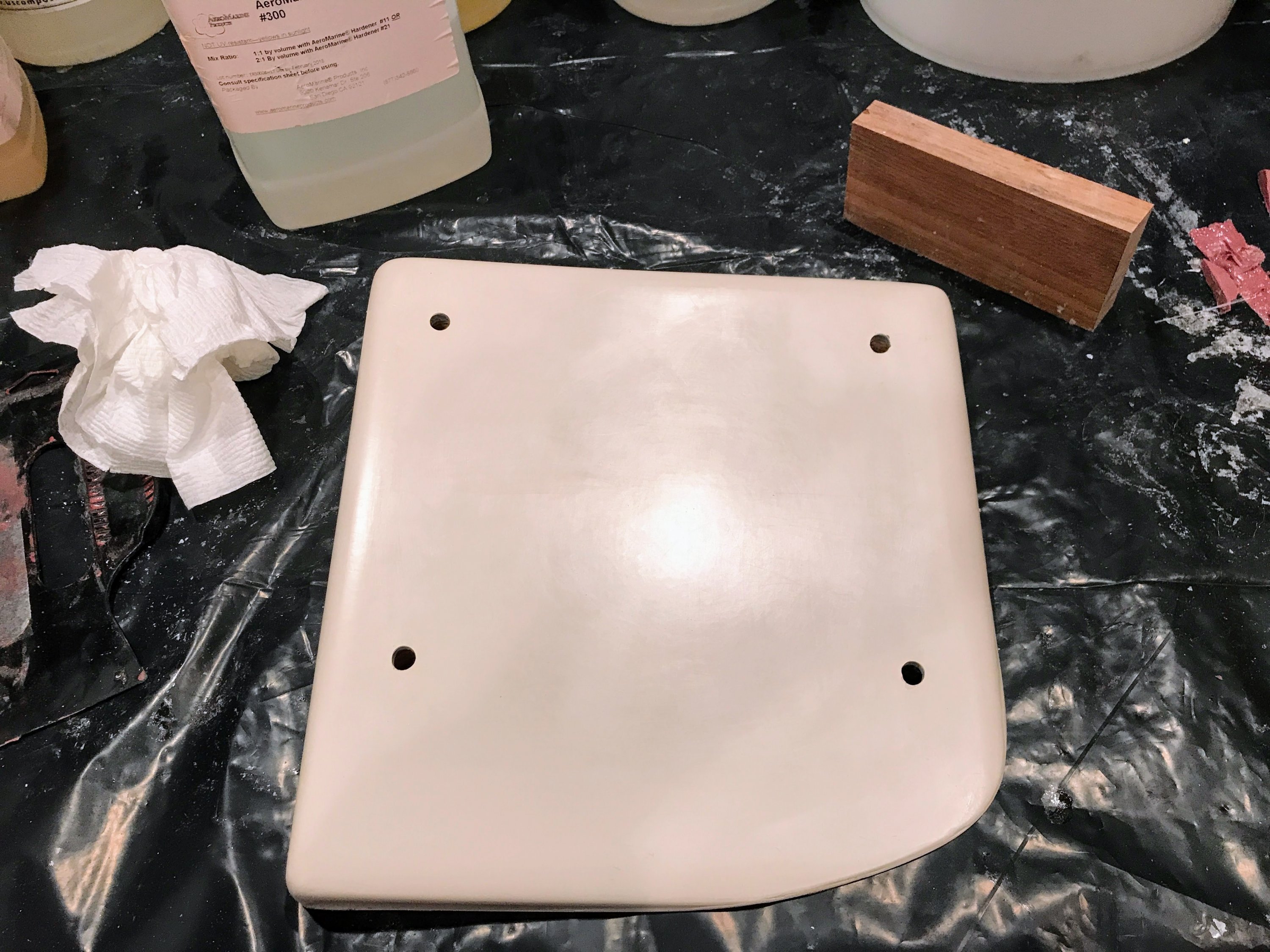

The 25 has a reverse raked transom which requires a wedge to correct the angle of the outboard prop. The original O'day wedge has too small a footprint for the new Garelick mount with its 10"X10" bracket. I've removed the original part and molded the new fiberglass/gelcoat shell for the replacement.
Photo [Foam mock -up of replacement wedge above. Its only got a few degrees of positive angle. I'm trying to strike a balance between prop angle in the water and lifting angle to get the outboard up. The old bracket was darn near impossible to lift at all. Had to tilt the outboard to get the lower unit out of the water and left the undersized bracket down.]

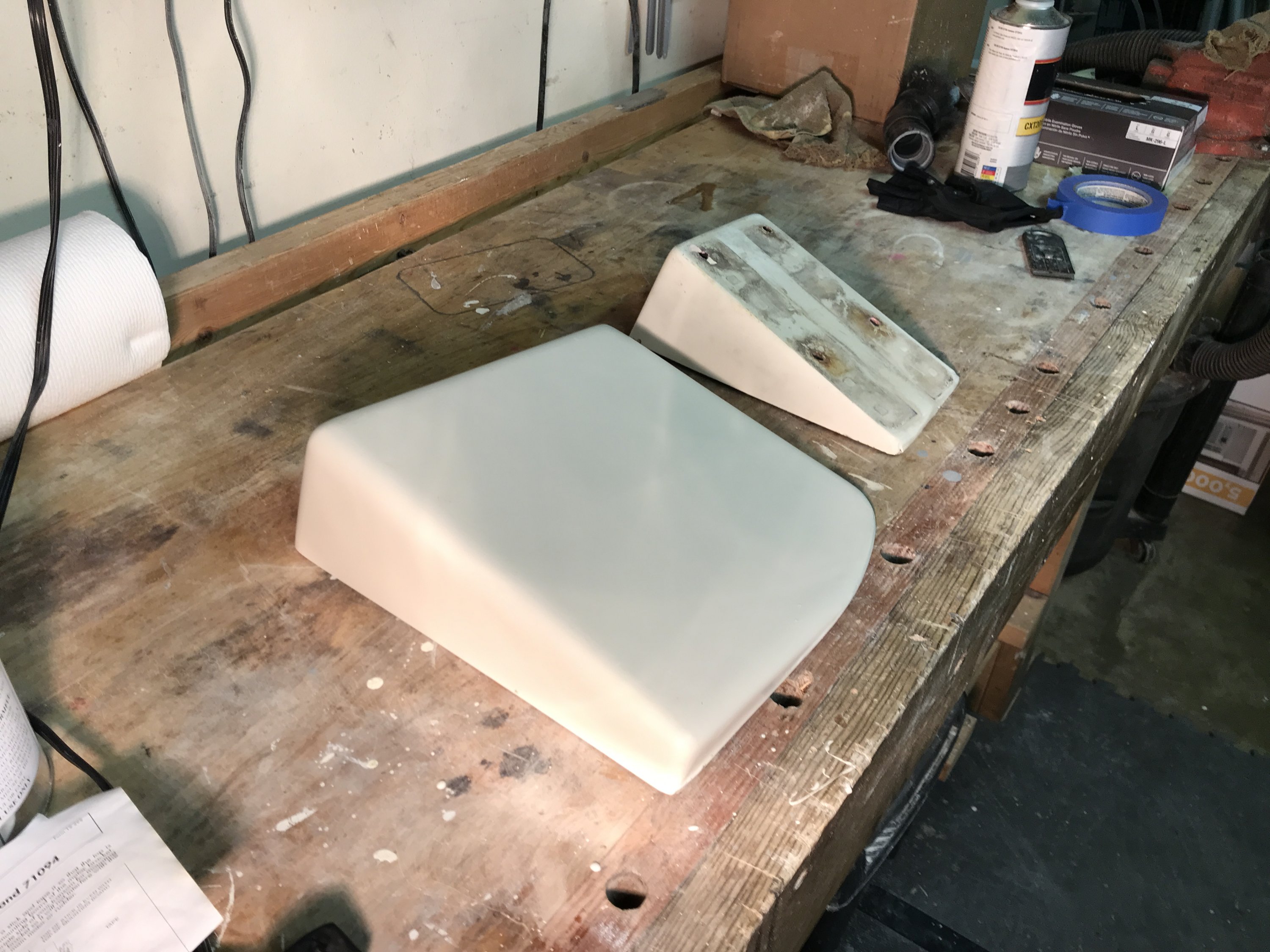

Photo [The yellow mold I made for the new wedge next to the final shell with it's pretty gel coat. FYI, I think I found a good recipe for tinting gel coat to match O'day off white. Holler at me if you need it.]
Photo [The new wedge next to the old.]

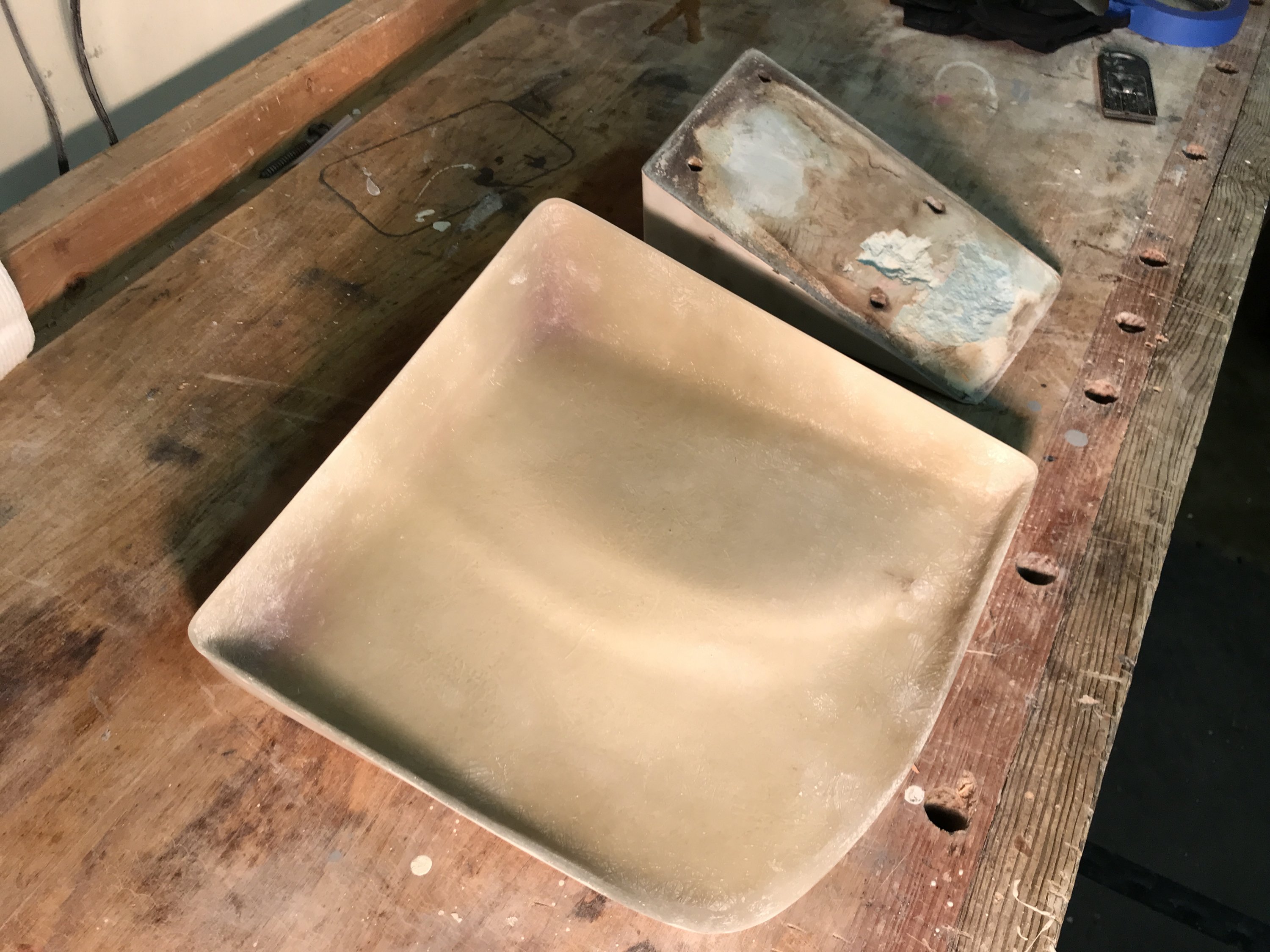

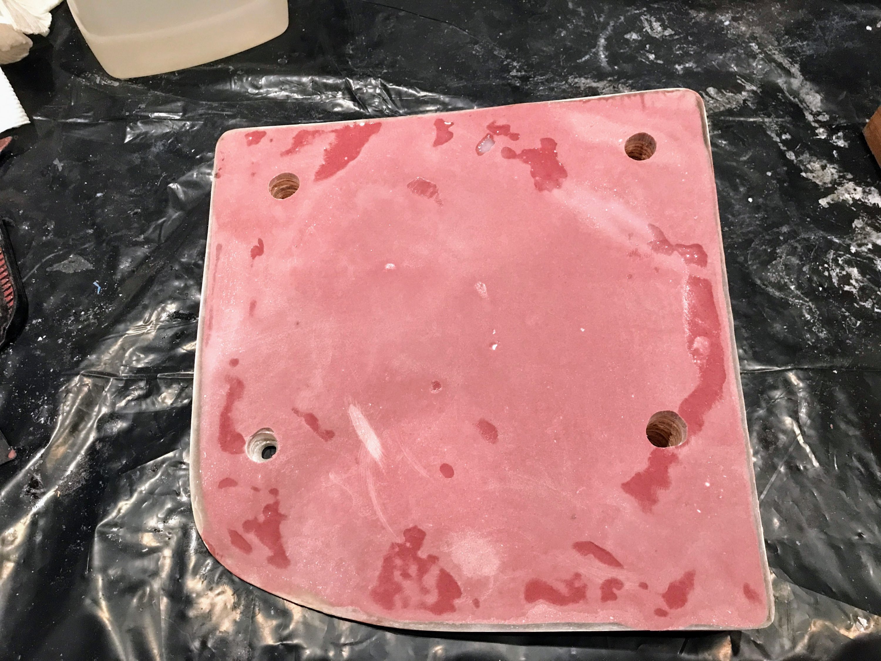

PPhoto [Inside view of the new wedge. Not the rubber filler on the inside of the original unit. I had a better picture of the inside of the old one, but Apple changed it's photo format just to mess with me and I can't post it on the forum.]

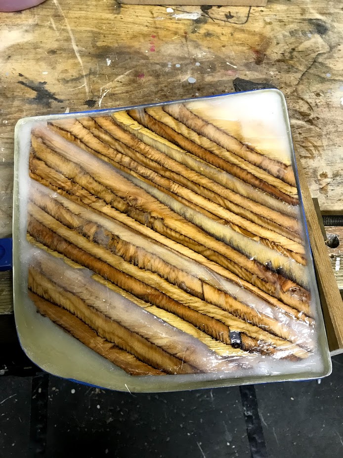

I'm at a crossroads regarding the filler material for the new wedge. The original was filled with some kind of mysterious hard rubber of unknown pedigree. Does anyone have any suggestions what this might be?
I've thought about filling with epoxy or poly resin but I'm already concerned with the weight of the motor/mount/wedge/transom reinforcement combo. I'm also concerned with the exotherm of such a large pour getting dangerous or ruining the shell... aaaaand epoxy ain't cheap in that kind of volume.
I've already cut and shaped some marine plywood that I could epoxy in, but I really don't like the idea of wood so close to the waterline. One point of moisture entry and the core will be rotten and all this hard work down the tubes.
Photo [Yucky wood core option.]
There's a seller of gallons of RTV silicone online that has caught my attention. Any thoughts on using it as a filler rubber? Will silicone properly bond to the poly resin inside surface? If I go this route I'll test it in a sacrificial shell of the same material before committing to pouring into the actual wedge, but I'd love to hear what you have to say before I spend the money to have a gallon of silicone shipped to the house.

That looks amazingly sleek and professional! I'd add a solid fiberglass buildup or wood, silicone will have compression and cause cracking. Also since you are going through all this effort you will need to beef up the transom which I've seen others do with wood, aluminum plate or aluminum angle.

I wouldn't use the silicone. I would be worried it was not dense enough to not compress when you tightened the mounting bolts.
I would go with the wood insert. Lay it into a bed of epoxy, fill the sides and coat the back. Then drill the correct size mounting holes from the front. Turn it over and drill the wood mounting holes over sized. Don't drill through the fiberglass shell when you do this. I would go 1/2 over size. Plug the fiberglass shell holes, fill the over sized holes in the wood with epoxy, then drill the epoxy filled holes to the correct size.
The water won't get to the wood and the epoxy will act as spacers.

Thanks Ward and John. I just got a callback from the folks at Silicon Depot and they agreed with your assessments. The silicone will be too flexible for the application. Whats called for here is some kind of a rubber compound that pours as a liquid and sets up as a solid. Now if I could just figure out what that mysterious product is...
I'm starting to get more comfortable with the idea of lining the cavity of the wedge with the sheets of resin soaked plywood and burying them in a cabosil thickened bed of resin to create the core. I've done a considerable amount of deck core replacement projects in the past, Ward, and agree that potting the bolt holes with epoxy is definitely worthwhile. Although it's likely that the wood core will happen, I'm willing to wait a while to see if the hive mind has any other hard rubber suggestions.

I "fixed" the wedge on my Oday 23 by scraping out some rotten core and replacing it with epoxy-saturated plywood. No problems in 10 years. Coincidentally, this summer, I had the same outboard/mount/wedge replacement issue as you do. Instead of building a new wedge to support the wider mount, I designed this "adapter" out of G10. Much easier and cheaper (at least for me).

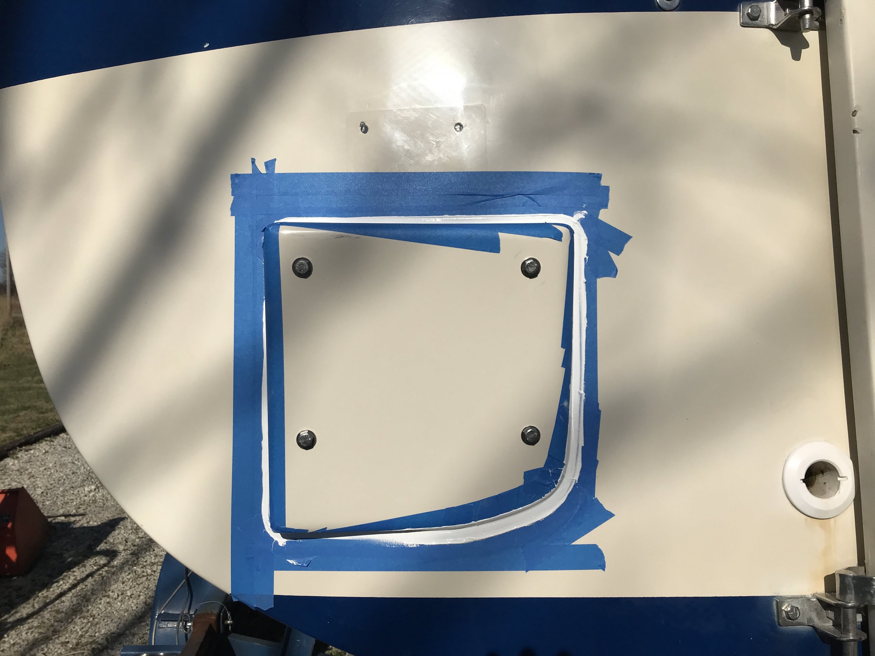

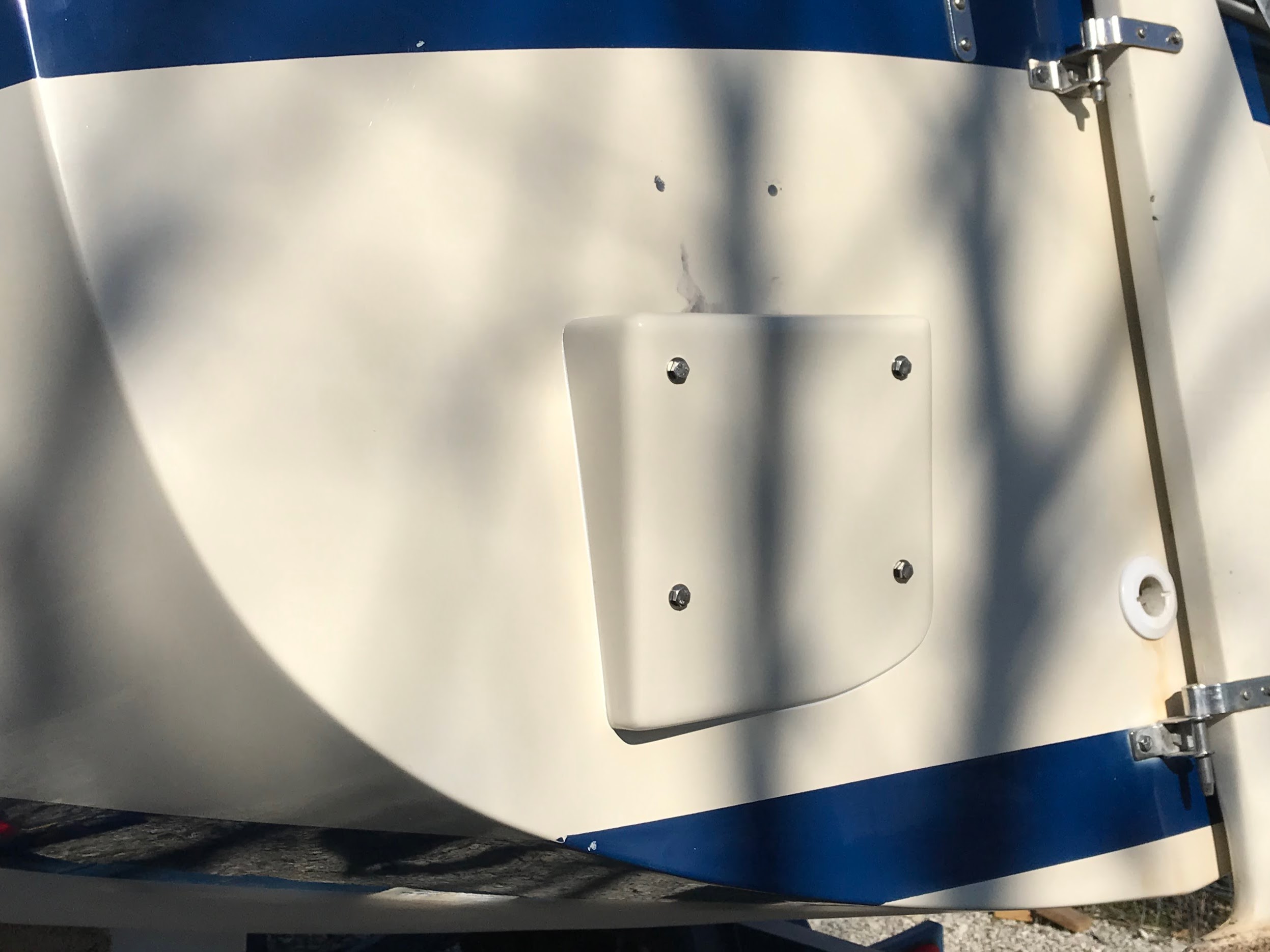

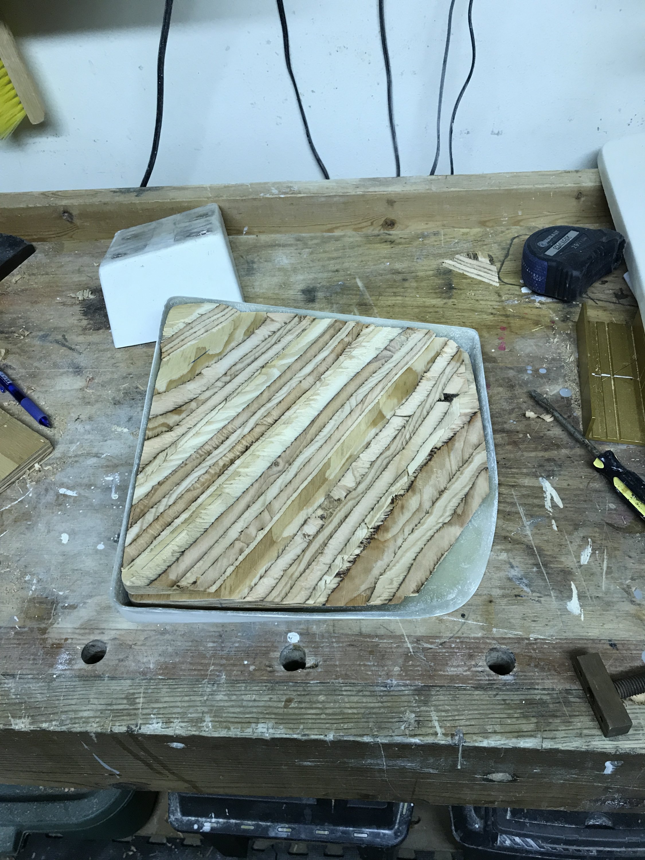

I know it's been a while, but I thought I'd do an update on the motor mount project. I went ahead and filled the inside of the shell with marine plywood set in a bed of epoxy. It took a considerable effort to cope the plywood to the right shape for the convex curve of the transom, but eventually I got something that worked.
I smoothed the back of the final product with a hardened fairing compound composed primarily of cabosil with enough fairing compound to make it workable.
I then overdrilled all the mounting holes and filled them with solid epoxy to hopefully prevent future water ingress. The final product is bedded in 3M 5200 and throughbolted with backing plates.
Thanks everyone for your help and suggestions... enjoy!
