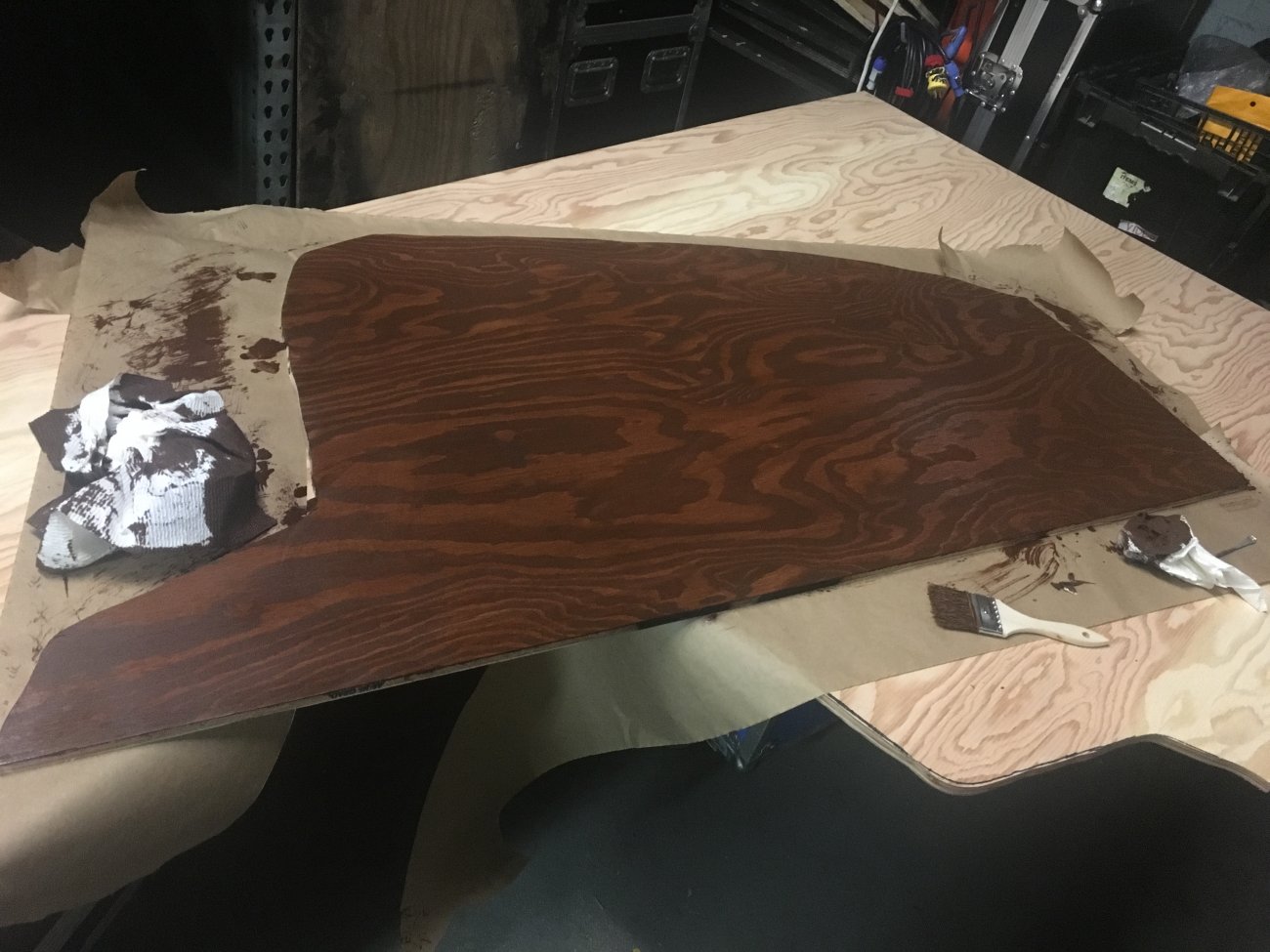

I cut and applied stain to one side of the wood last night. I'm hoping the stain will lighten up as the wood soaks it in. I will find out tonight.

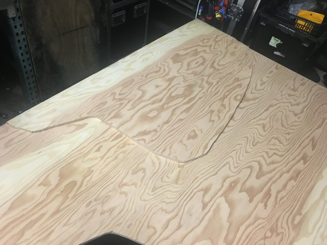

I suspected that you can get two bulkheads out of a single sheet of plywood. It turns out you can. Here's the proof2019-03-05 19.08.29.jpg
