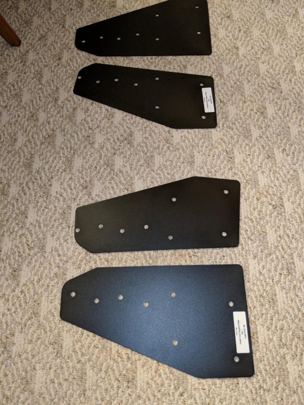

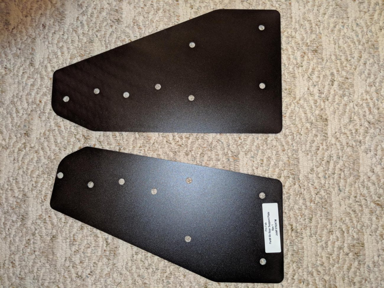

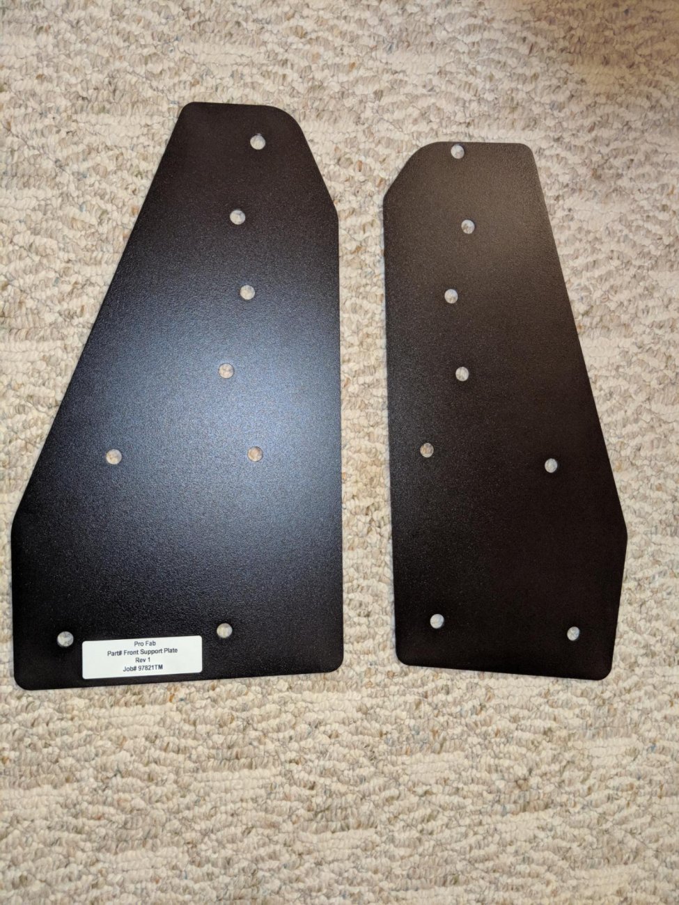

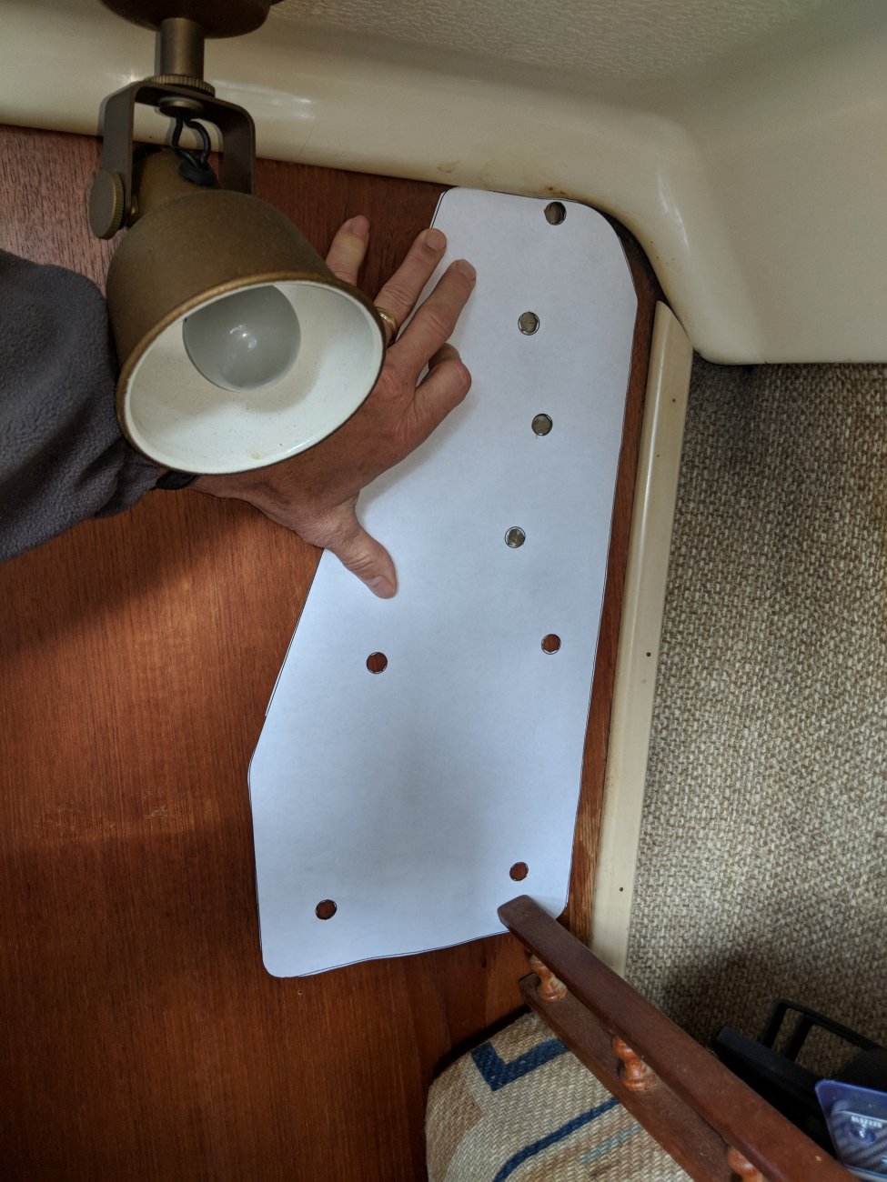

I discovered how bad the rot was about an hour after I bought the boat. The PO agreed to have some large steel plates fabricated for the front and back of both bulkheads. It extends well into the solid areas. He stated that he rebedded the chainplates about four years ago after he discovered the leak and damage. The rotted area is dry as a bone and he's been very upfront about other issues and maintenance. We both agreed last time we met that the plate should do the job but everyone else is telling me otherwise. I'd like to get an idea of how much work is involved with replacing it so I can make a decision

Wow those are impressive plates. If it were me and the wood really is solid in the new attachment area, I'd be fine with that repair for now. Also if you could put me in touch with who did that and I might order a set for my boat just to cover the area better if they aren't too expensive.
You could also consider cutting the damage area out and glue and glass in some new plywood and then still cover it with the plates.
I'd paint those plates brown or cream to blend in better. Install them and go sailing and just monitor as a possible project later. Even when you tear out bulkheads and replace you still probably won't match.

He asked, "What do you think of this?"
I replied, "Bigger"
"How about now?"
"Bigger"
"How's this?
"Yeah I think that'll work"
He asked if steel was OK and I said so long as it's powder coated. A good powder coating job is really tough stuff. I'm totally ok with the black paint. He's been really good to me so I don't want to have him jump through hoops for things such as color matched paint.

I think that will be just fine. I'd still be interested in a set for my 25 if he still has templates.

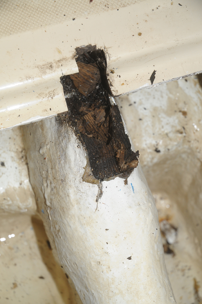

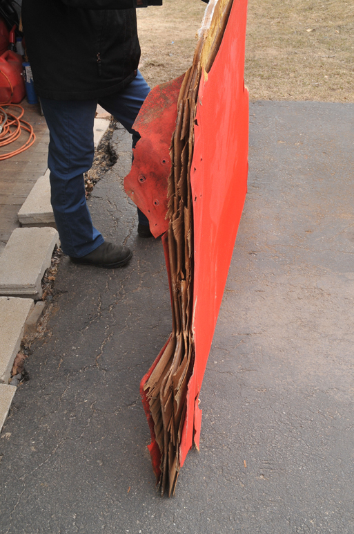

I had to replace all of both sides of both 25s that I have worked on. They both had standing water of different depths in the saloon, and were delaminating. There are actually 6 full sheets of plywood needed to replace all the wood in a 25, if you include the galley assembly!
I used the old pieces for a pattern, which worked pretty well.
Used a floor jack on blocking to jack the headliner up a little when reinstalling the panels. Makes it much simpler to install. My one "mistake" was to go to 3/4" panel vs 1/2". Meant all my measurements were 1/4" off, which meant redoing all of the head wood and galley wood. It's much more solid now though, if 30 pounds heavier, and I like it.
Also had to replace the mast compression post (oak) as that was rotted out also. I epoxied the whole bottom 6" of that before varnishing the rest of it.
What you are looking at is the rotten bottom of the post in my new boat, and the delamination of my first one. Good luck!
I hope you don't have to replace your transom plates for the king plank and motor mounts. That is a nasty job, which I have written elsewhere in here about!
