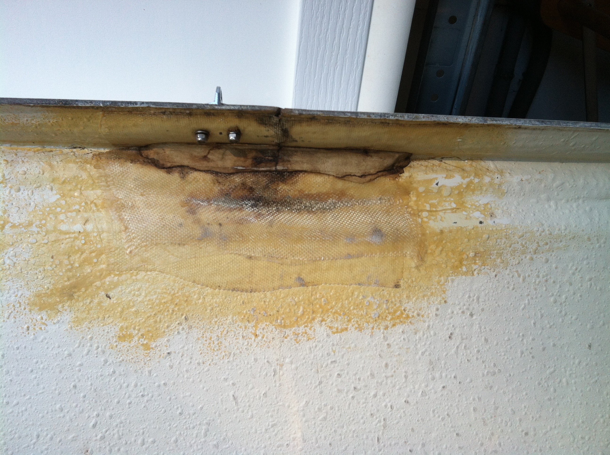

I just purchased an O'Day 222 that has a few issues, but the most troubling is that the sliding hatch was damaged some time in the past and needs to be repaired/replaced. It appears that the mast was dropped on it and cracked the glass on the aft edge and in the center. Water leaked in, probably froze and thawed many cycles, and now that I have the boat, I want to repair/replace it. I'm going to talk to Rudy at D&R Marine, but I've seen from earlier threads that he apparently doesn't have the molds for this model. Anyone have one kicking around or any thoughts on rebuilding this one would be appreciated. The two prices I got from boat repair facilities were both over $1200 and $2000, making the hatch worth about 1/2 the cost of the boat. Ideas?

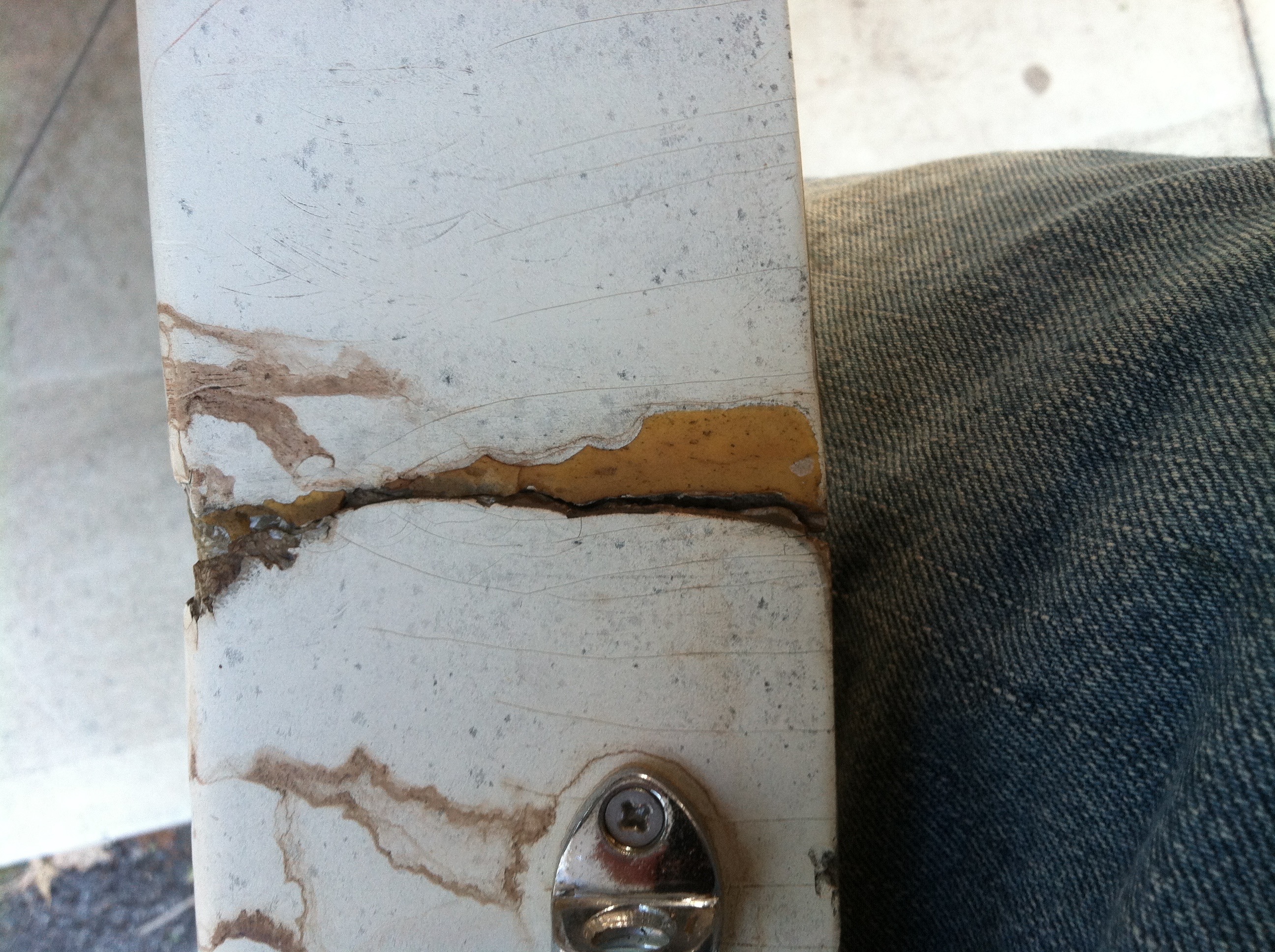

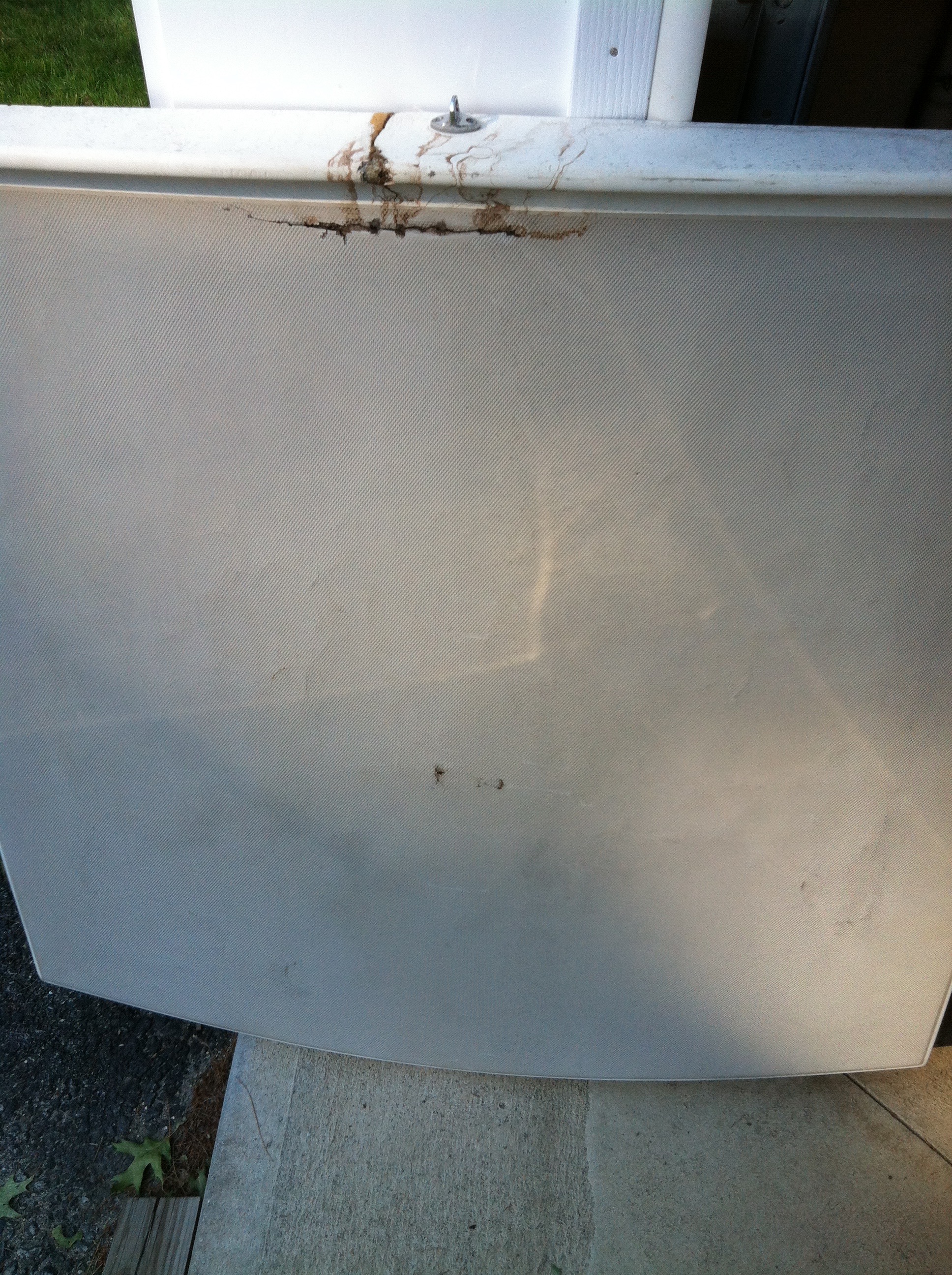

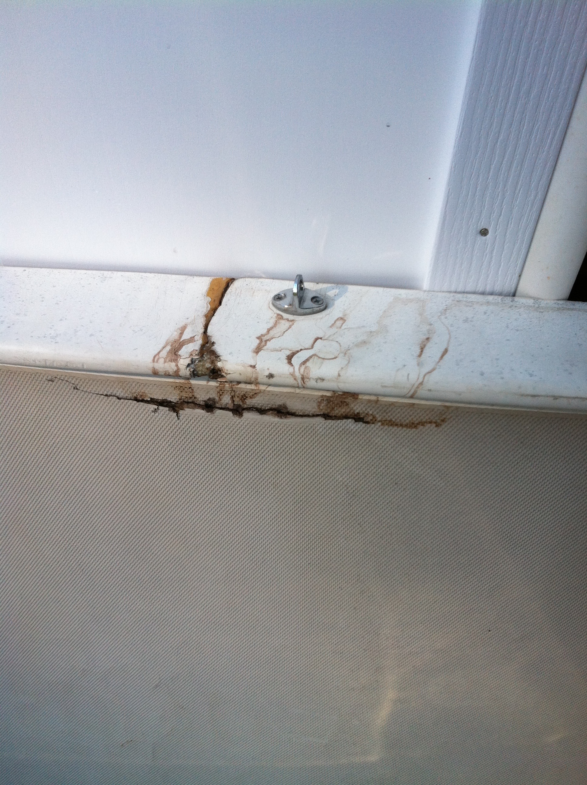

Below please see 4 photos of the damage. There is about a 28" square core in the center of the sliding hatch, and when I removed the hatch from the boat, water poured out. I'm sure that this damage occurred years ago and went through a number of freezing/thawing cycles, so much of the core is delaminated. As you can see, a very poor repair was attempted some time ago. I hope you can understand the photos and orientation. If I cannot come up with a better alternative, I will attempt a repair. I might spend $150 to $250 on materials and still be way ahead of the boat shop estimates.

Yeah, I think you can grind out a lot of that underneath, widen out the crack. Fill the crack on the back lip with some epoxy thickened with colloidal silica and microfibers. Fill in the part you grind out with layers of fabric and some mat. It would be best to grind off the gelcoat on the outside so that the repair adheres to the old resin and glass, not the gelcoat, and put 2 layers of fabric. It probably won't look pretty, but it would be strong again. I also think you could grind off a section of non-skid there, in a nice centered rectangle, to lay the fabric over, and then you could paint the perimeter to all match. Maybe the rectangle with new fabric could be painted the perimeter color with some non-skid. Or maybe you just repaint the whole non-skid area with grey Interlux Interdeck. The biggest issue is to grind back all the cracks to bevel in the new repair, and provide a lot of adhesion surface either side of the crack. If you don't know fiberglass repair, you can look up youtube videos of patching through hulls, and see how to bevel back and lay in layers of glass.
