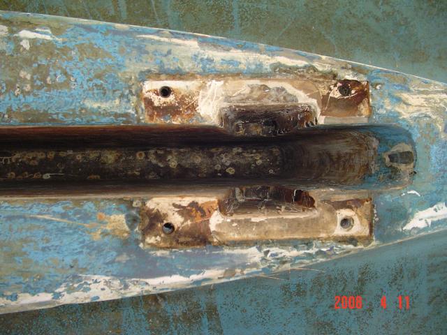

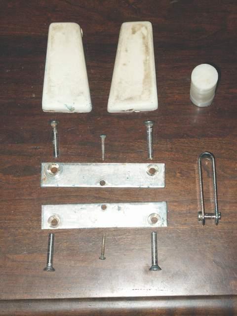

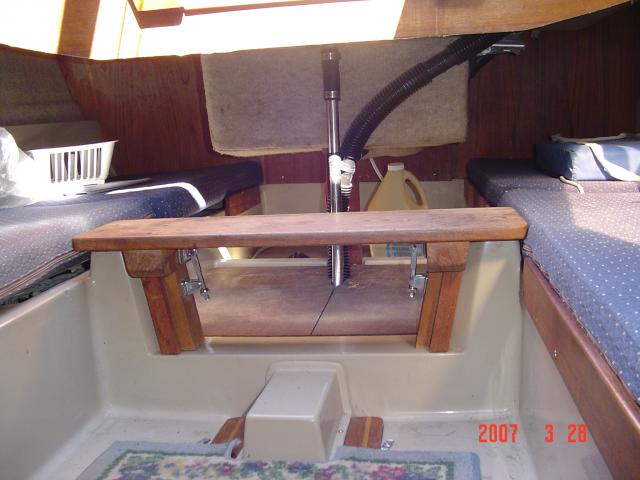

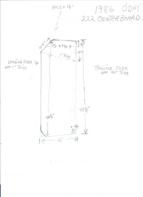

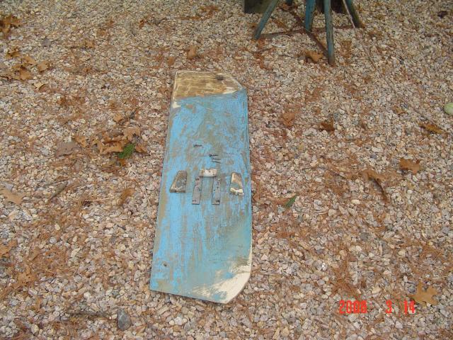

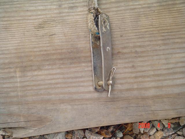

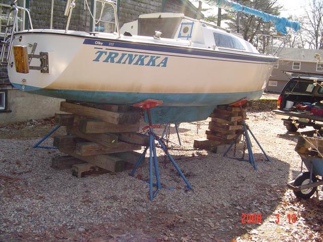

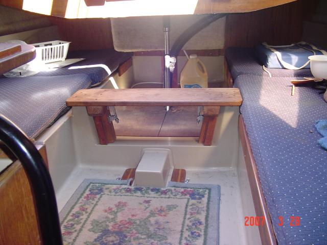

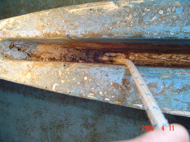

If you have this ability, or know of someone who does, I would say "go for it." Nothing is impossible if you have the expertise, and inventive skills that it takes to do a job like this. I'm not too keen on dagger boards because they don't swing up when they hit an object. Here's a few pictures of my O'Day 222 keel/centerboard set-up that should give you some idea of what is needed. I measured my board to be 44-3/4" long X 12" wide. My keel slot depth is approximately 13" deep. There's a smaller slot for the pendant line sheave that could only have been installed inside the cabin, and it appears to be glassed in with it's backup plate. The is where the pendant line pipe comes in from the cockpit step at the companionway. If you need additional pics, let me know. If you decide to tackle this project, please post some pictures of it on this site.

Here are some additional pics of my 222 centerboard set-up. The black hose in the first and third picture is my bilge pump hose which is taped to the centerboard pendant line pipe. The pipe goes to the sheave block under that square enclosure where the rug is.
