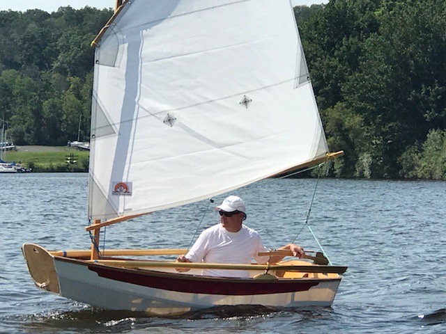

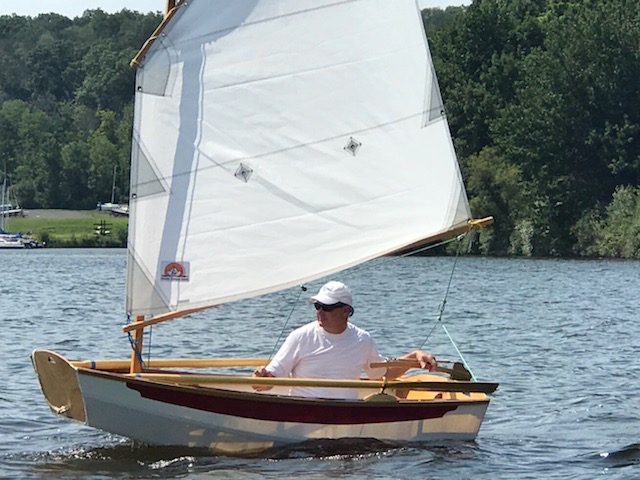

The rigging plans for the pram I just built has the mainsheet coming off end of the boom and turning forward at a block on the rudder head. I decided to modify it with a bridle across the transom, then forward along the boom, more like the other racing dinghies I've had. With the little standing lug rig, it's different, and kinda weird. Still trying to figure out how to get it to sail to windward as well as possible. Dumping the sheet and the wind is pretty instantaneous, and conversely it's very easy to over sheet. Maybe I need some telltales on the luff, but the mast is right about where I'd want them to be...
