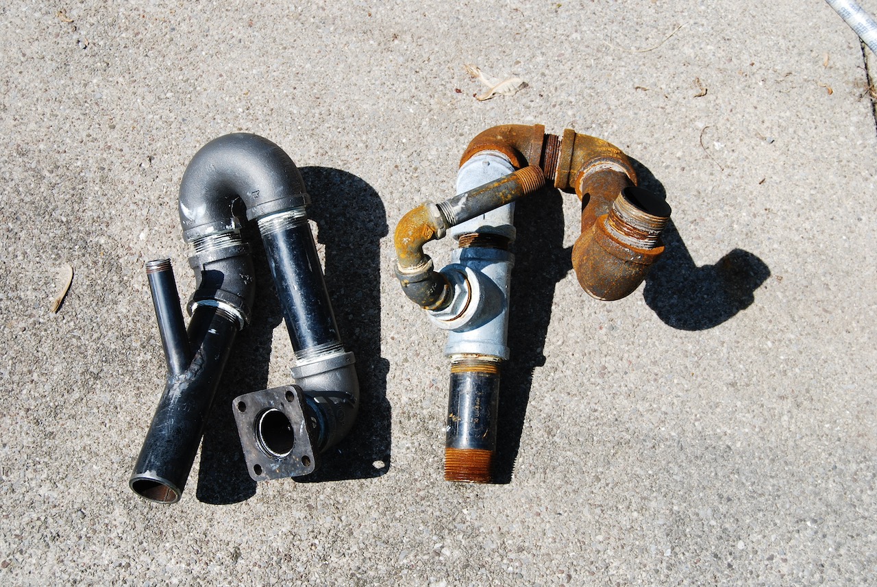

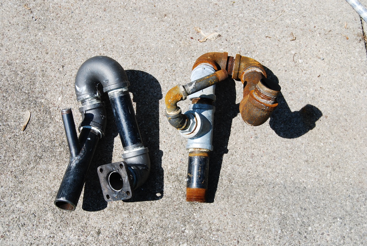

I don't know the type or location of your muffler on the O'D -- I've chartered but never looked at the muffler. But on our C-30s on replacements, we typically use a stainless one-piece riser like below on the M-25 and XP. etc. There's a myriad of shapes and types depending on the model and year.

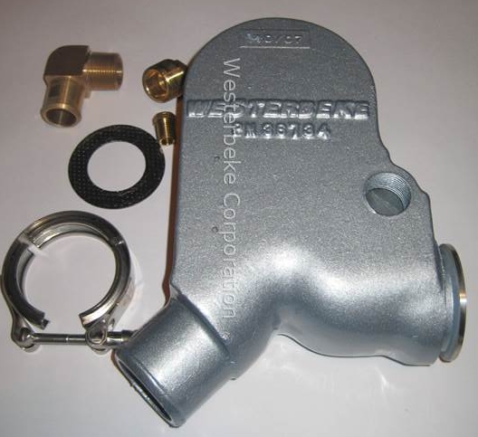

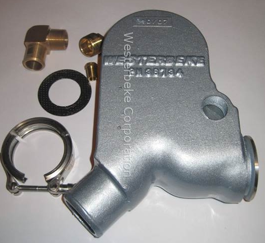

Also, Universal has a water-cooled riser that is a huge improvement -- no wrap needed and the engine space is much cooler. I have helped some install that riser on our 30s and on a 34.

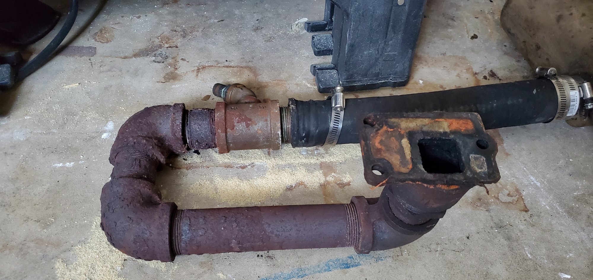

Thanks for the comments. Repaired yesterday. I had done this before some years ago. The system is manifold flange, 2" nipple, then elbow then additional piping similar to the other photos. The 2" nipple was LOOSE where it attached to the flange (not broken). It was installed by threading the nipple into the flange finger tight, then the elbow onto the nipple and tightening the elbow with a wrench which tightens both fittings. Intuitively seems that both ends of the nipple would tighten to the same torque. After a couple years the flange end was loose! The elbow end required a 2' pipe wrench with a 2' extension to break it loose! So what happened to the flange end? It cannot unscrew with vibration. (Once this is assembled nothing can unscrew.) Can the pipe stretch due to vibration? Replaced with Sch 80 so hopefully no future problems.

Can you show some photos of the new set up? I have done two black pipe complete exhaust replacements with fiberglass wrap over my now 25 years of ownership (Univ M-12) and dread doing it again. Is there a union in your setup? Was not in mine and I wondered why.

Think about the W'beke water-cooled option if it would work with the O'D muffler arrangement.
The M-25 and M-25XP would use the threaded, not v-clamp version of the wetted riseruniv v-clamp riser.jpg.

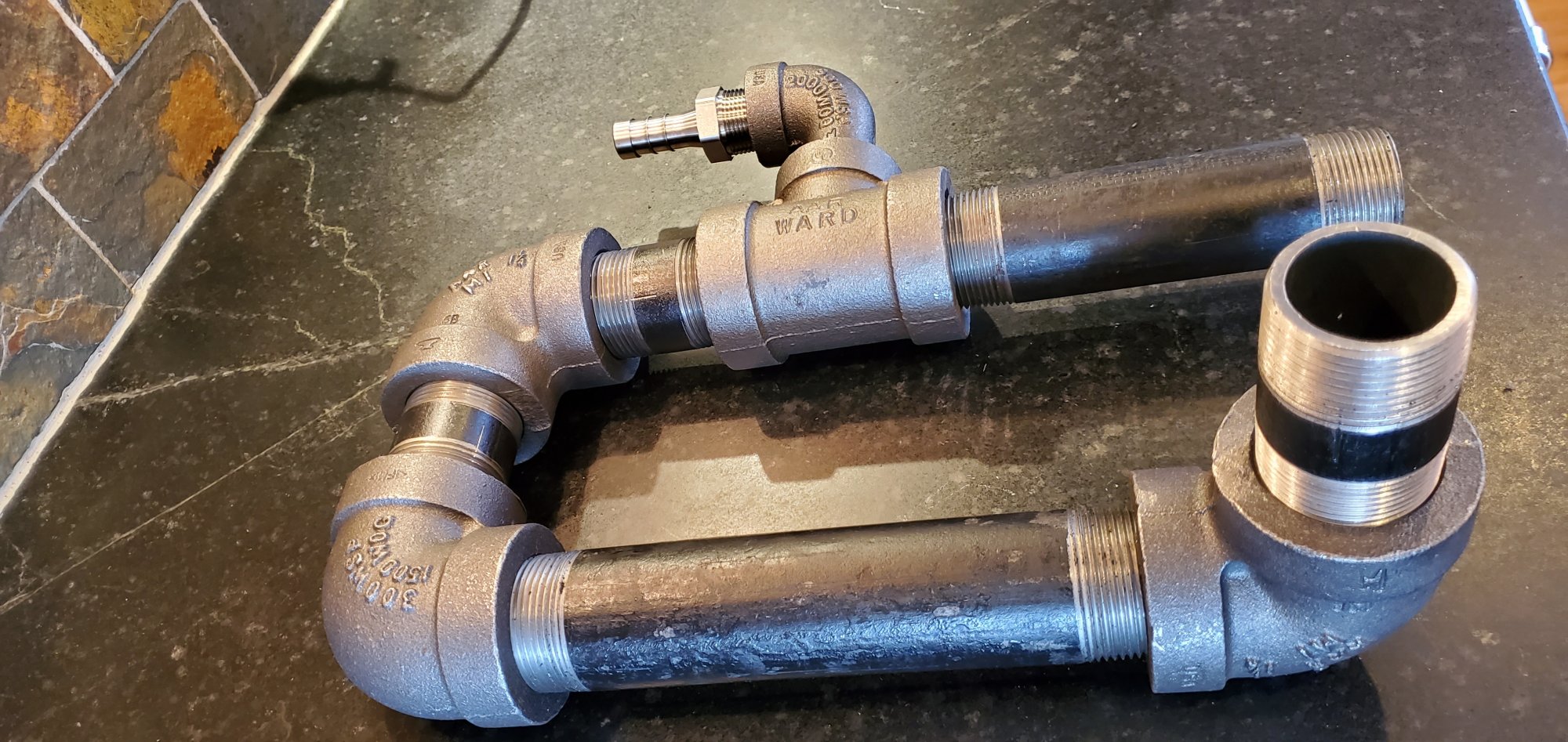

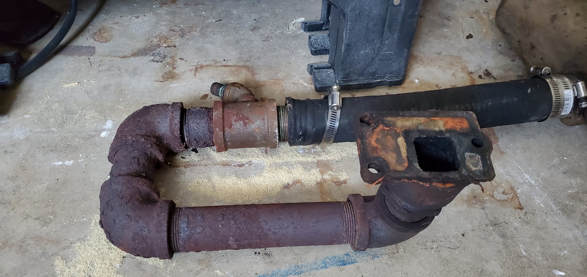

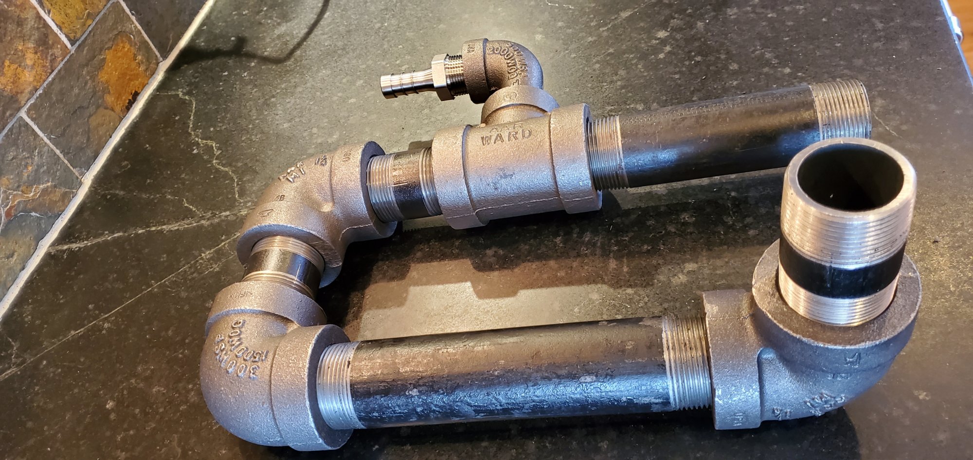

Here are a couple of photos of our old exhaust and the new one made with black iron pipe purchased from McMaster Carr. This is from our 39 but I did the same thing on our 34. I purchased some titanium exhaust heat wrap on Ebay to insulate it.

That looks roughly like my set up, albeit with a 3 bolt flange. Was more curious about the PVC route. Was also thinking stainless, but black pipe with salt water environment is not a one and done which is what would interest me the most. Looks like no union on your set up.

The temperatures are too hot for PVC. It will soften and bend. Black iron works and will last a while.
My last boat, a '81 Sabre 30 with a Volvo had a shop built exhaust riser similar to @Sefuller. It lasted about 30 years in freshwater. When it let loose, we were about 14 miles offshore becalmed between thunderstorms in a shipping lane. I cobbled a replacement out of parts from the big box hardware stores in Kingston Ont. and then assembled a new one with 1 ¼" black iron from a big box store and the 180° elbow from McMaster. The 180° elbow has fewer joints and was consistent with Sabre's original riser.
