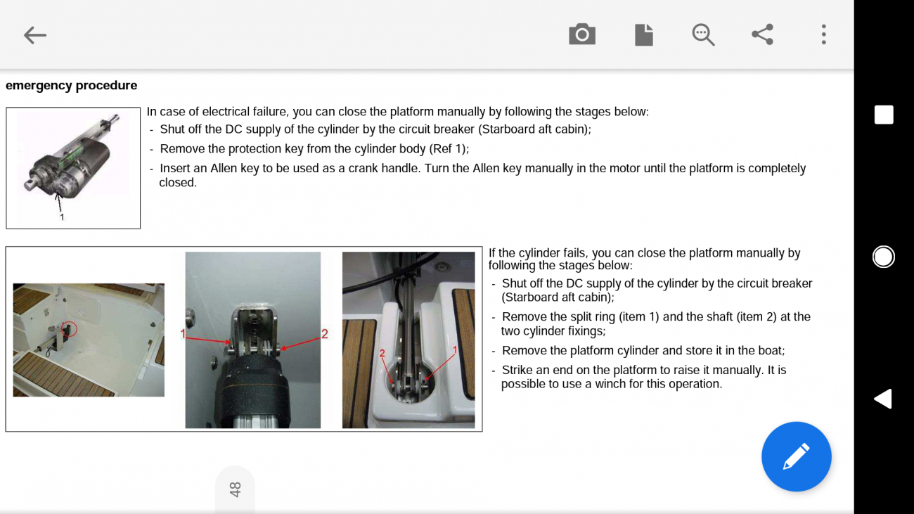

Our neighbor has a 45, but unfortunately it's not in the water now and he's not around to ask. I did find this in an online manual for the 48, about the manual procedure. Yours could be similar.

You're awesome. The actuator looks the same as the 45 to me. Will forward this on to the delivery Captain to see if he can handle it. Thanks again!

Hi Mike,
I owned an Oceanis 45 and chartered it in a charter fleet. There is no way to manually raise the platform without disconnecting the actuator. While the boat was out on charter it failed and one of the boat techs went on site and just disconnected it. The platform can then be raised by hand and then locked in place with the normal locking mechanism. Then you should be able to better trouble shoot it when it has been delivered. We had to replace the actuator. I personally think this was a design flaw not to have an easy way to manually lift the platform without the actuator.

Thanks Jim,
Fortunately the part arrived in time and the transom is operational once again. Definitely seems like there should be a way to manually operate it as a backup. Might have to see if I can figure something out once I have the boat home.
