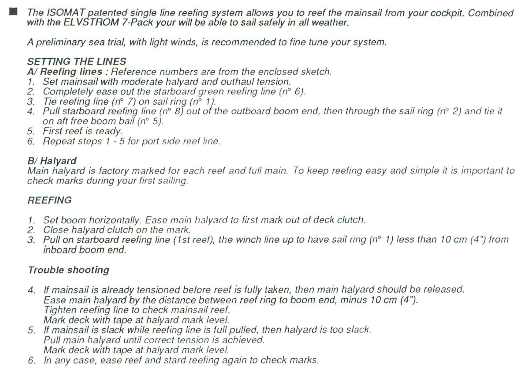

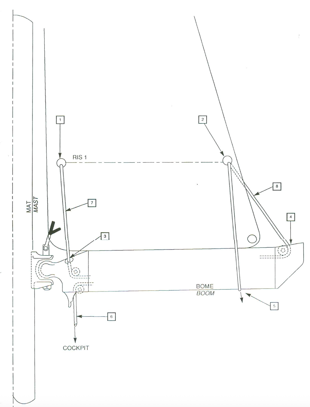

I found a partial diagram and some written instructions that answer my question in the French version of the manual. Hopefully this helps anyone else who has the same confusion in the future. Although it isn't shown in the diagram, I'm almost certain there is a block in the boom. Full manual and screenshots of the relevant sections attached for reference.
