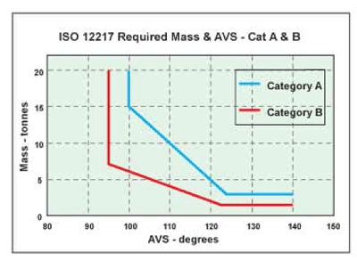

Category A is "Ocean"
Category B is "Offshore"
There is no Category A "Offshore."
Category A -- Ocean - This is the category with the toughest standards and covers vessels 40’ and over designed to be self-sufficient for extended voyages. It is defined as the "category of boats considered suitable for seas of up to 23 feet (7 meters) significant wave height and winds of Beaufort Force 9 (41-47 knots) or less, but excluding abnormal conditions such as hurricanes."
Category B -- Offshore - These boats are designed to go offshore with the ability to handle winds up to gale force 8 of 40 knots, and seas up to 13 feet (3.96 meters).
This chart shows a boat's displacement and the Angle of Vanishing Stability (AVS) as indicated on its Gz Curve.
The difference between Category A & B is shown in the above graphic, where Mass is tons and AVS is the Angle of Vanishing Stability when the boat goes upside down. Category A boats need to be to the right of and above the blue line and a Category B boats to the right and above the red line.
