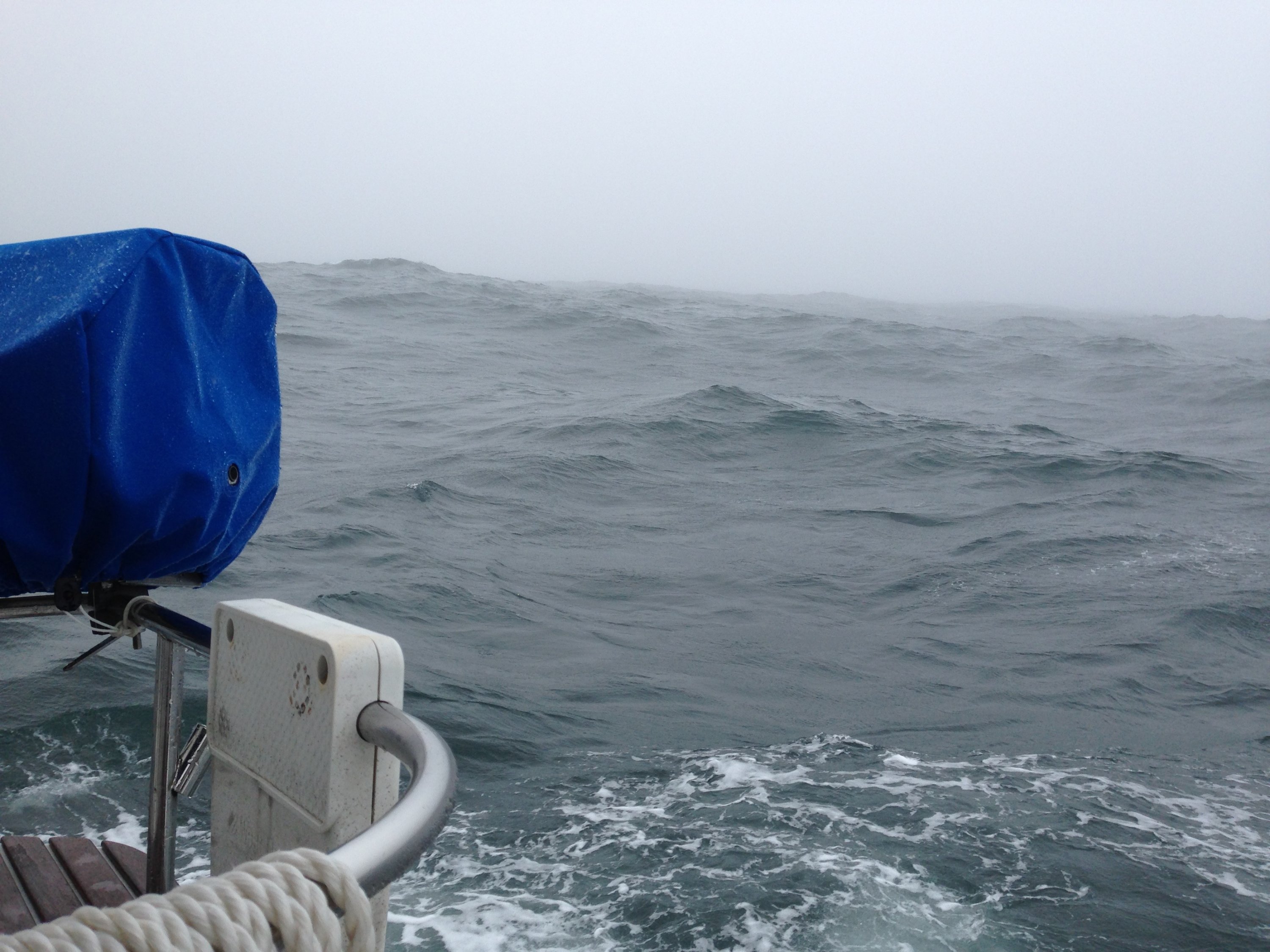

A lot of good advice so far. Narcissitic, self proclaimed experts usually have an opinion on things they know nothing about and tell you quite vehemently about them from no experience what so ever. That being said, I don't think I've every really hit heavy weather as I use a weather router on all trips more than 10 miles outside the line of demarcation for any given area. If I'm in the ocean for a trip I buy a card for the satellite phone and hire a weather router for the duration. This picture is from a trip on the "outside" up the east coast from Hilton Head SC to Port Washington NY. About 30 miles off NJ with an inland storm.
