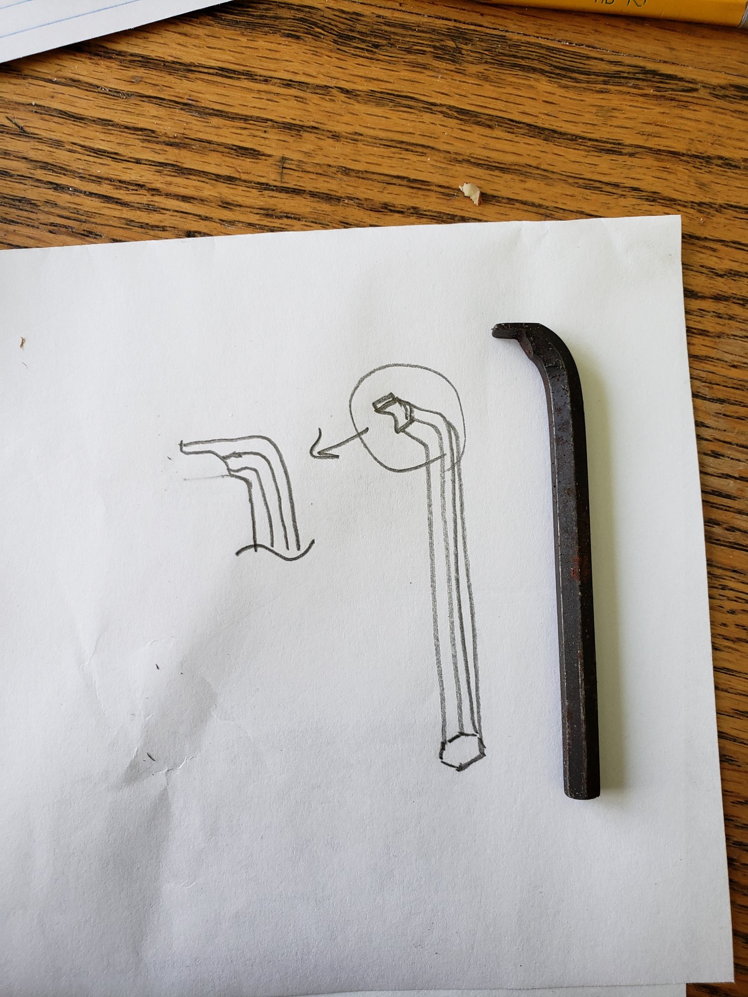

For those who choose to rebuild - I found this tool fab directions somewhere and it worked great. Take an allen hex key and shorten the small end so that the overall width is less than the shaft diameter. Then grind a flat on the bottom and then grind the top so that he thickness is about 1/16". This tool can be worked into the weep hole side of the seals and then can be lightly tapped to push the seal out from each side
