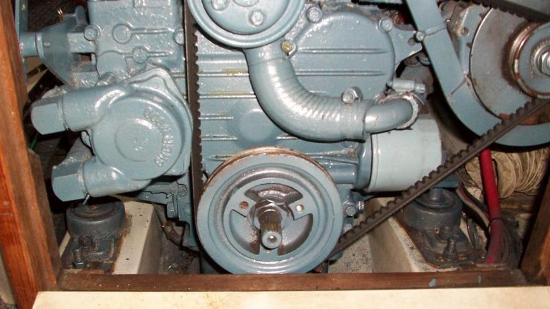

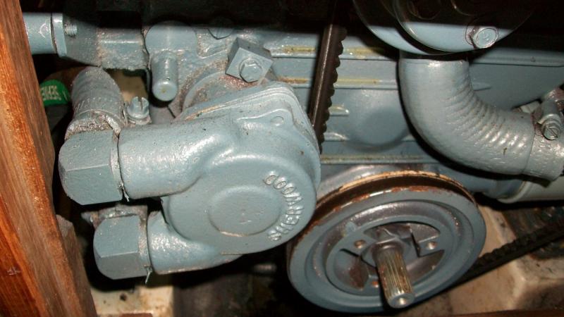

Ok, finally took a couple of pics of the Sherwood pump on my -25XPA. I'm hoping the -16 pump will bolt right up without cutting/hacking/grinding.
Am I correct?
