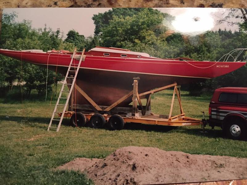

dad had one of these 38' racers. grew up sailing it. it had a 7 1/2 evinrude outboard that went in a well and the was pulled out during the sailing. pushed that 38' at hull speed at 3/4 throttle.
there allot of people that love to overkill everthing.
yet there is no logic from what i have learned.
new sails, not there is something you can overkill with good results :)
