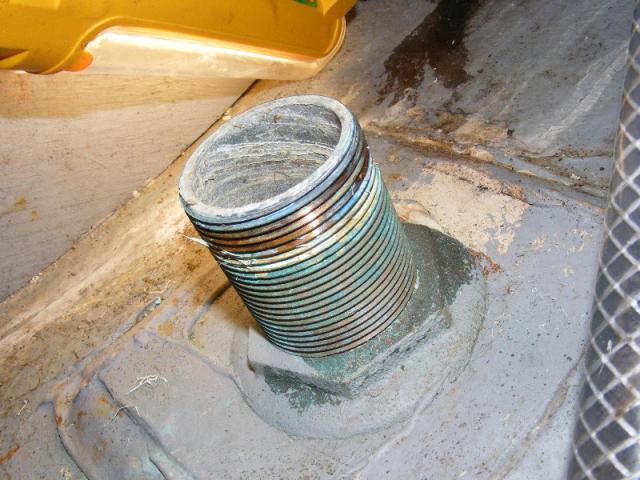

My boat came with gate valves which should definitely be replaced yesterday if you have them. That was when I first learned about the thread mismatch issue. I even put a piece on my blog about the expensive (I thought it was expensive at the time but I hadn't yet heard the term "boat buck") pickle I was in. I even made up a nice little CAD drawing showing why the thread mismatch is so horrible.
The yard manager, who was a very knowledgeable guy, told me that they had been doing it for 20 years and he had never heard of a problem. I took a pair of NPT and NPS fittings, screwed them together hard, and knocked on them a bit. They felt solid. So, I did as the yard manager suggested and ended up with four on my boat. Two are a few inches above the waterline and small so I’m not too concerned about them. Another is in a very protected space and, like the previous two, is only half inch. Groco doesn’t make seacocks that small.
The fourth one however, is inch and a half. That one could easily overwhelm the boat before I could get it plugged. I decided to put a proper Groco adapter on it. This also gave me a chance to assess the condition of the mismatched threads.
The valve was quite hard to take off. I could just barely move it with a pipe wrench in the confined space. I had only used Teflon tape on the threads but it still needed the wrench for most of the removal. The threads can be seen below. There appears to have been pretty good engagement and contact and no sign of thread distortion. The Groco adapter turned easily onto the through hull after the threads were cleaned up.
I don’t think the thread mismatch is as much of an issue in these installations as the lack of a flange and having the valve often way up at the full length of the through hull where there is a lot of leverage and only the small nut area to support it. If I’d seen the condition of these threads before I was committed to the project, I might not have been so quick to do it myself although I would, of course, recommend that anyone else do it.
It will be nice to have the valve easier to replace anyway. This is a holding tank pump out line and, as you can see by the third picture, the stuff really does a job on the stainless ball. The seawater side is shiny.

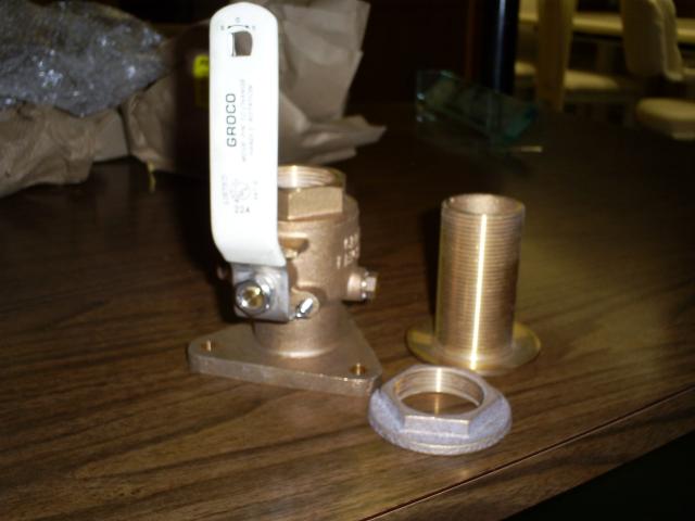

Groco has another way of doing it. The "seacock" has the mismatch to the thru-hull.
But they have a 3 piece solution that matches perfectly with no mismatched threads.
You use a thru-hull, a flange that screws down on the thru-hull and bolts to the hull, and then add a 'valve' instead of a 'seacock'.
The valve screws onto the flange with matching threads...NPT. IBVF is the flange part number. take a look at groco.net, they have a picture that illustrates this. it's hard to find so look for the IBVF flange adapter.

From the bright finish on the thru hull threads I wouldn't be very concerned about that failing. It is amazing just how bad plumbing can get and stilll function as built. Even better than teflon tape is brush on pipe dope. Pipe threads are either tight and they don't leak or they are loose and they do leak. No middle ground.

A thread mismatch will tighten securely, but once backed off a bit it becomes very loose.
It may depend on the fittings and manufacturing tolerance. After the threads were cleaned up, this valve and through hull were quite tight. Felt tighter actually than the NPS adapter on the through hull.
Frankly, I think your yard manager is an idiot. If the boat is already hauled, why on earth would you ever avoid the relatively small expense of installing an adapter which would solve all these problems?
I don't think these adapters were available at the time.
I know you said didn't advocate others doing it, but it sure sounds like you're suggesting that a thread mismatched piece of equipment keeping the water out of the boat isn't that big of a deal.
Both times I've looked at critically at mismatched fittings it hasn't seemed like as big a deal as it's made out to be. It certainly isn't best practice but I think the lack of a flange is a more critical issue. It may well be though that some combinations of individual NTP and NTS fittings do not go together as well as the ones I've worked with. This joint was pretty damn solid when I took it apart and the valve lever has been very stiff so there was plenty of force on it.

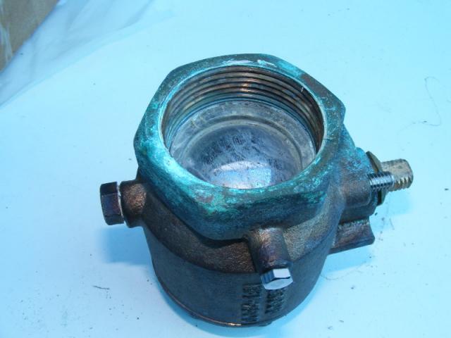

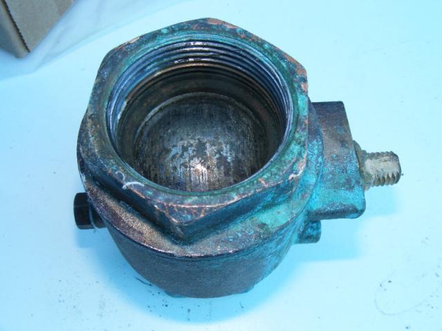

This is a cut away I did to showcase NPS to NPT on the left and NPT to NPT on the right. These were straight off the shelf at Hamilton Marine then lubed with Sailkote and threaded in tight by hand to where they stopped and I would have needed more than my hand strength.
Problems do occur with mis-matched threads. Groco warns of it in their literature and most recently the voting members of ABYC added a section to H-27 Seacocks and Drain Plugs that say all threads must be compatible meaning either NPS to NPS or NPT to NPT. The ABYC does not make changes without merit and is made up of all type of individuals in the marine and even insurance industry. This wording was not done because there are no issues with this type of thread interface it was done because there are.. ABYC is not a mandatory standard, though most builders do adhere, but their guidance is the best we have in the US.
Here is another hypothesis on your thru-hull. I hope you don't mind that I took the liberty of editing your photo. If you do I will remove it.
In this photo I have marked the two threads that would be the tightest fit in red. It is apparent that these threads, when cranked down on with a wrench, had major thread to thread impingement and removed the teflon tape interface. With the teflon ripped away and removed and you had a metal to metal seal leaving behind the verdigris (green color) between the metals.
Because the female threads of the ball valve are tapered the top two or three threads on the seacock will be the tightest fit and th majority of your holding power. The threads marked in green did not even tear away the teflon tape leaving protected bronze underneath. If this was an NPT to NPT the teflon tape would have been removed in a more uniform manner and all threads would have been evenly tight not just the top few.

I was thinking of replacing this through hull with an new on but noticed that it is considerably thicker than the new Groco's. In addition to the difficulty of getting it out, why end up with a thinner one?
I'll bet that if I was to pick up a through hull down at the marine store and try it on a NPT valve I would find it just as insubstantial and problematic as you have been warning people about.
Those are certainly combination threads in my boat.

Well, the valves have only about 1/4 pipe diameter of thread anyway. See pictures above. I had full as much bury as the valve design allows although the last two threads weren't quite as tight as the others as MaineSail points out.

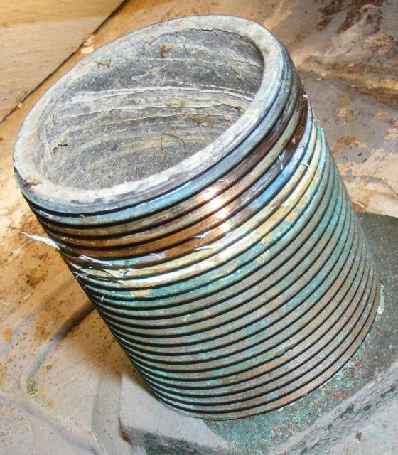

You can see by the pointed thread tips all the way to the end of the fitting that is has not been machined to be used in an NPT female fitting.
Now I'm flipping back. Looking at a close up digital camera picture of my old thru hull, I don't see any sign of such machining or any taper on the fitting. I now don't think they were combination threads. Possibly having NPT gate valves threaded on them hard when the boat was built made the threads a little more amenable but they don't look distorted.
The ball valve went on to the thru hull right to the bottom of the threaded portion. The end two threads were not as tight as the rest as you point out but they still would have been engaged. It was tight with just Teflon tape and very solid. The threads were clean with just tape and it took a lot of force to get the valve off. Good thing the thru hull is in sold. I suspect it was done with 5200.
I can believe that the yard manager who advised me back when I was new to this never had any problems doing it but also agree that it's not a good idea on something so critical. I'm glad to have the big one done properly. I'll probably try to do the remaining below waterline one as well now.

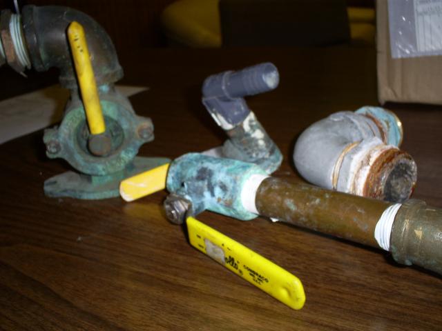

When I first looked at my through hulls and sea cocks, I thought "I think they'll be ok"
After 6 months on this site I think differently.
These are the sea cocks out of my boat. There is some copper, galvanized, plastic and bronze. And probably some brass. THe big flanged seacock is a groco, it wasn't installed on my boat, it was in a box but it has a rubber ball valve and a compression plate inside to tighten it up when you close it.
The other new ones came in the mail today. On maine sails recommendation I am sending the flanged seacock back. I ordered the flanged adapters, they'll be in next week.
