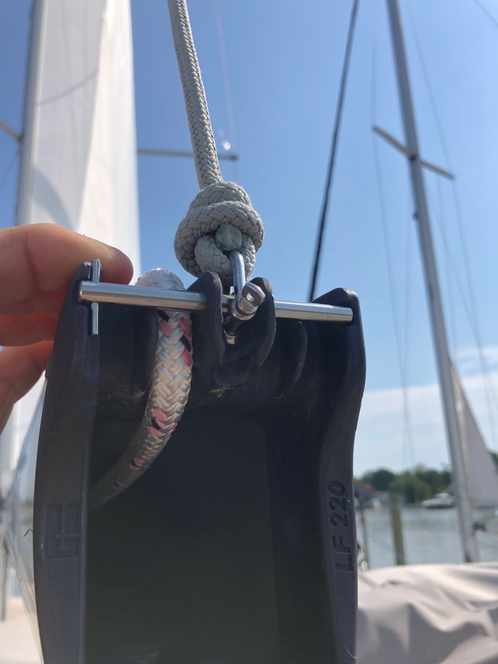

The in mast furling on my boat is great except it takes real grinding on the winch to unfurl and furl. I looked carefully at the boom and a tech looked at it and we agreed: The boom end fittings were a poor choice by Beneteau.
The outhaul line comes back from a car on the boom, then does a 180 degree turn around the outboard boom end. The line runs over metal, not a sheave. The line goes forward inside the boom, then does a 90 degree turn down to the deck. Again, the line runs over metal, not a sheave. When I stand on deck I can pull the sail out easily. I grab the outhaul line where it comes out of the boom and pull down and it is ridiculously hard to pull the sail out.
Why the heck didn't Beneteau use boom end fittings with sheaves? Or is the mechanical advantage so little compared to the bare metal it wasn't worth the cost?

On another forum a member tracked down the part. The boom ends are Sparcraft LF220. "Low friction" boom ends which are "low maintenance" since they don't have sheaves. The brochure even lists the Oceanis 35 as one of the boats this fitting is used on.
From the picture of the end (below) it is possible Beneteau is using a line which is too thick for the fitting. A thinner line might go through the end without binding. Still a poor design.
Funny, in a depressing way. Their marketing department deserves an award for that one. Unmaintained Sheaves in the worst case will seize or disintegrate, resulting in pretty much the same amount of friction as the "new and improved" design.
