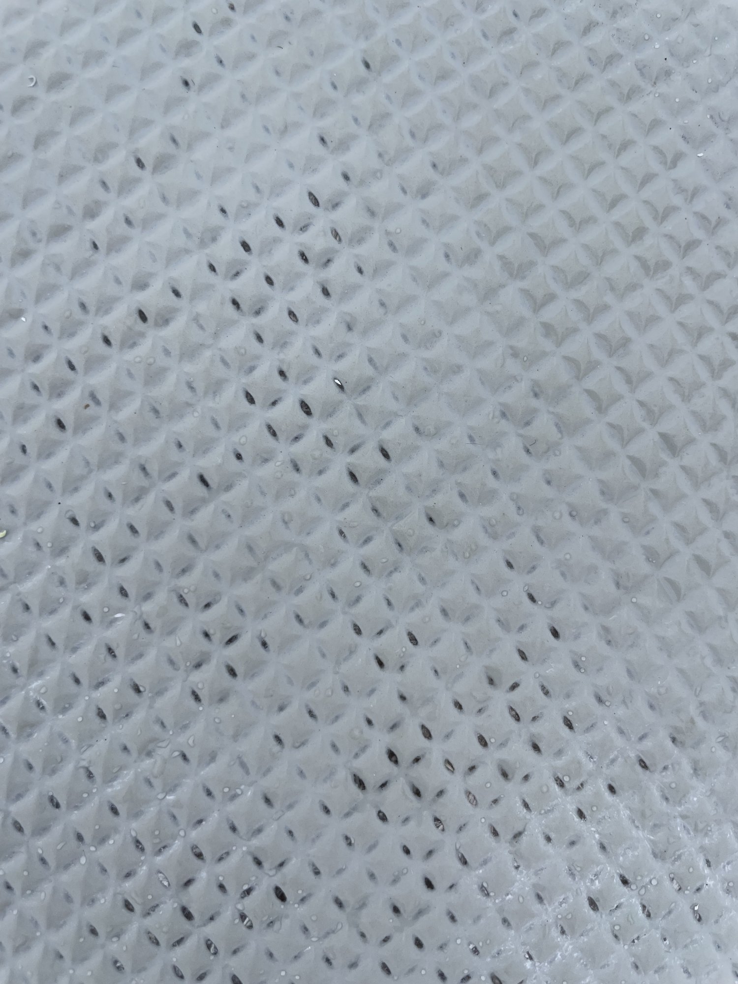

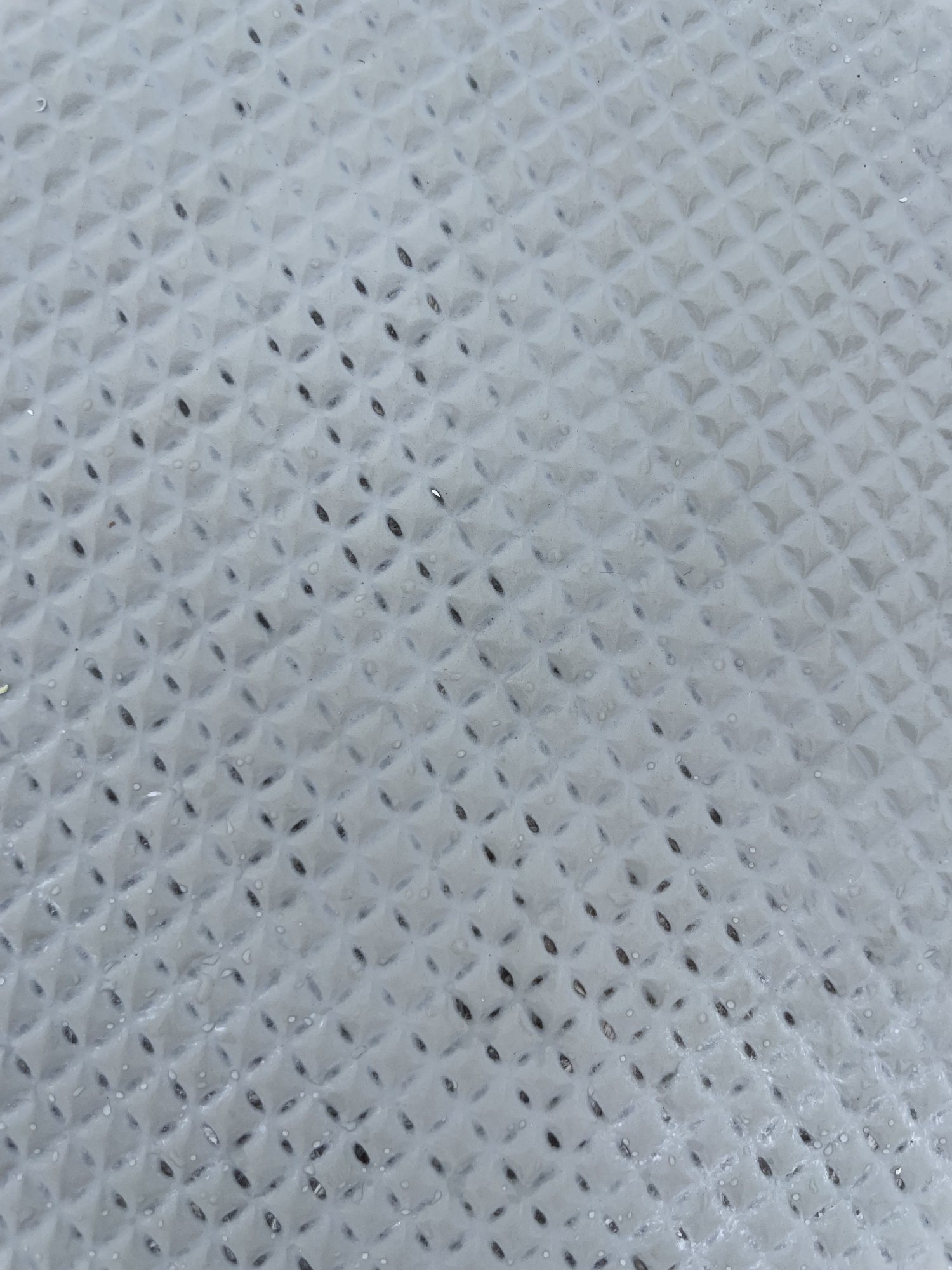

How do I get these off the non skid? I’ve tried Clorox, starbrite mildew-mold remover, pressure washer, toilet bowl cleaner, Starbrite, black streak remover, diluted TSP solution, starbrite non skid deck cleaner, starbrite rust remover. Ugh! Thanks for any ideas!
14,278
The low spots of non-skid have very thin gelcoat. If you look closely you can see the fiberglass in the low spots. Those white threads are the glass. The more you scrub this with an abrasive cleaner the more it will wear away. Time to replace the nonskid.

Above is an enlarged section of the OP's photo. Notice the relative uniform shape of the dark areas and how the white gelcoat fades away to the dark area. Also notice the white streaks in some of the dark area. The dark areas are all in the valleys.
Thus far, no one has reported success at removing these kinds of dark spots, because it is not dirt, it not mold, is the fiberglass under the gelcoat. Gelcoat is sprayed into the mold when the deck is built and it is not an entirely uniform thickness, thus, some areas under the nonskid are a little thinner or thicker than other areas. After 30 years of scrubbing, the thin layers wear out. The gelcoat is thinnest under the valleys in the non-skid.
There is no easy fix, all will require standing the non-skid smooth and adding new nonskid. There are options that range from gluing on a rubberized non skid, a one part fix like Kiwi Grip, painting and adding grit like Soft Sand, or using gelcoat and Gibco Flex mold. The other option is just learning to live with it as it is.
Wish there was a more optimistic solution. One thing for certain, more aggressive scrubbing will only make it worse.

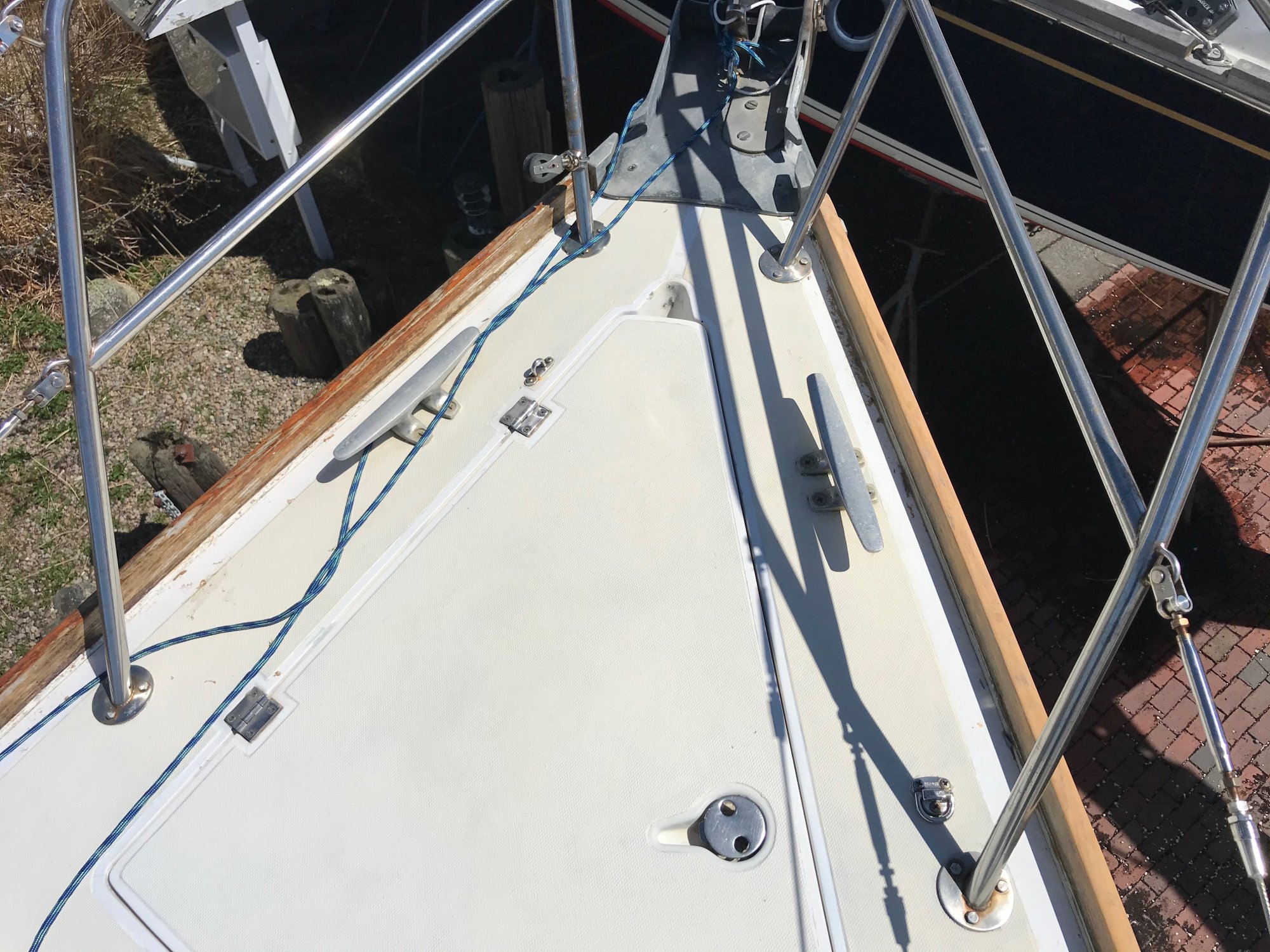

You could paint the non-skid, I used total boat non-skid paint on a diamond pattern, the pattern is less pronounce yet the nonskid properties remained. Not perfect, easy to apply, here's what boat looks like...
