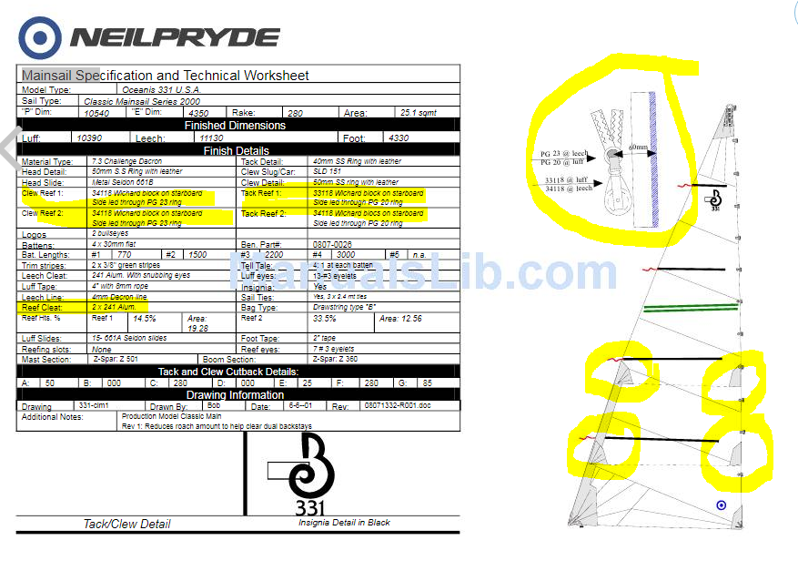

Above is the STANDARD Neil Pryde specs for the B331 conventional main sail. i.e., NOT the in-the-mast furler.
  • I can tell from the comments above that others must be confused.
  • The specs clearly show two reefs are provided.
  • These apparently are two sets of SINGLE LINE REEFING
  • It's possible that someone rigged one set of "double line reefing" for the first reef; and then??? I have no idea???

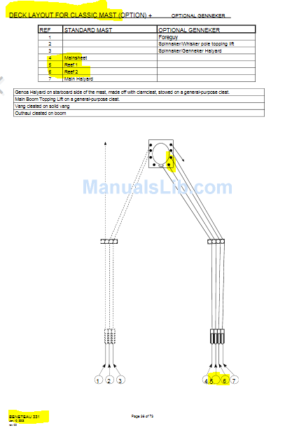

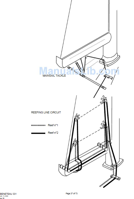

  • Anyway, below are some shots from the manual. The bottom two diagrams tell the story.

He most certainly has the set up you posted. I might have caused your confusion by referring to this as “simple two-line systems”, meaning two lines control BOTH reef#1 and reef#2. It is possible that someone incorrectly routed the two OEM installed reefing lines in a two-line reefing system on the reef#1. You could do that, but it would not be as designed. The sail is loose footed BTW. Good on you for posting those diagrams.
23,874
Clearly your chart shows a single line that is used to reef at point #1 on the sail and a second single line to reef at point #2 on the sail.

OK, I found them and yes I have seen them in the book. I have the 4 blocks on the sails. But the only line that comes out of the boom is for the #1. From the look of that diagram, the #1 is spotted, the #2 is bold black - wonder if that means outside the boom?? (not likely)
When I take her out in a few weeks, I'll take the boom off and look harder. It appears that there is no other lines in the boom on the internal sheaves. Maybe someone pulled it out by mistake. I won't give up until I find the solution!!

Bluenose, if the line isn’t on the deck, then it was removed and needs to be restrung.
You will simply need to do that. You need to make the line long enough for the second reef (it will be much longer the the first reef NEEDs to be.

That color is so you can tell them apart in the diagram. They both go in the boom.

Bluenose:
Tie a messenger line from the foward or aft ends of the boom where you can get to the line that you have. Then you can pull it through the boom to the other block.
Just before you get to the other end, you can grab it with a tweezer or hook or ...; and then you can string it to the other block.
Or get an electrician's "snake" or wire puller, and just do it that way with a line. The rest of the diagrams that I posted above should allow you to get it done.

I did not need to take the boom apart, nor even remove it from the mast. I just made certain that the other reef line and outhaul were pulled tight and was careful not to get the lines tangled as I fed them through the boom.

Yes, OK, I see now what can be done. I thought there were a set of cars/pulleys inside, but no, just need to get from one end to the other. Thanks!
