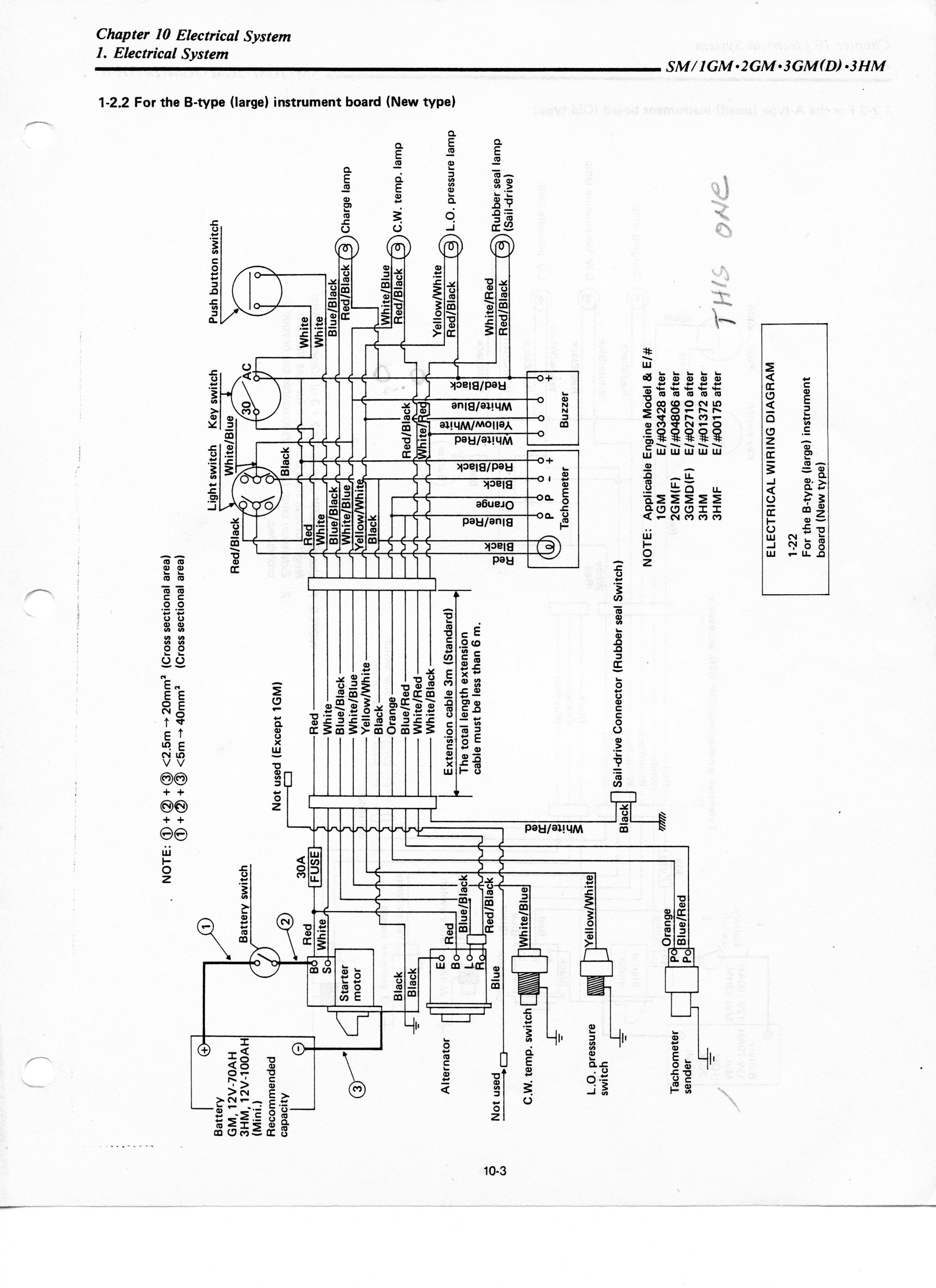

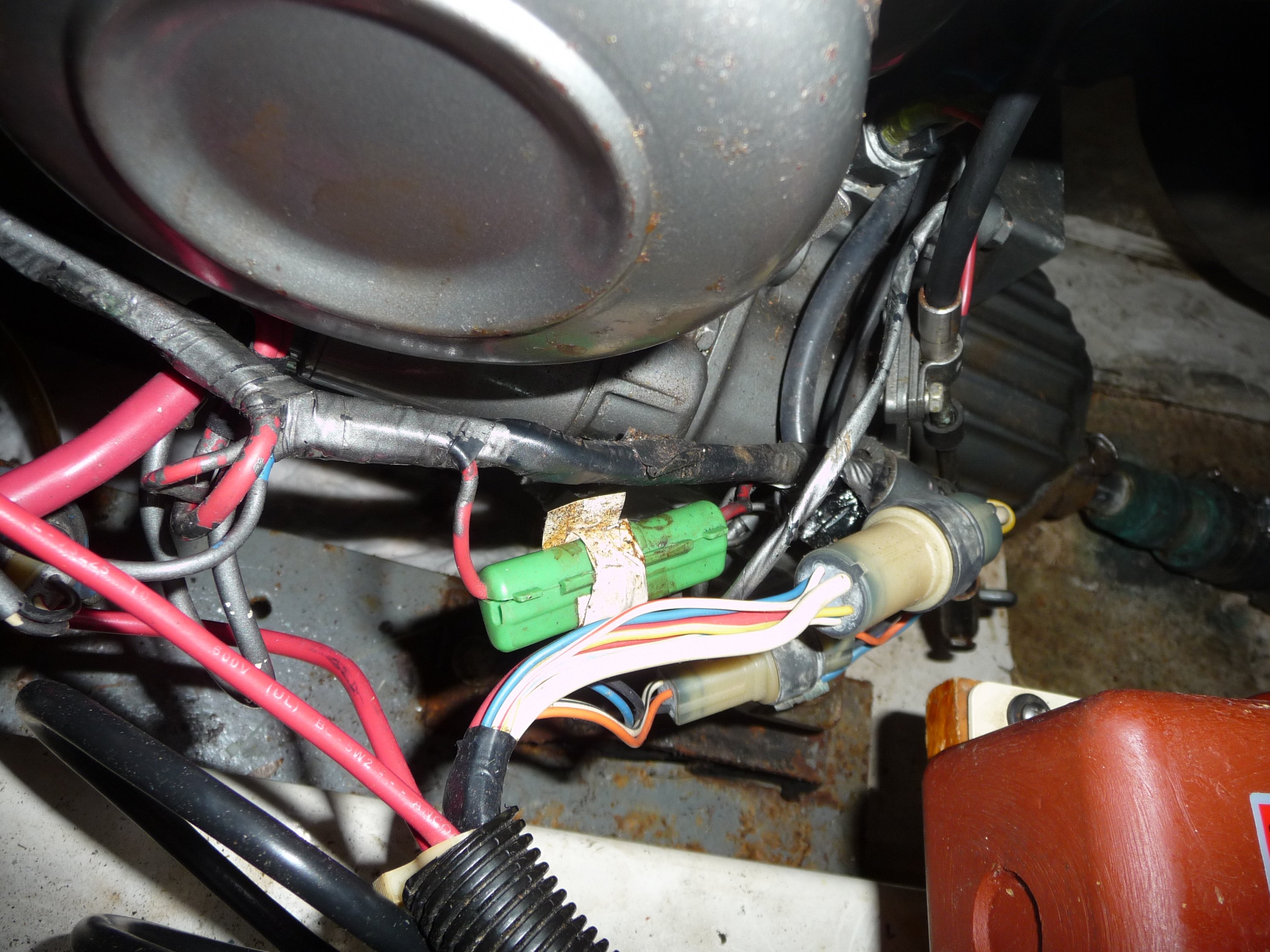

There is a 30 ampere fuse in a little green plastic case on the port side of the engine . This picture shows the holder. It is a pretty shabby holder and its connections are not the best. A little aft and below the air cleaner. I hav also attached the Yanmar panel wiring diagram.
