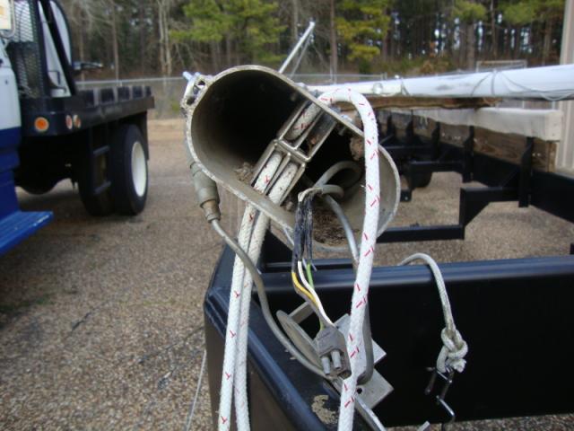

You just never know about what a PO might have done to your boat. I bought my boat a year ago. Since then I have alway wondered why I had no working electrical in my mast.
Now I know why the new steaming/decklight I installed did not work, as well as the masthead light. :D
It looks like the transport company that moved my Catalina to my lake simply clipped the wire harness, then did not bother to hook it back up again. This is a much easier fix than I thought it would be.

I would run complete new wiring in the mast. This way you can be sure it is all OK, and cost is not really a lot. Much better than not knowing if anything else is bad.
