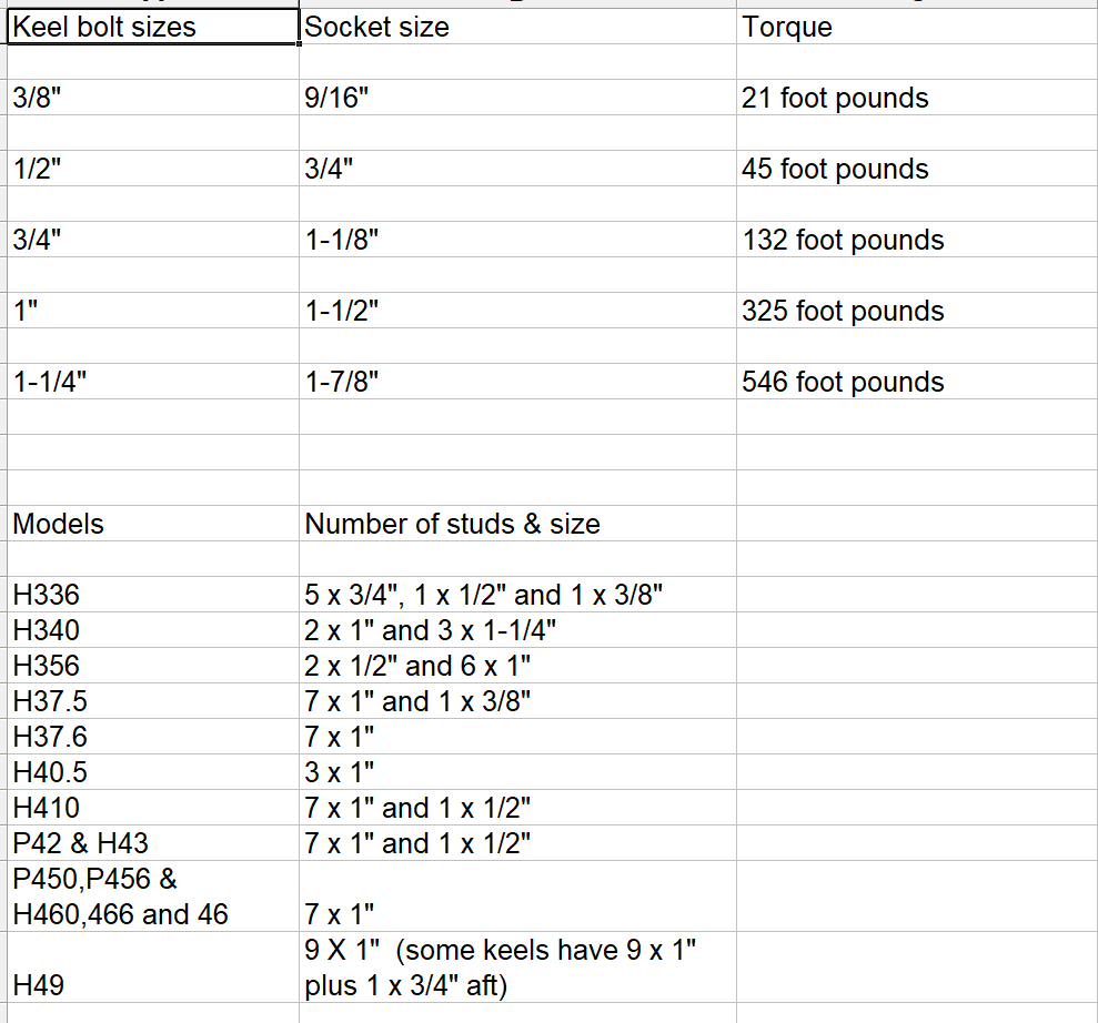

Attached you will find a set of maximum torques from Hunter for their keel bolts. You can aim for these torques but be sure to listen for any sounds of cracking and if so, back off a bit. These show the max. allowable stress on each diameter of stud so they are the same for any make of boat.
This may not be exactly the right approach, but it's definitely better than going without the nuts.
