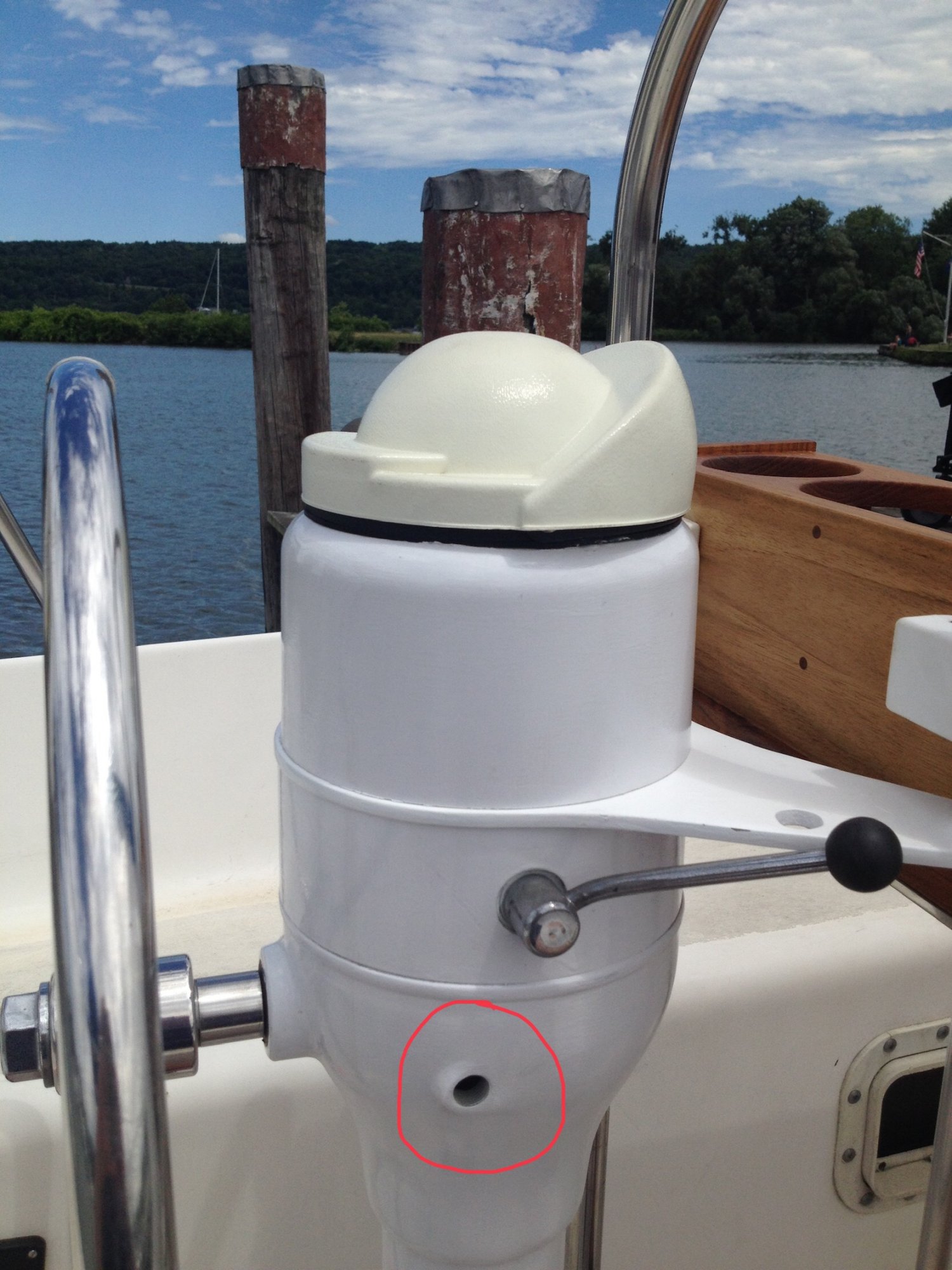

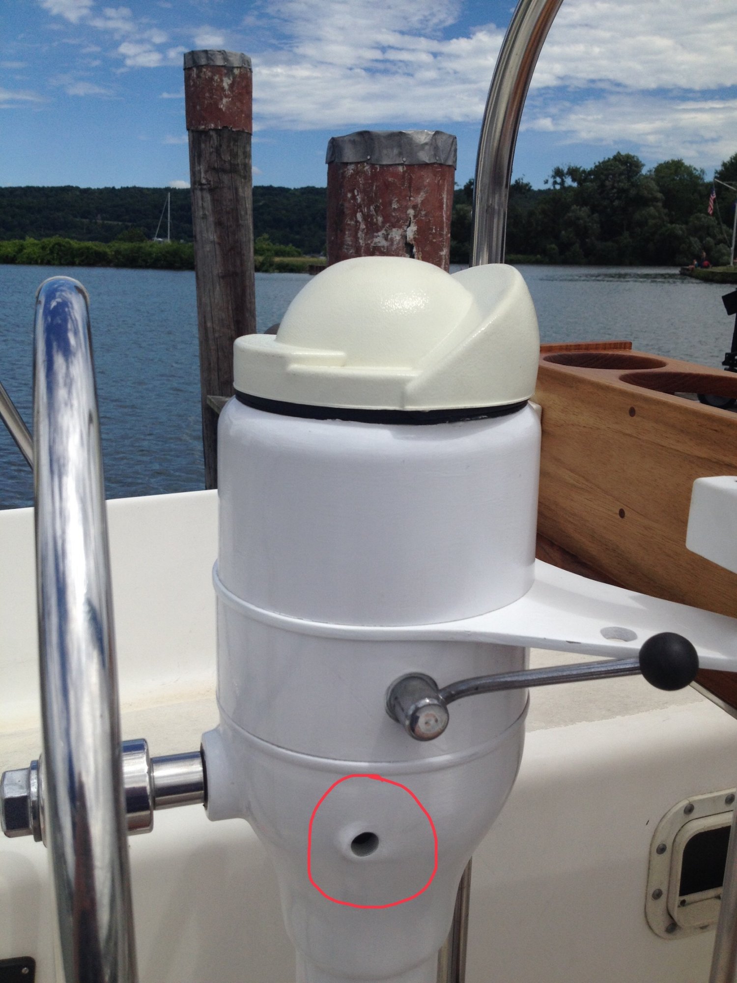

I have a Yacht Specialties pedestal which does not have a brake installed. There is however a threaded hole for an installation if ever needed. I haven’t found the need to do so.

I sail singlehanded and before I had autopilot, I found the wheel brake a great asset when hoisting sails as I could set the boat into the wind under power and keep it there until the main was up without the boat falling off the wind. I bought my 1986 Hunter 28.5 in 91 and it came with the same pedestal as BlowMeAway, only the hole was plugged with a plastic cap.

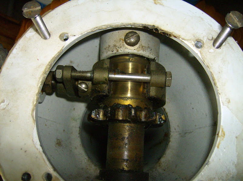

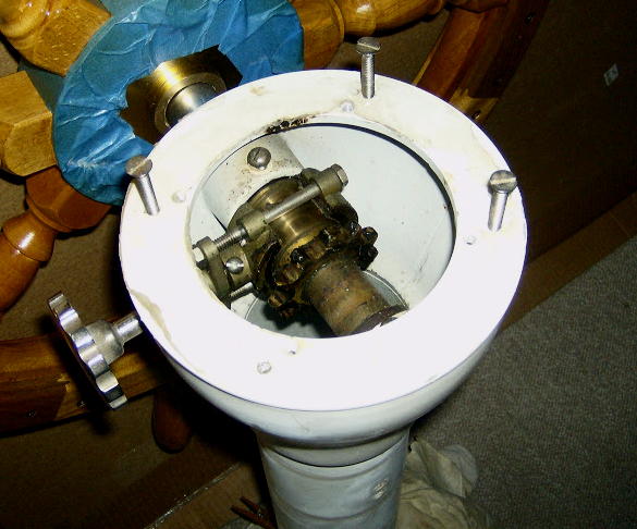

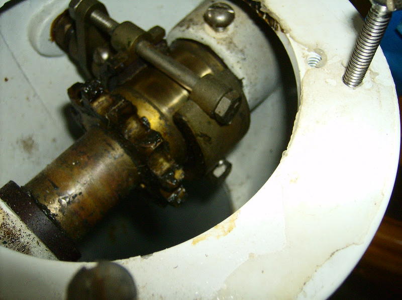

In the fall of 91, I got lucky, & found a true Merriman Yacht Specialties wheel brake. (See pics found on the net). Different design but same principle of squeezing the shaft as the one offered on this site. So if you must have one, check dimensions with Dave and make sure it will fit. Good luck
