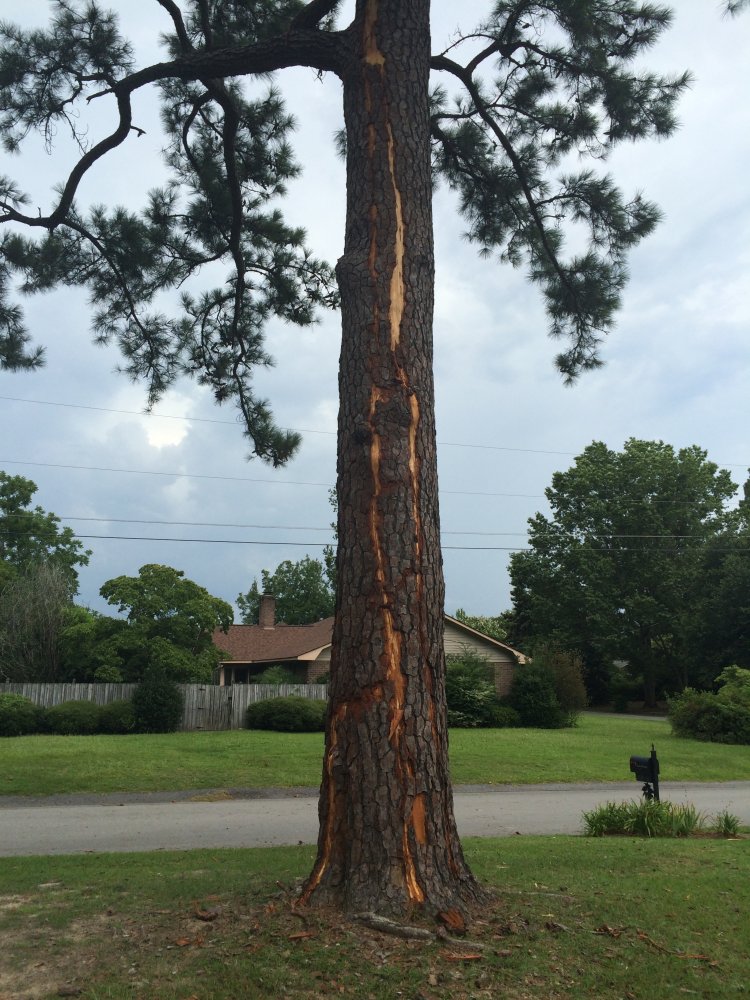

My pine tree seemed to be properly grounded. We found bark on my roof and across the street in 3 neighbors’ yards. I guess my house wiring didn’t act as a faraday cage for my electronics, either.
Now you got it! That tree was better grounded than you house and somewhat shielded your house.
But...
The Voltage of the Ground, at the tree base was probably up to 10,000 volts. That High voltage in the ground will run up your Power meter Grounding wire , making all your House grounds, guessing at least 600Volt in reverse, before it would melt your house Panel wires.
When I hear Lightning hit my house, I ask "How big was the hole in your roof?"
No hole and burned electronics...
Back Voltage

It definitely hit the tree. Weird things happened inside. The breaker for the garage door opener was not just tripped but turned completely off. The circuit board for the opener got fried. Only one nightlight blew out. Every HDMI port in the house was fried. That’s two TVs and the one on my computer. Also the network input on the computer was ruined but it didn’t ruin the computer. The only burn marks we ever saw were on the garage door opener circuit board. All in all I’d say we got pretty lucky.
